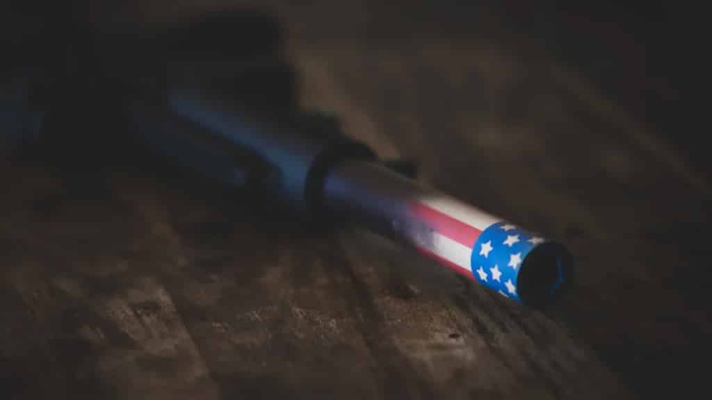

Caveman’s Smoke is a heat-activated coating that can be applied to your suppressors. As the suppressor heats up, the colors and graphics begin to show through.

I first saw the coating at SHOT Show where they had a suppressor that was being heated up with a blow torch. When the flame hit the suppressor, it would change from black to an American Flag.
I had to find out what kind of witchcraft sorcery was going on, so I got in touch with Caveman after the show and sent them a 9mm Suppressor I had from GSL Technologies for my Springfield SAINT Victor 9mm. The goal was to have the suppressor coated by their licensed application shop, Crossed Rifles.
Caveman Smoke coating when heating up
As the Caveman Smoke coating begins to heat up, it starts to change colors. While the graphics can be attractive, they also can serve as a warning that the suppressor is hot.

fully heated Caveman Smoke coating
Fully heated, the Caveman Smoke coating shows a distinct design. The colors and designs were truly impressive.
