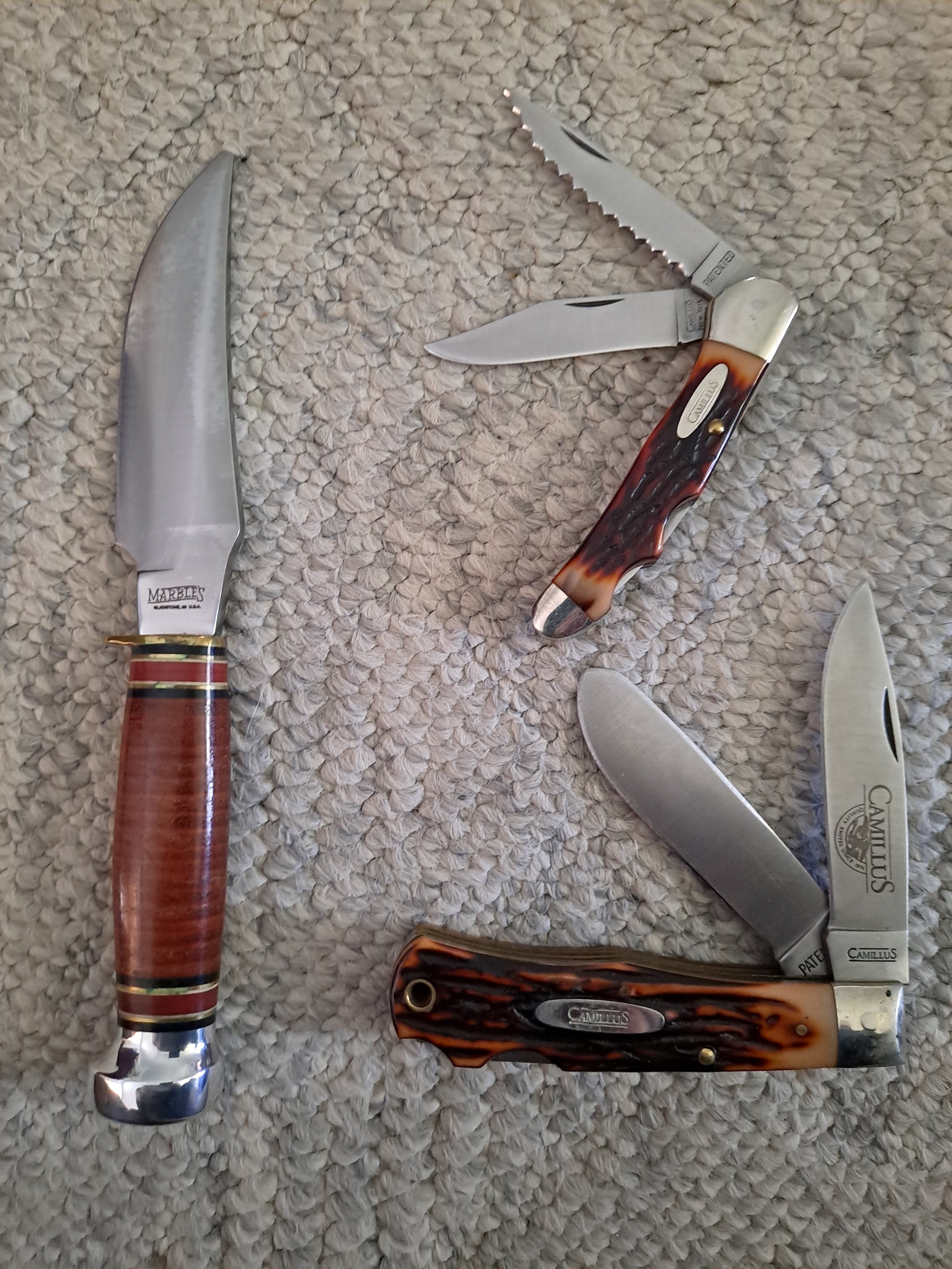

I usually use 20 on mine, it gives a slightly thicker profile for utility use on pocket knives, bushcraft etc. 20 usually on larger chopping blades becuae it severs smaller limbs easier even though it needs sharpening more. 17 is used for things like filet and skinning knives where I want to slice like going thru butter. Things like axes and hatchets are closer to 30.
On something like a trapper lower right for hunting use I will keep the spay blade at 17 and the clip blade at 20.
The Marbles I keep at 20.

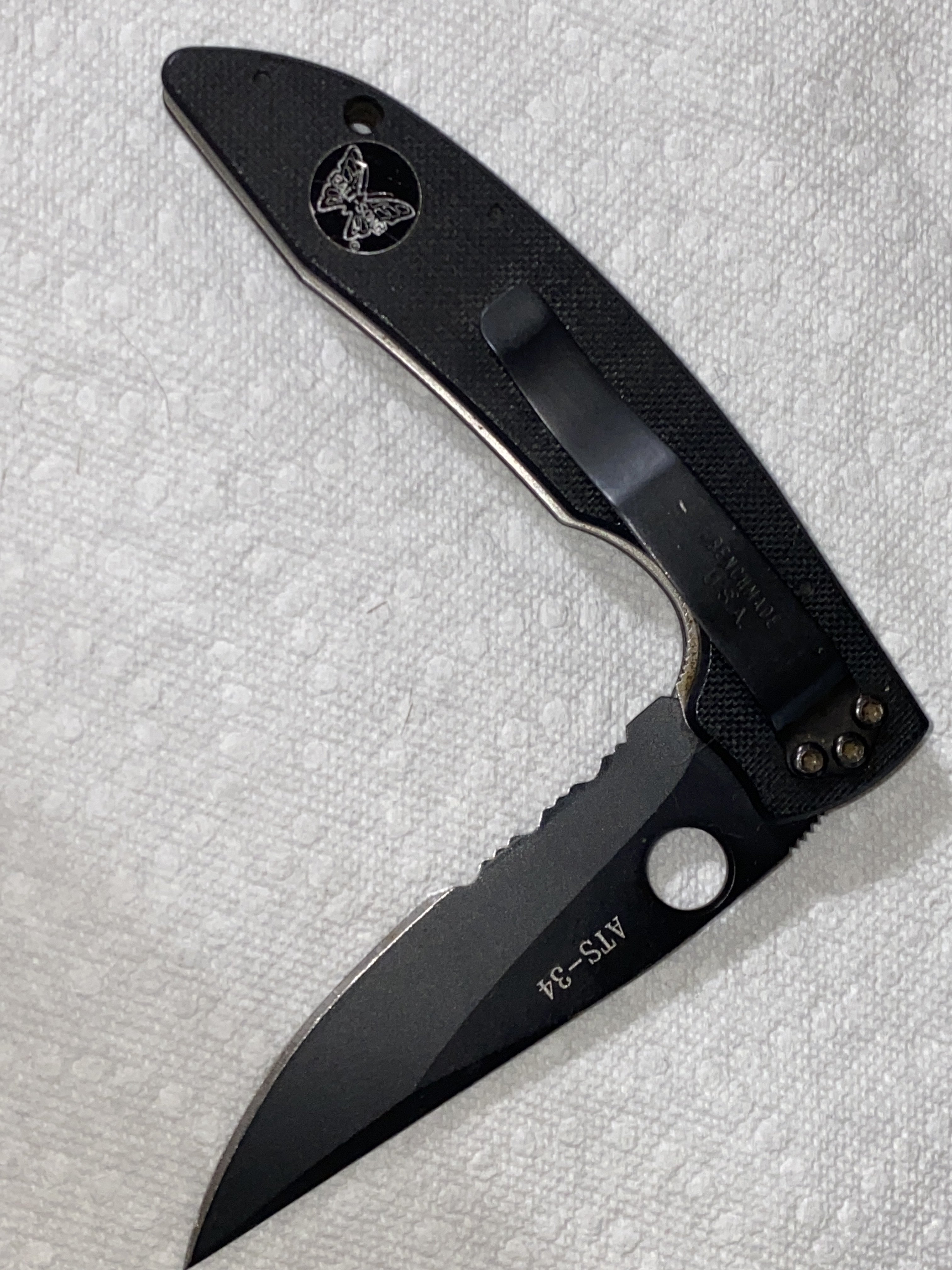

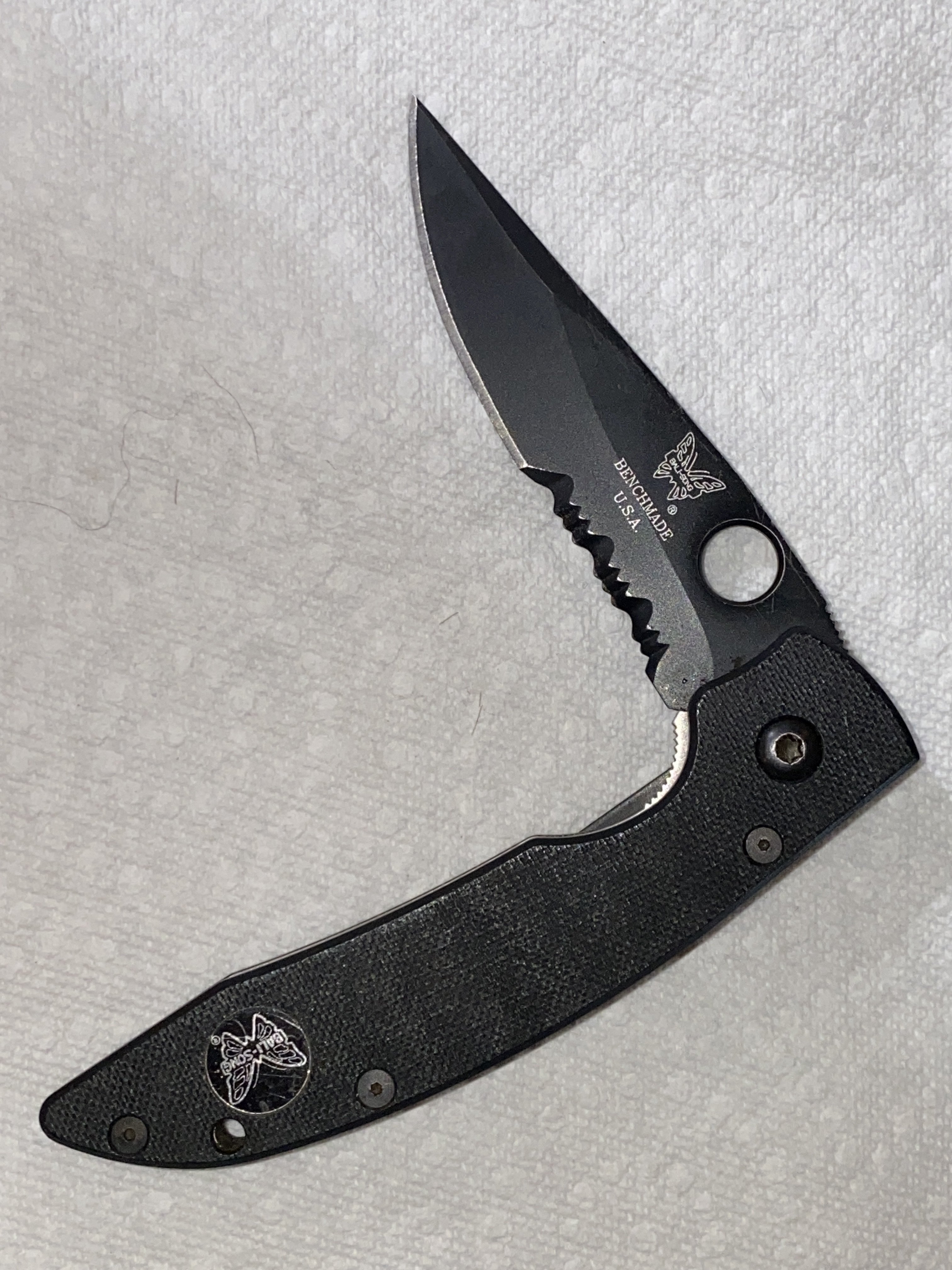

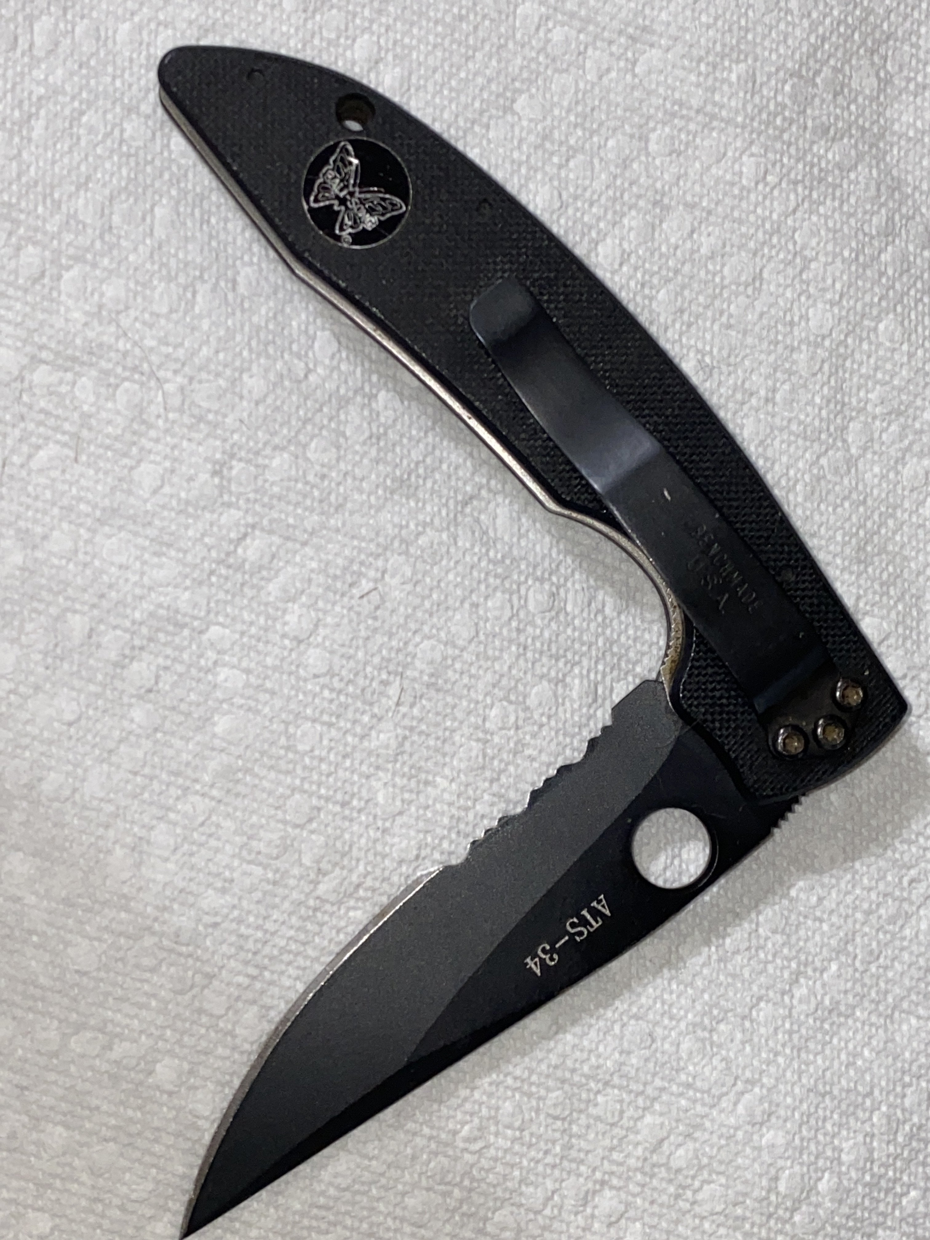

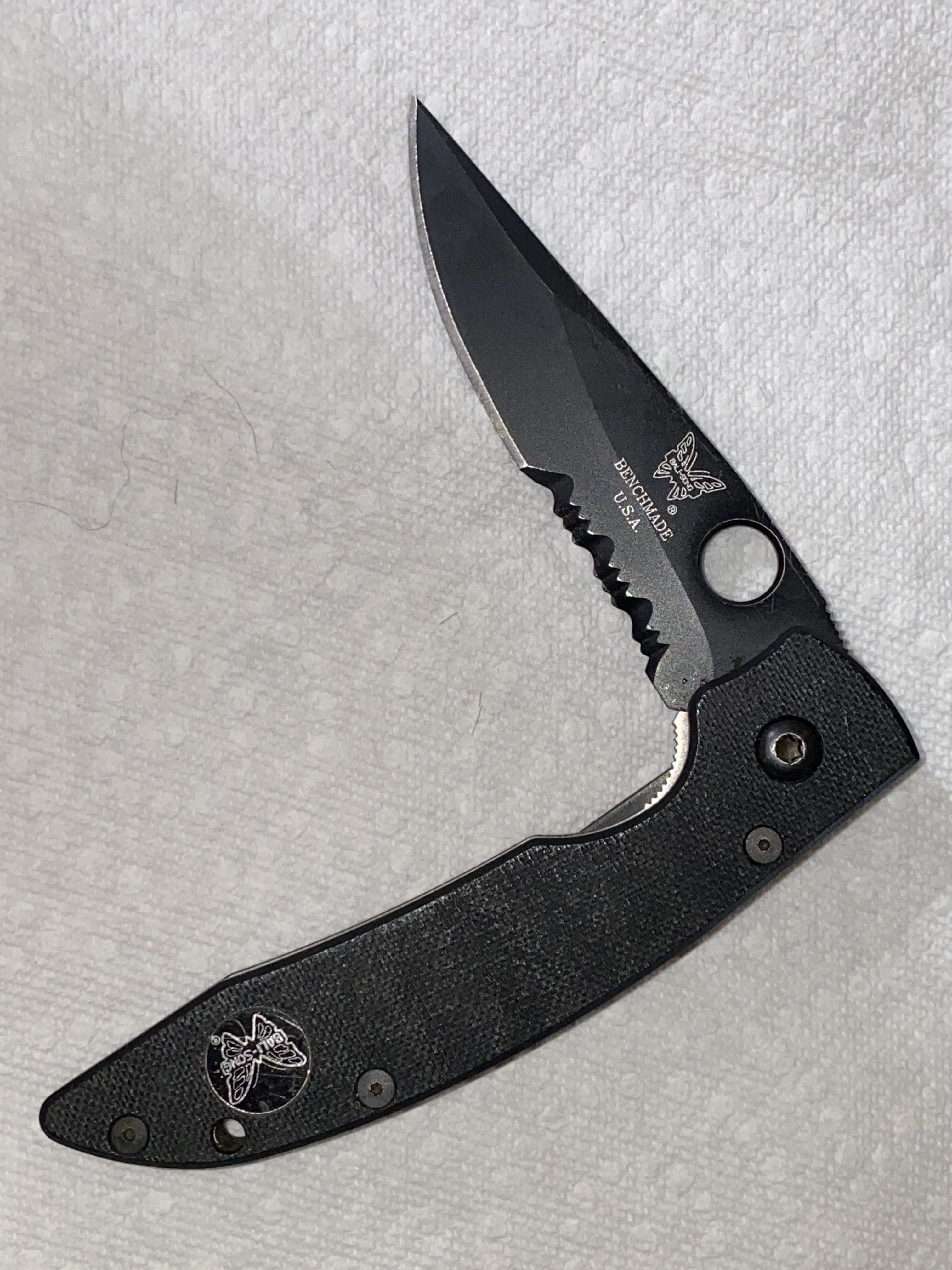

I never carried a knife before, but at my old age, this dog can always learn new tricks. I was asked by two charming damsels if I had a knife at Lowe's as they wanted to inspect the merchandise inside of a package. Alas, I did not then, and missed out on a promising opportunity. That evening, I asked my son (20 yrs in Army EOD - He likes to blow things UP) what, if anything he carried. He said, the Army gives him free Benchmade knives. They have free replacement and sharpening with their lifetime guarantee, which sounded good enough for me. So I bought myself a Barrage with a Tanto/serrated blade for EDC. It is a great knife. Then I got myself a Nimravius and a special leather sheath made especially for it (also has a fire started) for when I go out into the desert. Since then, I have been gifted several various knives, Topps Air marshal, Buck 110 (which belonged to my ex-fiancee's deceased husband. I had to clean it as the brass was turning green. It had been sitting in his nightstand for several years and when I found it, she gave it to me after I cleaned it for her). I also found my old Colonial Boy Scout knife which had been tucked away in a box in a remote part of the garage. surprisingly, the blade was just as sharp and shiny as when I bought it as a kid. Victoronix multi-blade, but also has the most useless cork opener on it. I also bought a few other cheap $5 knives to place in various places around my castle and chariot. They have all come in handy at one time or another...
