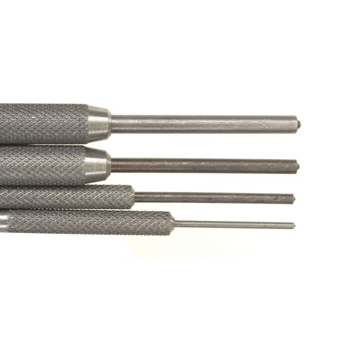

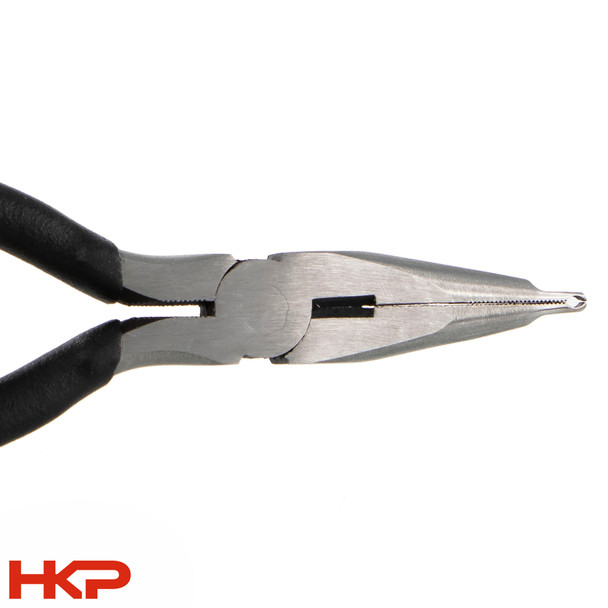

yeah, it was frustrating putting the Beretta trigger spring in..I hear you brother, we’re on the same page. I’ve lost track of the amount of times Ive broken out some obscure tool I bought for my cars and it has just what I needed. I’ve got the HK pliers. What a God send! A full set of roll pin punches are a must these days if you work on pistols.
You’ll definitely need the roll pin punches. I was on my 3rd or 4th one before I got a starter punch. You’ll also want the nifty little tool for the bolt catch pin. You don’t need it but it’s nice and will help keep you from scratching the lower. Be careful putting the trigger guard on. You’ll want a bench block or to make a block that only allows force on the pins and not the rest of the guard. Also rather than regular mil spec guard I would buy an enhanced guard. It’s bigger for wearing gloves. The plastic Magpuls are cheap but I don’t like them. Get an aluminum one.i am waiting on parts to put together my first ar lower and am learning about all the right tools. i just learned about roll pin starter punches and roll pin punches vs regular ones. right tool for the job cuts down on the amount of swearing during a project.![]()
Thanks for the advice. The roll pin punches i ordered come with the bolt catch pin tools. I did see that about installing the trigger guard. Some people use a c-clamp to squeeze it into place, which i though was interesting.You’ll definitely need the roll pin punches. I was on my 3rd or 4th one before I got a starter punch. You’ll also want the nifty little tool for the bolt catch pin. You don’t need it but it’s nice and will help keep you from scratching the lower. Be careful putting the trigger guard on. You’ll want a bench block or to make a block that only allows force on the pins and not the rest of the guard. Also rather than regular mil spec guard I would buy an enhanced guard. It’s bigger for wearing gloves. The plastic Magpuls are cheap but I don’t like them. Get an aluminum one.

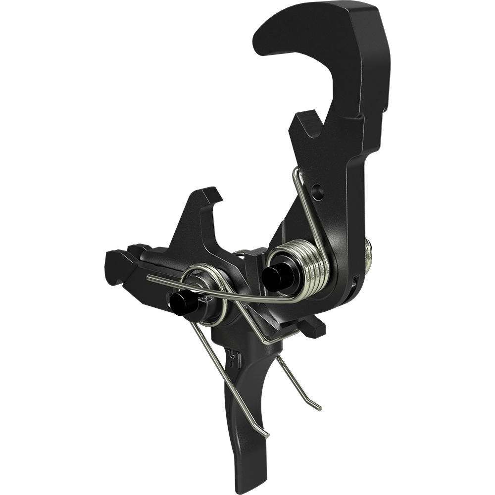

I’m not sure what FCG, if any, comes with the lower parts kit you ordered, but unless it’s a PSA EPT, I would stick it in a drawer and buy a nicer trigger. I like Hiperfire EDT. This one.
EDTDM – HIPERFIRE®

I enjoy building them. The EPT trigger is very nice. Not as light as the Hiperfire but just as smooth. No take up, short, crisp reset. I like it a lot.Thanks for the advice. The roll pin punches i ordered come with the bolt catch pin tools. I did see that about installing the trigger guard. Some people use a c-clamp to squeeze it into place, which i though was interesting.
The lower is a PSA blem for $40. I going totally "budget AR" here. The transfer fee is as much as the lower.
The lower parts kit, also from PSA, has the EPT trigger and ambi safety selector (i shoot rifles left handed). On your advice I put the hyperfire designated marksman into my Ruger AR556 and I really like it.
