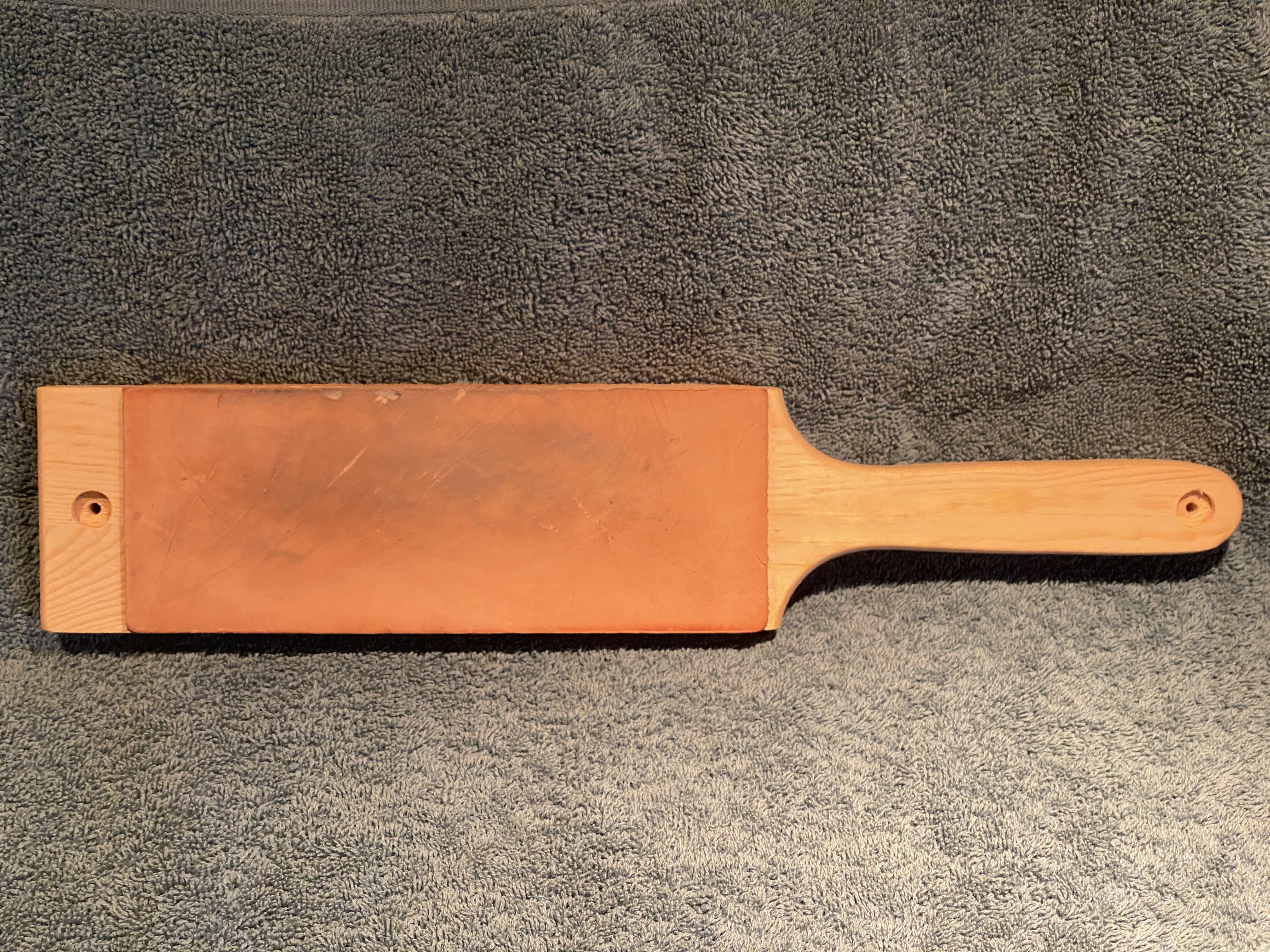

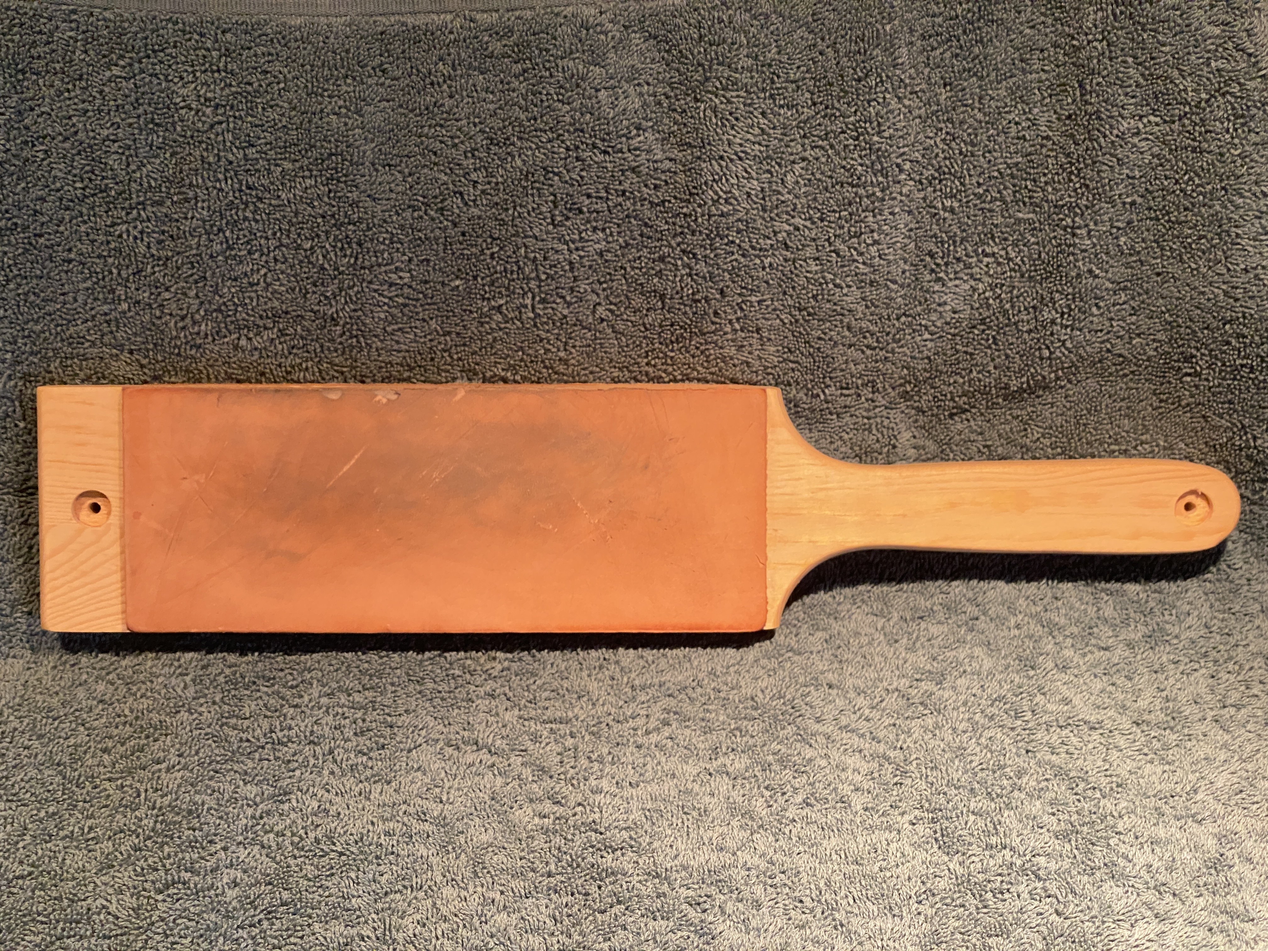

Sharpening is removing metal to create an edge. Honing is realigning an existing edge to improve function. Stropping is poilishing out slight imperfections in the knife edge.
If you use a hone, ceramic, steel etc and a strop you will go a long time between sharpening, with most decent steels that are well treated.
