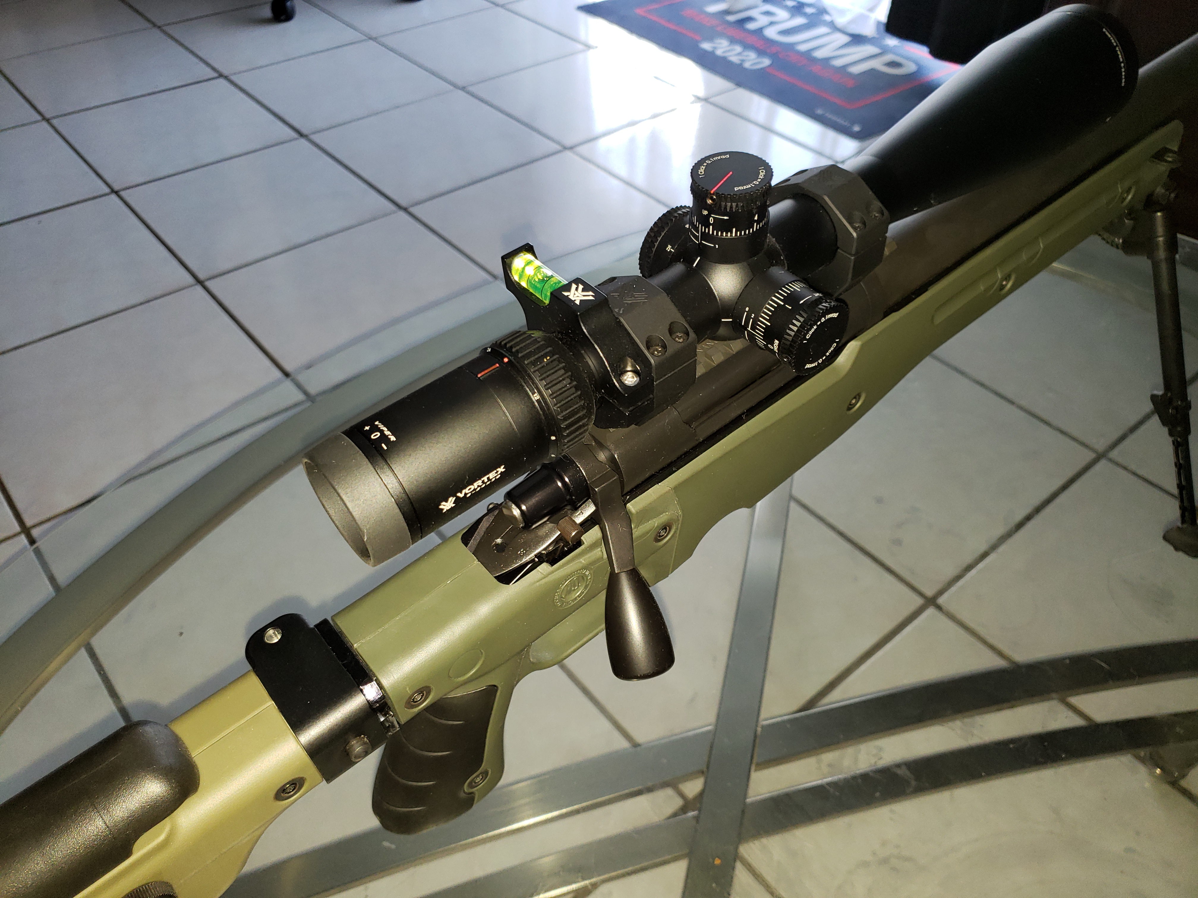

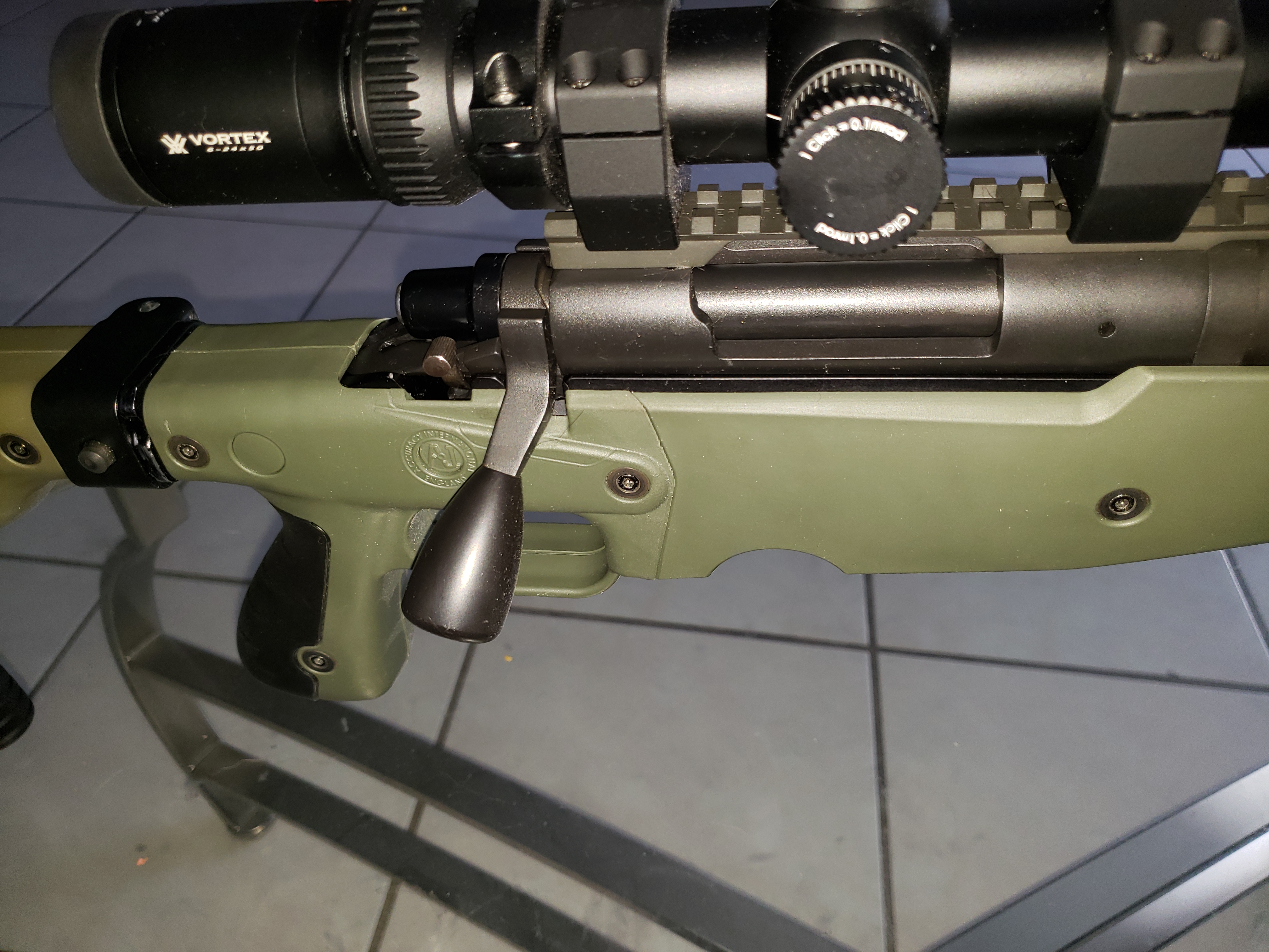

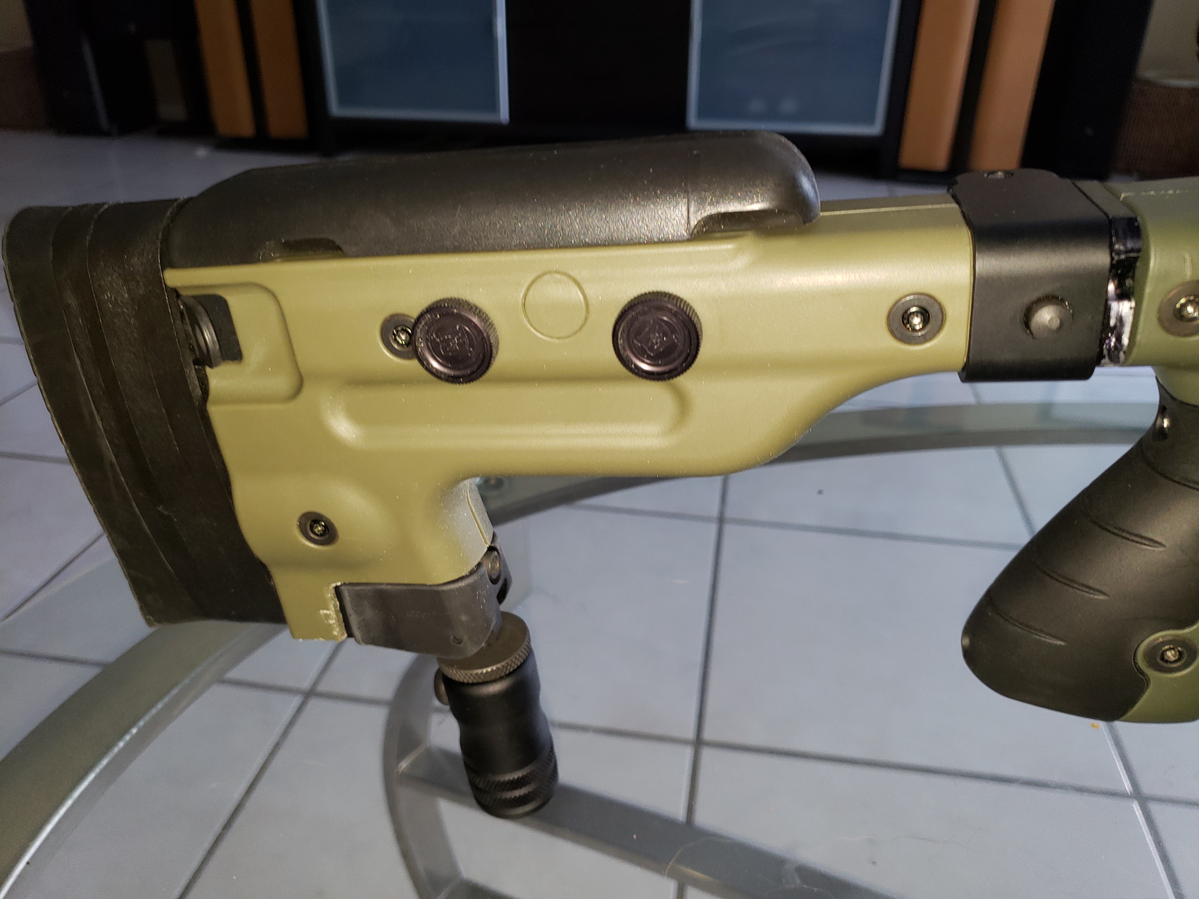

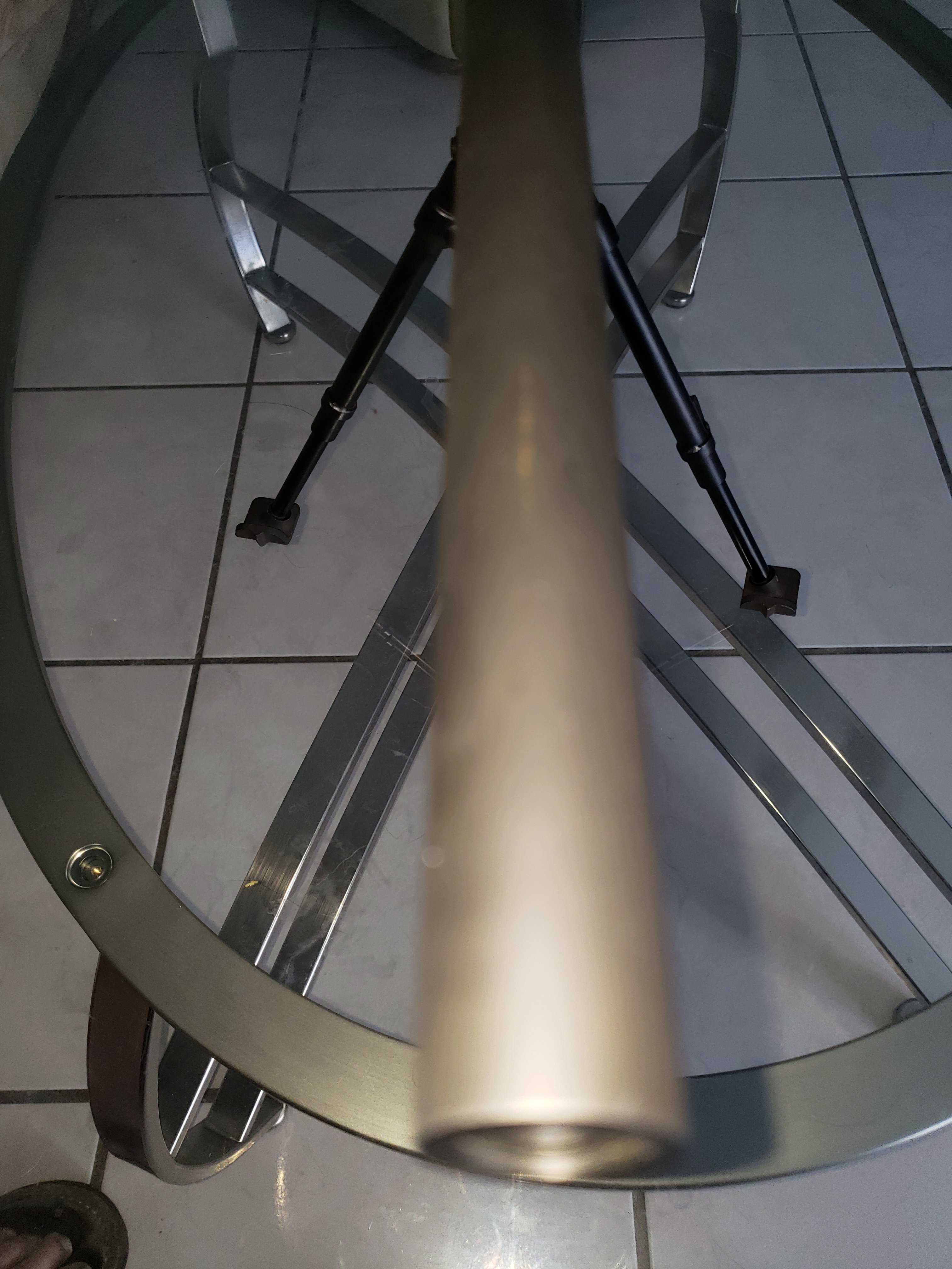

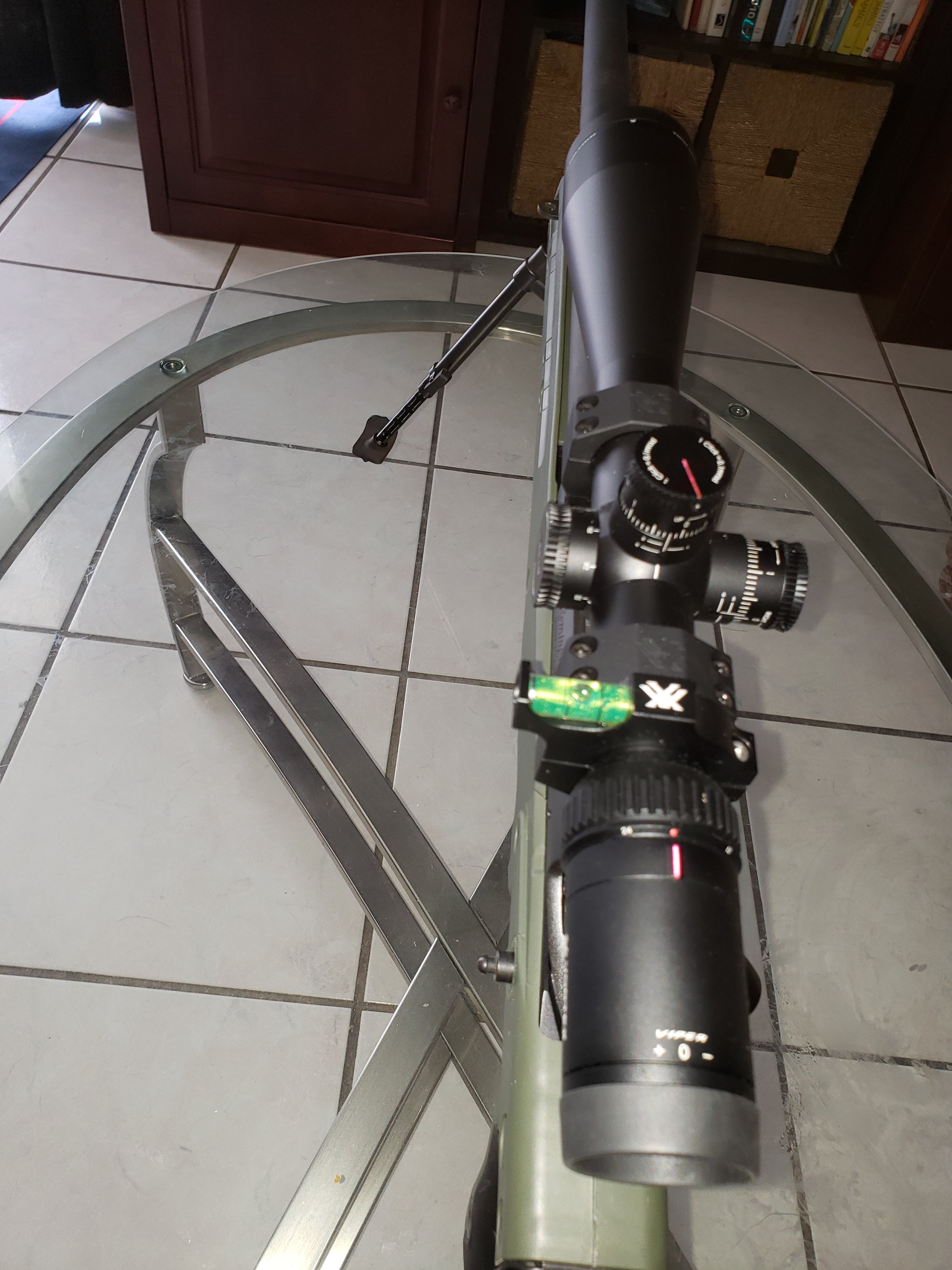

Practiced all day with the AI 308. Got the groups tighter using the 168gr over 150gr bullets. That little 1" red dot is hard to see at 600yds. I know I need to post the picture of the AI 308.
Started with a Accuracy International chassis, build on a short action Remington 700. The barrel is a Kreiger 1:11 25.5 long with 308 match. Palma 1995 spec. Match grade trigger adjusted to 3.0lbs.

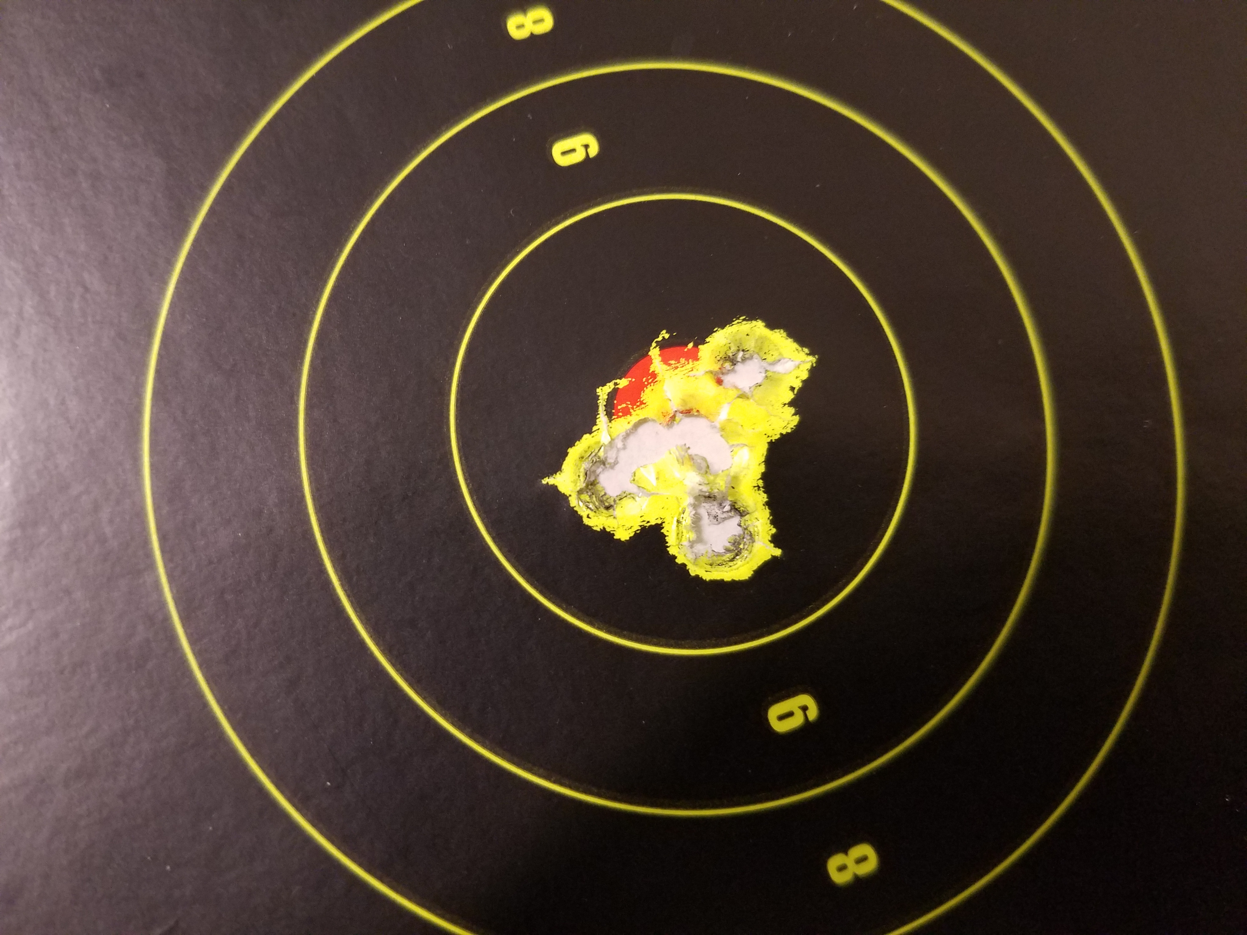

No one likes my rifle :cry: Well less then a week before the event (this Sunday) they change the rules. Now its 500yds from 600yds, members started complaining about the distances and using a part of the range with no roof. So it was change this morning to 500yds. That's ok because I been practicing at 500yds for most the time. There only one slot for 600yds and 10 for 500yds and the 500yd is modern with all the goodies. Here's a picture of mag load from the 308 at 500yds.

Missed the post .
nice shooting Tex !
get some hogs after the shoot 😁
Whoa, nice shooting!
the only part on that rifle that's is Remington 700 is the receiver.
  1. Terminus complete bolt 4340 chrome moly with 3 lugs
  2. Terminus complete firing pin with all spring
  3. Dual pin recoil lug mounting point for the Accuracy International chassis
  4. Terminus firing pin with spring.
