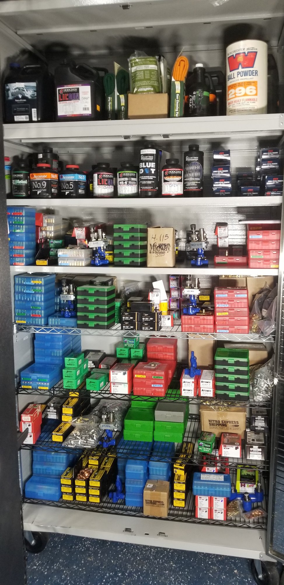

I decap and size using my 40cal carbide die. Every once in awhile I'll run the cases through the
full length sizing die I have. Before I size the neck I'll spray lube the cases.
I have a lot of steps in loading mine but it seems to work very well
Just a few supplies.
yeah looks like me, only I'm a little more spread out!! :ROFLMAO:
