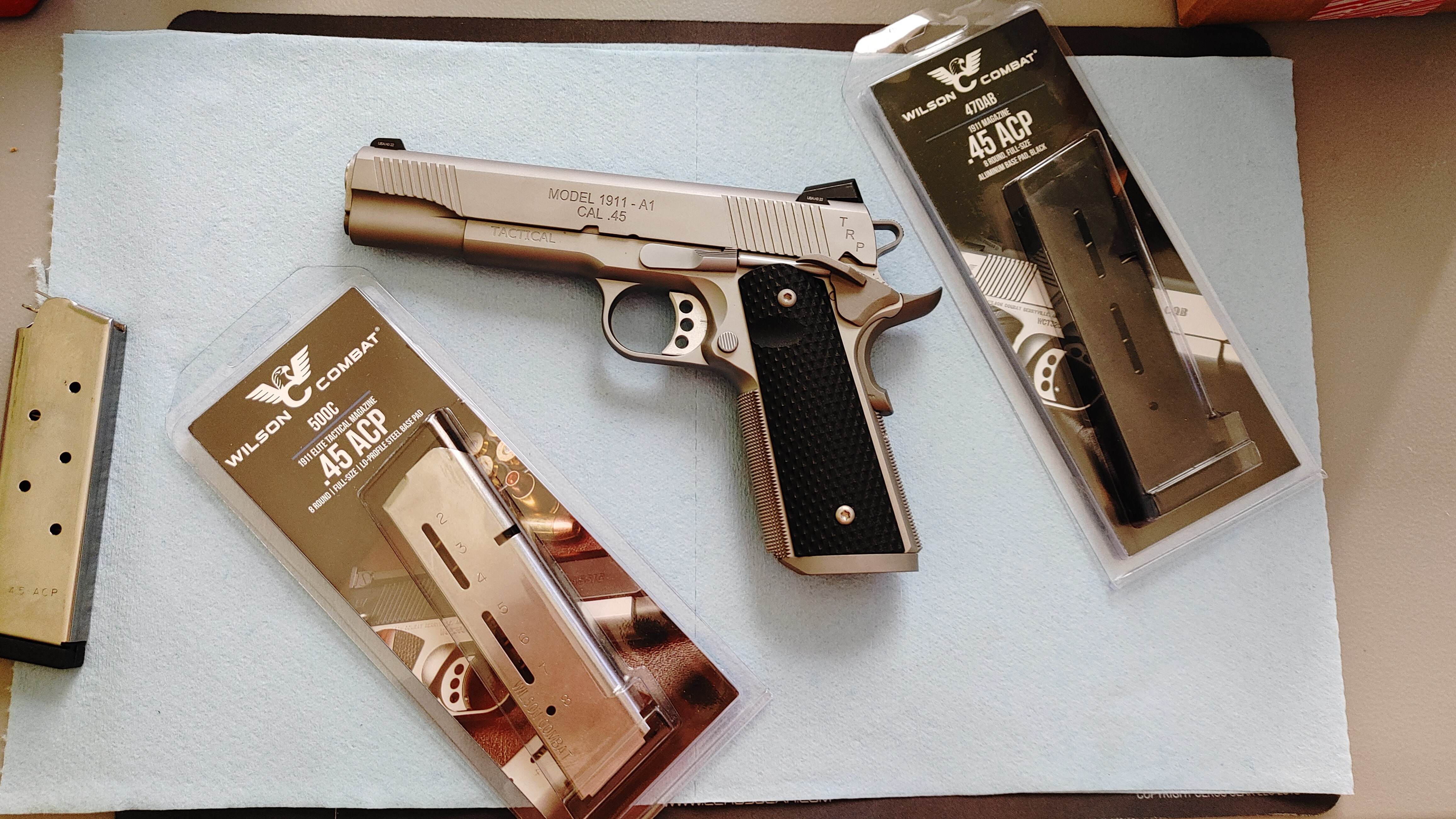

Hello Armory family. I just purchased the 1911 TRP. I had heard a lot about the Wilson Combat mags, and pre bought several of them. The SA mags that came with the pistol insert very smoothly. The WC mags feel like they hit the mag release and I either have to push in on the release or smack it Really hard to seat it. Is this OK? The TRP (mine is the SS finish) is a beautiful pistol and I definately do Not want to damage it in any way.

Wilson mags are as good as it gets. They may give you a tighter fit. Are you seening any undue wear on the magazine? I would first try getting some lube into the mag release mechanism to see if it eases.
Wilson will tell you their magazines can be stiff when new. See their info sheet. If you are still concerned give Wilson a call, they have a good customer service rep.

I don't know enough about what Rich P is experiencing so I cannot rule out a defect somewhere but more than likely a new gun and new mags are going to give some resistance until they wear in a bit.

Old Me, thanks for the comment. Yeah, WC mags have quite the reputation. I have a couple of 9mm, but this is my first 1911 (45acp). I've shot them before at the range, but always with the range mags. The first time I shoved the WC mag into my TRP when I first took it home I was just a little surprised to feel the "wall".

Eight WC mags for my .45 1911 Range Officer and all are great, but the spring is really stiff when new. Fill the mags and let them sit for two days if you aren’t able to shoot yet, which will give you a bit of a break-in of sorts. The WC’s do need a little extra whack to insert at first, but part of that reason might be the stiffer springs. They should definitely out last the SA cartridges as far as spring life. I have one SA remaining and I use it for practicing with snap caps, lol. I can load the SA by hand easily, but the WC is tougher, so I use a loader for those. Especially new ones when you get past 3-4 cartridges. But when that last round needs to chamber correctly every time, the WCs are your best bet.

Try loading you WC mags 1 round short for a while. They are known for being stiff when new, but as you can see everyone - including myself - swear by them. You do not have dud mags. I assume this is your first 1911. As you have the stainless finish look up idiot scratch. If you put one on your gun ding me, it can be removed. Ask me how I know…
