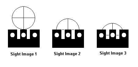

I “may” someday get a red dot. The pistol has the suppressor height sights currently. They force me to aim so high that it completely covers the target. Does anyone know for sure what sights are compatible with this pistol? I’d prefer to have iron sights for now. Something like a straight eight and much lower than current sights.

In the above examples, XD’s are regulated to use the “combat sight picture”, or #3; the front dot should be on your desired POI.
Thanks for replies. I am aiming per #3 and hitting accurately. I would just prefer to change sights so that I could aim more like picture #1. That's why I asked if anyone knows what sights are compatible. Are all XD/XDM sight slots the same? So I can purchase anything that says it's compatible with an XD?

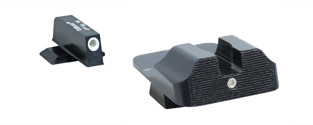

They use SIG dovetails, so most sights that work on Sigs will work on yours.
Quick follow up question.... I'm liking the Warren Tactical 2 lamp sights. The ones for the XDM have a .245 front sight. But they also have one for an XDE/s that is .215 high. If the .215 high sights will actually fit on my pistol, do you think I'm pushing my luck to go with the shorter sight? Links to each: https://warrentactical.com/product/...set-1-lamp-rear-sight-and-1-lamp-front-sight/
It will make a difference, the .245 vs the .215. The .215 may and should work, for what your wanting to do that would be the choice for me. Dawson recommends a .225 front sight for the XDM.
