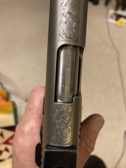

Well, because of the weight of a 1911, I got the notion of building a 1911 in a 40S&W in stead of a 9mm. As a single stack, it’s my favorite out doing a 45 ACP and 9mm for my purposes. Try it but use a ramped barrel. I also have the same pistol in 357Sig with a barrel swap!
