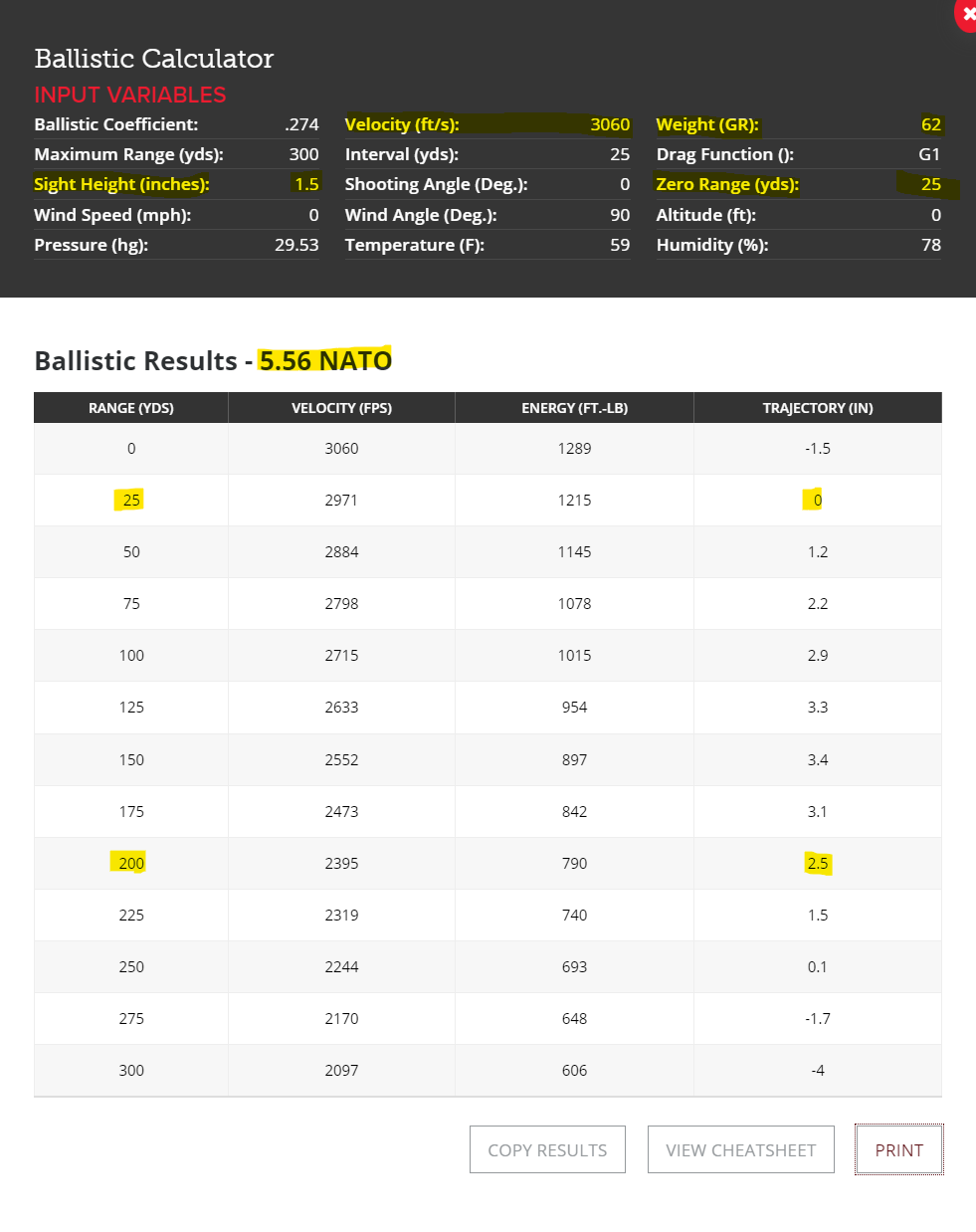

What a timely article - my AR-556 w/Primary Arms red dot was zeroed at 25 yards. We went to the range yesterday and I was WAY high at 100 yards (and high at 50 as well). The gentleman we were with who has much more long gun experience than us recommended re-zeroing to 50 yards. Did that - worked a charm! Still need a lot of practice - especially since I'm math-challenged. But based on initial results, the 50-yard zero is going to be much better for us... at least for nowHello all, here is today's article posted on TheArmoryLife.com. It is titled Is Your Carbine’s Zero Wrong? and can be found at https://www.thearmorylife.com/is-your-carbines-zero-wrong/.
Mike, I have to ask where you got your information regarding a 25 yard zero being 9" high at 200 yards. I've combat zeroed my M4 dozens of times in different AOR's with other 5.56x45 wielding guys from every branch of the US military and a few branches of a few other countries. Your statement and assumption is just simply not true. The trajectory peaks at approximately 3.5" high at approximately 150 yards.Hello all, here is today's article posted on TheArmoryLife.com. It is titled Is Your Carbine’s Zero Wrong? and can be found at https://www.thearmorylife.com/is-your-carbines-zero-wrong/.

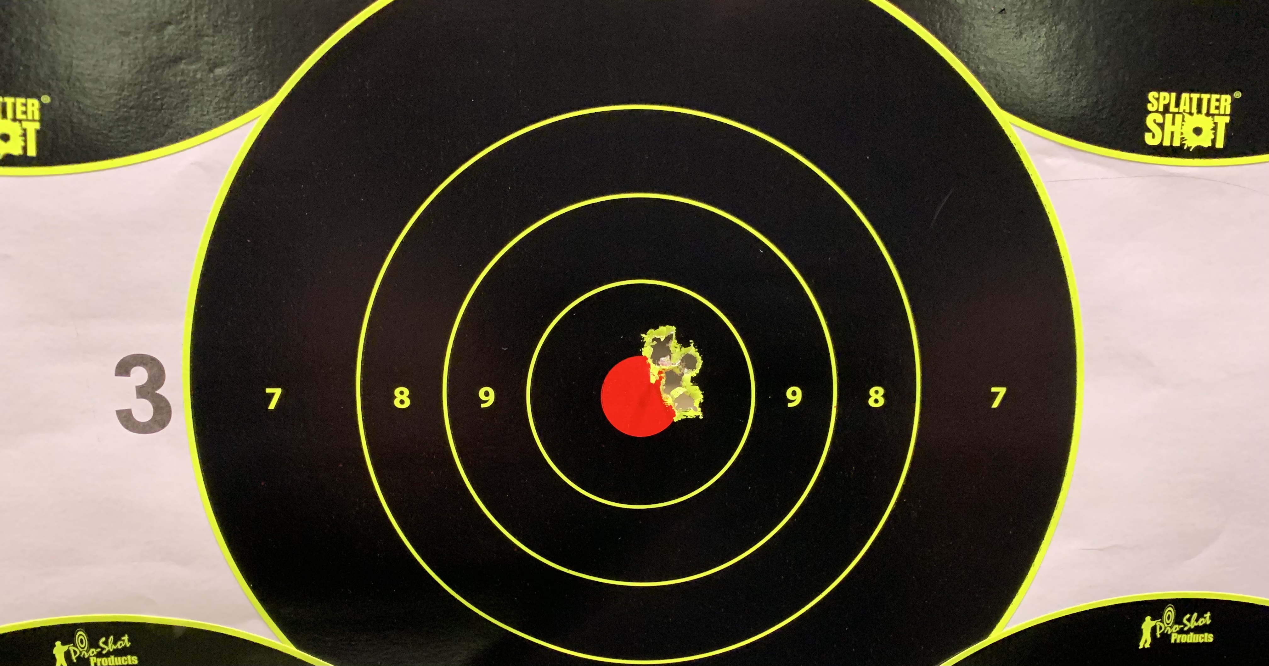

Oh that was so long ago, although I really like shooting a .308 and that Savage was a great shooting gun it was flawed with poor timing during the reload process causing the lugs of the bolt to contact the lugs of the camber and subsequently damaging the bolt lugs. I had returned the AR10 once to savage and they replaced the bolt not the BCG, after receiving the rifle back and 10 rounds later the bolt lugs started showing the same damage so I traded it for my now flawless shooting M1A .308I’ve always found zero at 100 yards.
It’s what works for me. This was my Savage AR10 .308 at 100 yards the last time I went shooting. View attachment 11186
5 shots.
