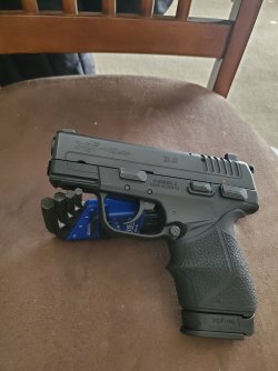

I've had mine for almost a year, mine is the 3.3 inch and have fired 2,000 rds through it with no malfunction great little gun. I've added a set of Hogue Grips and Trijicon HD night sights. It's easy to take down and clean. Wish Springfield or another company would develop a short reset trigger kit and a straight trigger for it. Like I've got on my Sig P220, makes that first shot DA a lot easier
