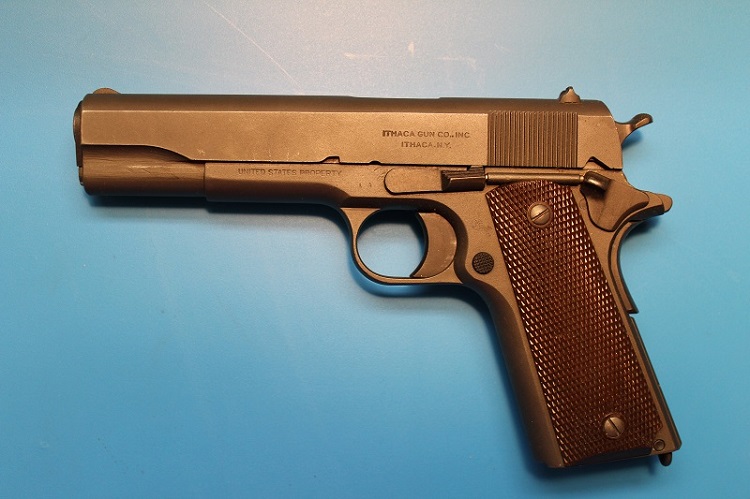

This is a DMC purchase from the late 50's early 60's. It was rebuilt at Augusta Arsenal from a Colt WWI era frame and a WWII slide from Ithaca. All the small parts appear to be new as well as the High Standard barrel. I'm sure many rebuilt 1911's were used during the Korean War.
