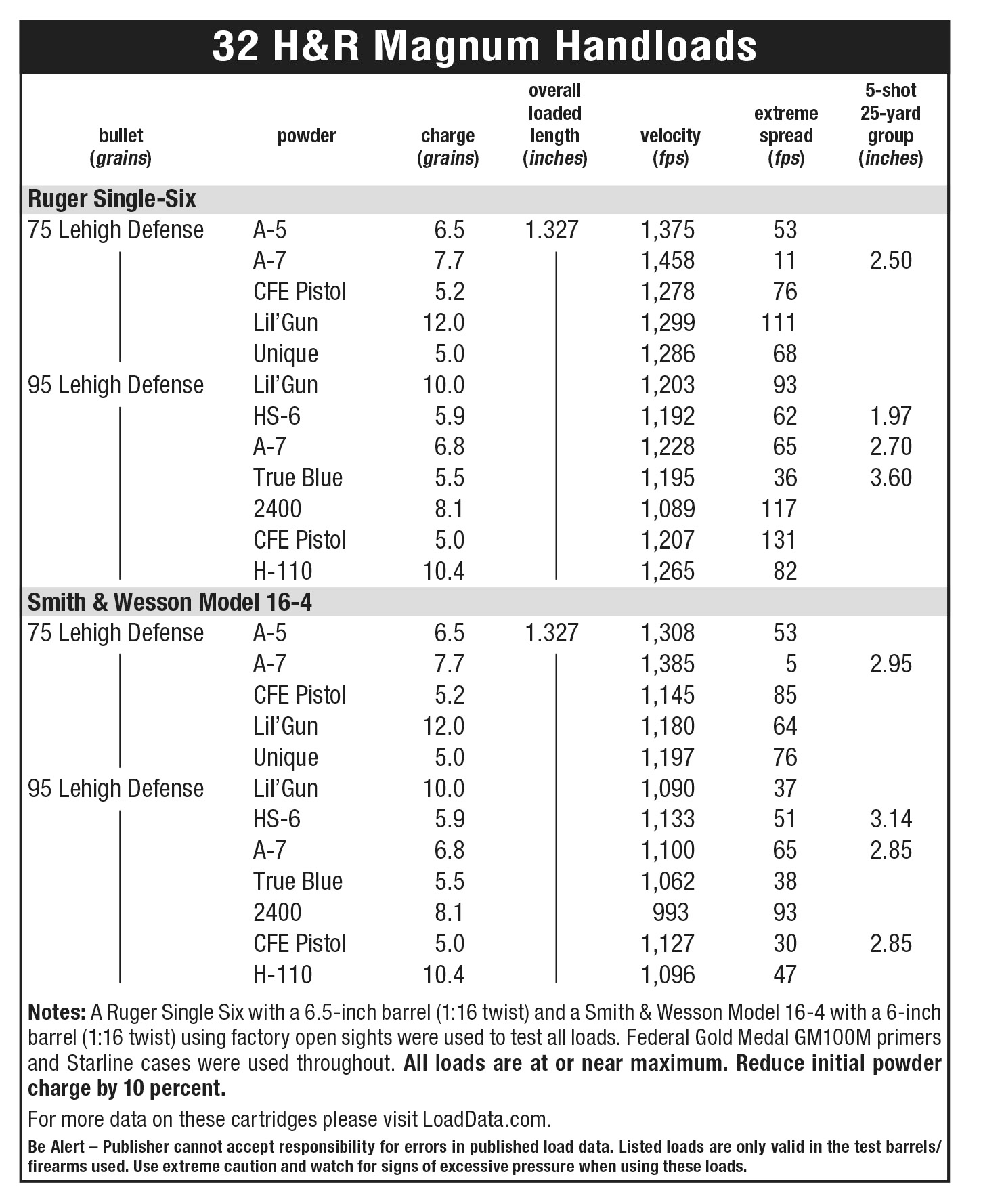

A Deadly Load for the 32 H&R Magnum
The 32 H&R Magnum was introduced in 1984 by Federal Cartridge, at the behest of Harrington & Richardson, a venerable company that supplied revolvers to the economy end of the market. It’s nothing more than the 32 S&W Long lengthened by a seventh of an inch.
the 32 H&R was a disappointment to many – including, apparently, Federal, because in 2008, it introduced the 327 Federal Magnum. This is the 32 H&R case lengthened another eighth of an inch (.125 inch).

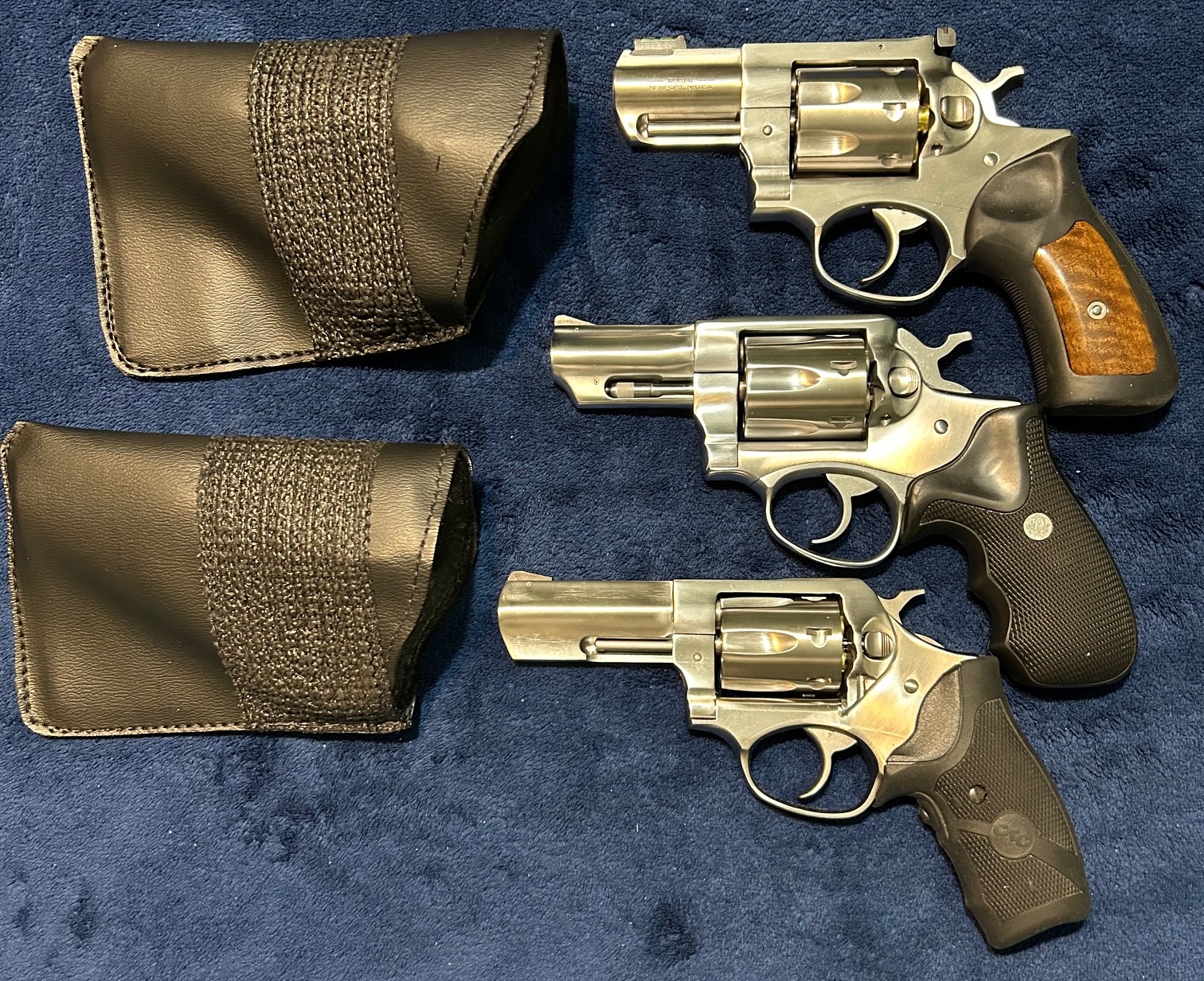

What makes the 32 H&R shine is small J frame revolvers. You can stuff 32 S&W long in them with a 6th round. Not much recoil more than a 22 Mag and with full target wadcutters will cut a hole and get to the goods. And being Centerfire it will have more reliable ignition and can have a better trigger than a 22 Rimfire that has to have a heavier trigger for reliable Ignis when talking Wheelguns.
As far as 327 mag that also has a place and works better in a steel frame like Ruger SP101 the new 3” Lipseys makes a perfect trail gun stuff it with deep penetration 327 mags for whatever and then 32 H&R and 32 S&W Long for anything else.
