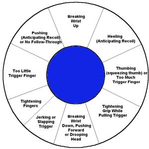

As stated above, try it benched and/or left hand only; also, have a couple other people who you know are good pistol shots try it.
If it’s always left, it’s the sights; if not...it’s the shooter.
All the pistols I have owned with fixed sights, I never had to adjust the front sight, rear sight yea, several times. Personally, I would try shooting it again from a rest, I used to have a bad habit of pulling the gun to the right when I shot, basically, jerking the trigger, it’s easier to do this on a small compact gun then a full size one, but I still did that on full size pistols. Took me some time to break that bad habit. Good luck on your endeavors.

All this is relevant only after shooting off a bench/bag, or someone else shooting it for you to ensure it is in fact the gun and not the shooter. And that's not a knock on the shooter...... we've all been there and done that at least once (some of us more than once) in our lives.
