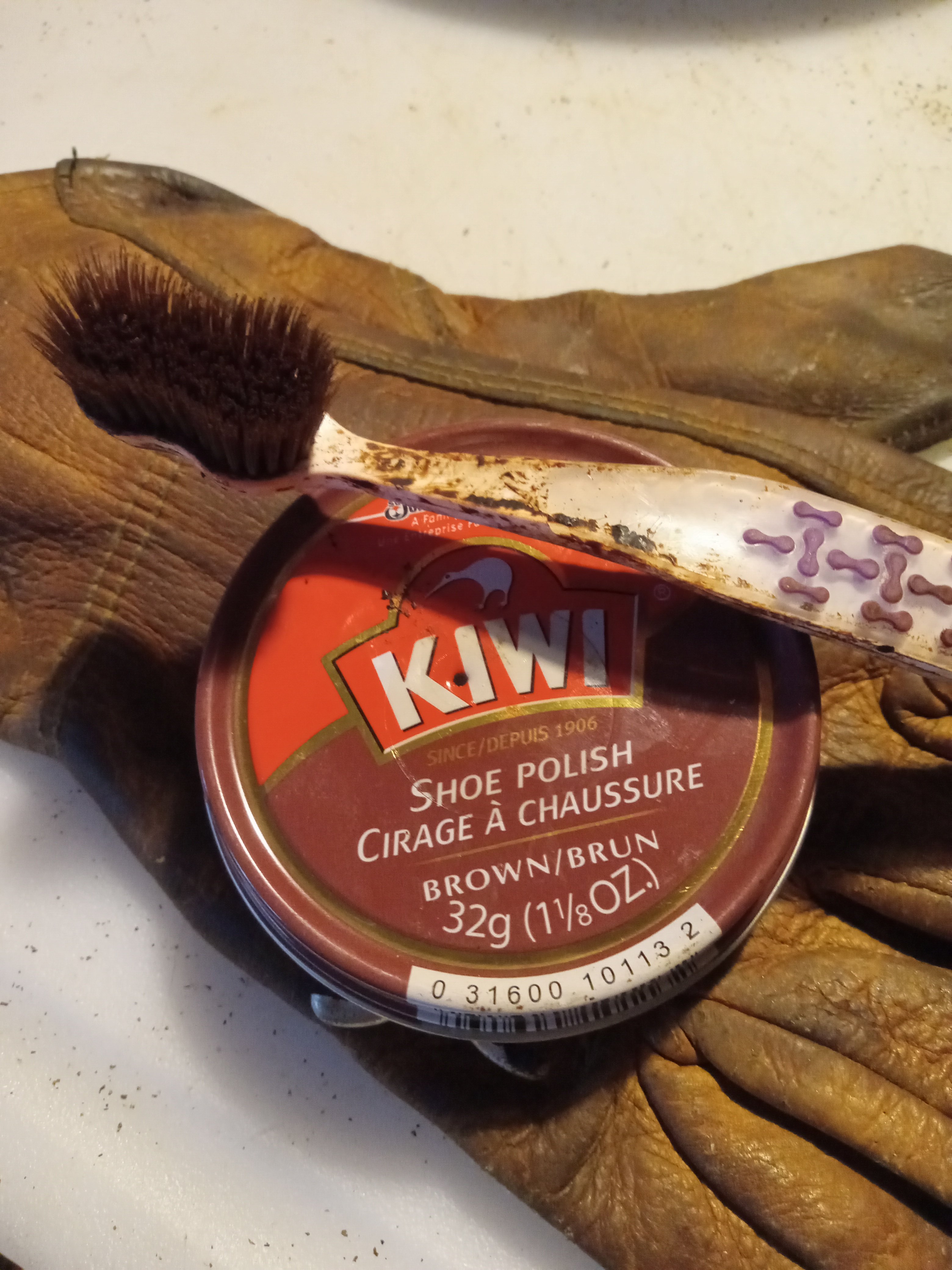

With a soft bristled tooth brush and a tin of "BROWN" Kiwi shoe polish.
Brush shoe polish on antlers liberally starting at the bases. Using less and less polish as you get the further twords the tips of the main beams and all other points. You may want to put on some thin latex shop gloves and work the polish by hand back down from the tips to give the Antlers a ntural color fade.

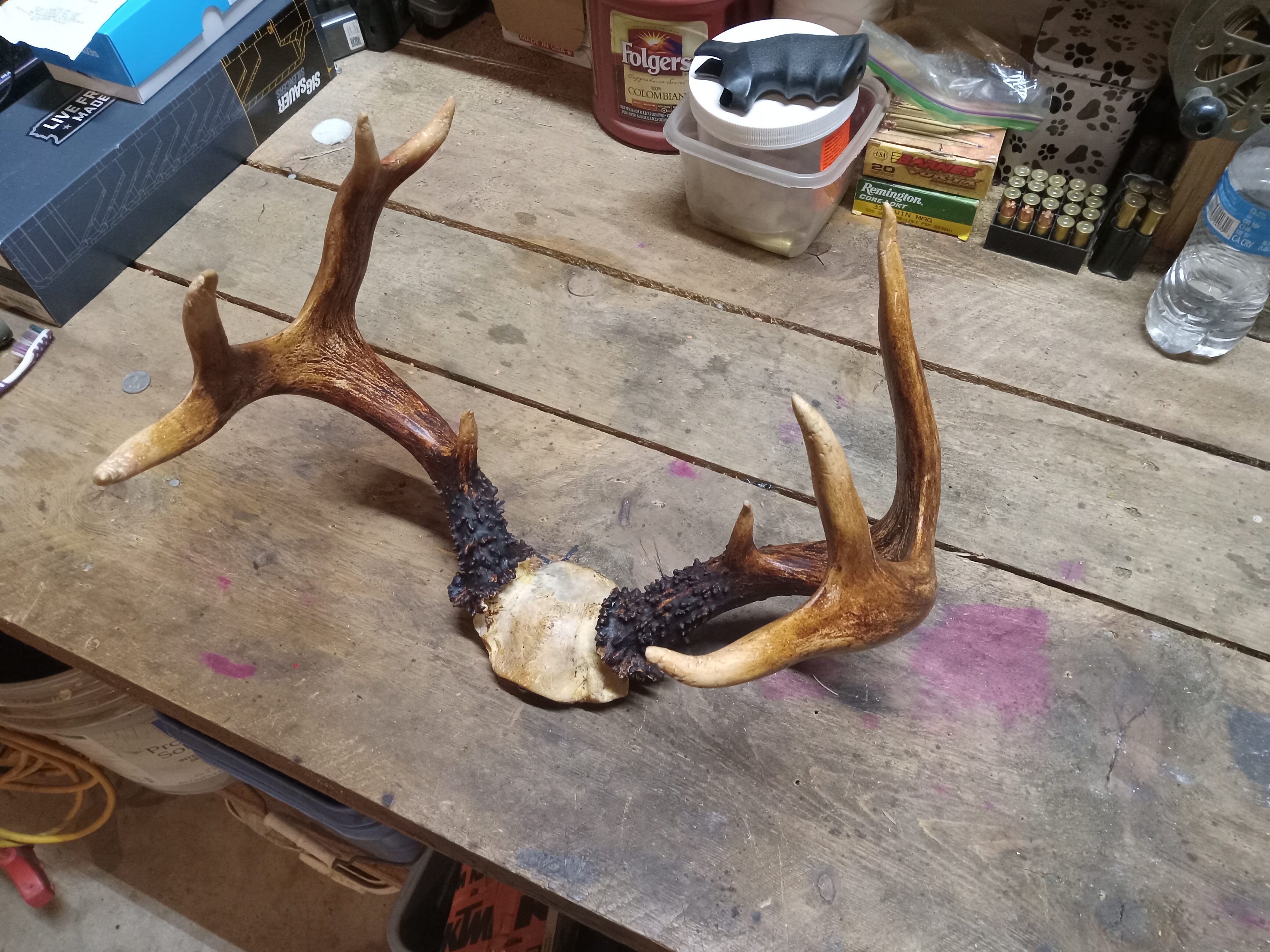

This is a 9 point Sitka Blacktail rack that someone had stripped of its velvet some several years after taking the animal.
He brought it to me just the other day. He said he wanted a dark rack. I said OK! Not a problem.
Before
After
The darkness all depends on how much polish one uses.
If you want a lighter shade. Use very little polish at the start and see how you like it. The lighter you go. The more rubbing by hand it takes to spread out the polish. If you don't like how it turns out. No problem the polish with wash right off with hot water and a good degreaser.
