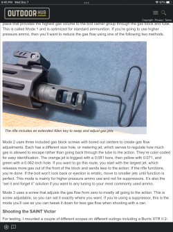

There is a dedicated page in the owners manual for the set screws and gas block.
May be beneficial to read
A 5/8/2019 article on Outdoorhub.com does a better explanation of system than the manual does.
