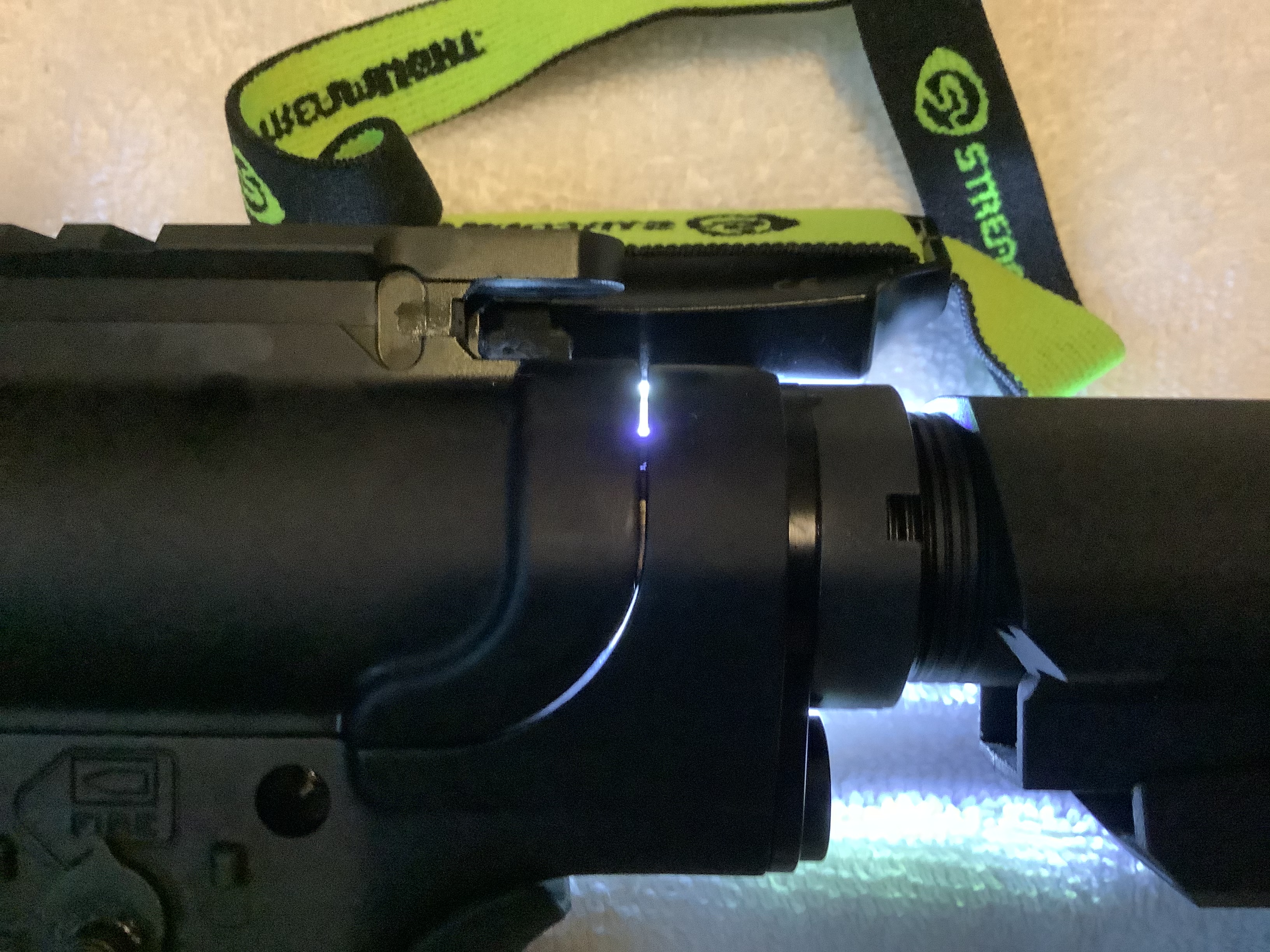

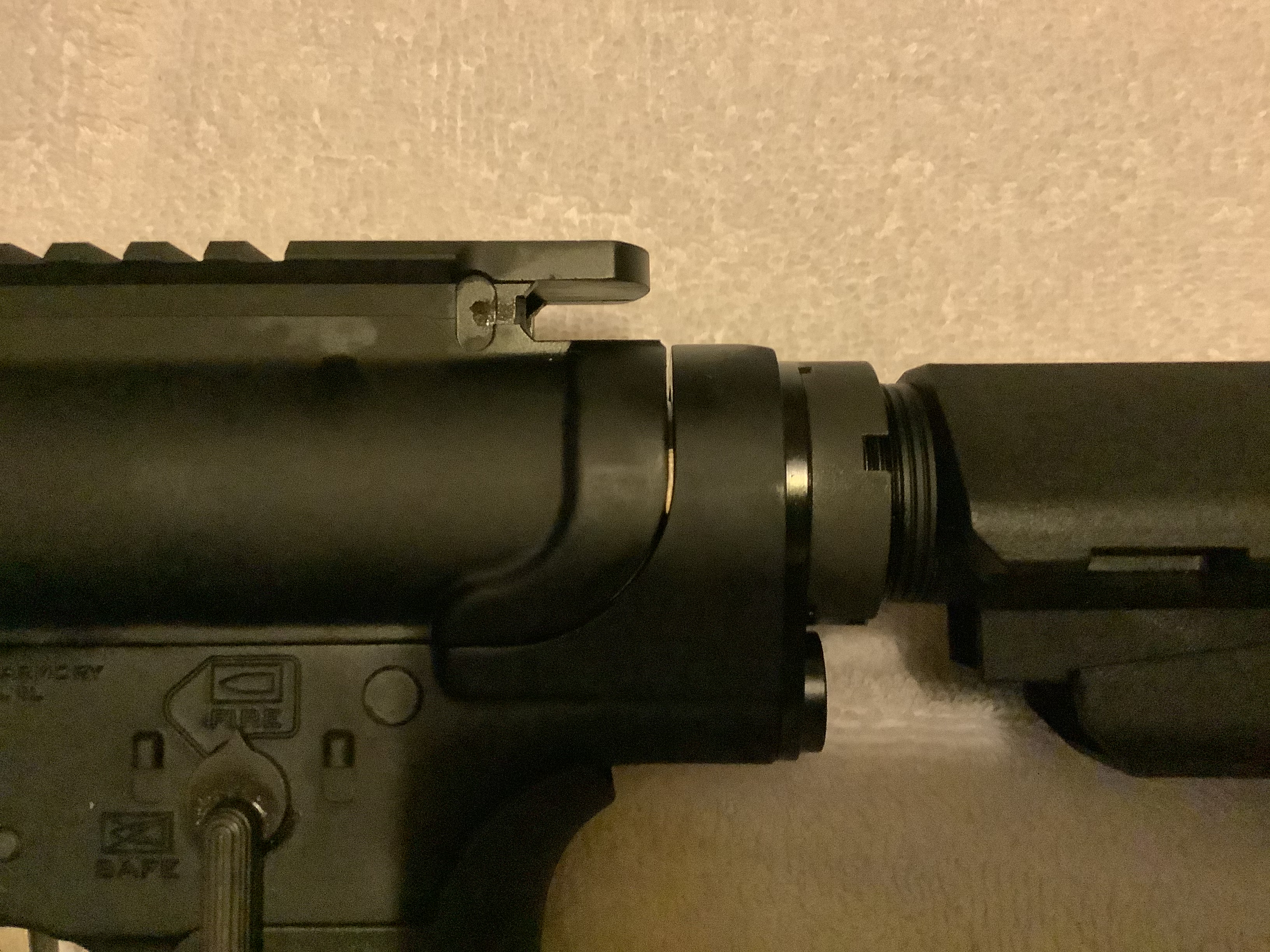

Just bought a Saint .308 pistol. Got home, started to clean it so I could zero it tomorrow and discovered that the upper and lower have a gap of about 1 to 1.5 mm at the rear/buffer tube end. I also noticed that the charging handle belly is rubbing against the upper and removing coating. I haven’t fired it yet. Think I should call Springfield? Thank you for any input.
p.s. Scratches and gap don’t bother me. I just want to make sure that it’s not so out of spec that it woold dangerous to shoot.

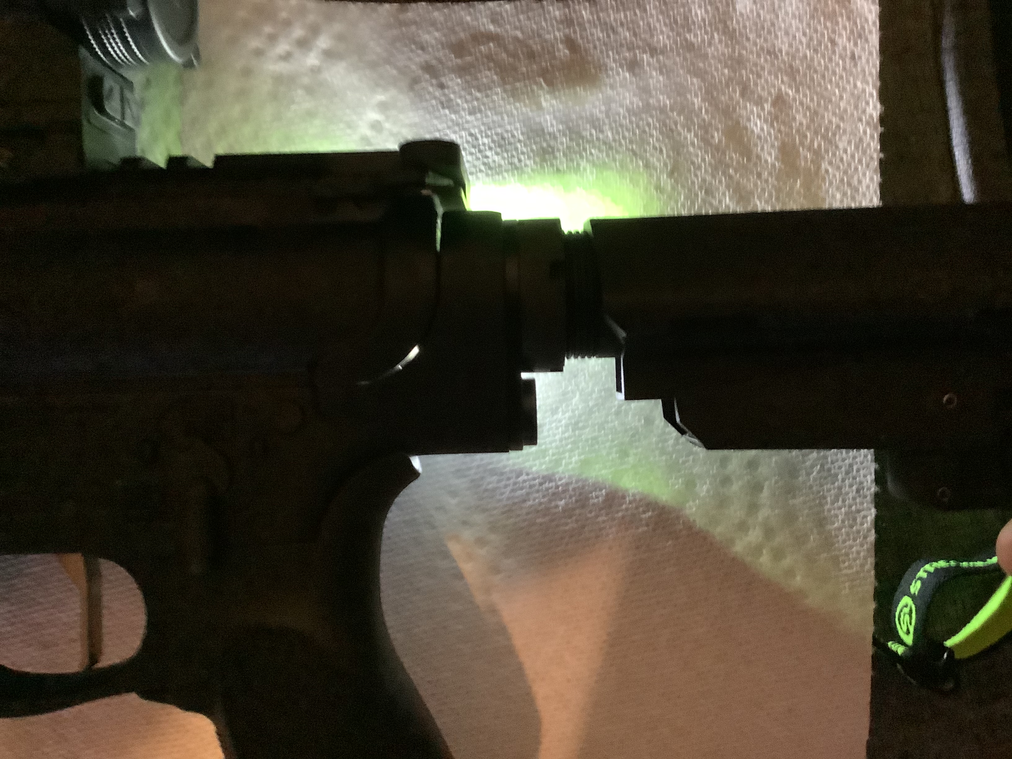

I've had my Saint .308 pistol for several months now. Holding it up to the sun, I have a very minuscule line of light, but it is even along the whole length, and not gaps like you are showing. No kind of play between upper or lower receivers, still very "tight", and absolutely no kind of wear on the charging handle, or where it might rub. Still has the factory coating with no wear marks. I wish I could tell you if that was a concern or not, but I'm not sure. My AR-15 that is almost 30 years old shows a lot more light between the receivers, but still shoots like a champ. In my time in the Army and Marine Corps, issued M-16A1s, M-16A2s, and M-4s had a lot more "slop" in them, and they worked fine for me. At least document what you have, so if there is a problem down the road, S.A. can hopefully help you with warranty issues.

I’ve owned a ridiculous amount of AR pattern rifles the last 30+ years. I’ve never seen a receiver gap like this. The gap is only on the rear inch and half of the receiver. I expect some play in the build, but I believe this is out of spec. The upper won’t sit in the lower properly to the degree that the rear of the upper is a teensy bit higher than the front, if the rifle was sitting perfectly level.

Do me a favor. Look at your saints rear takedown pin and compare it to my pics while looking at the same side of your pistol. I’m wondering if the rear pin hole is too high.
Just looked at mine again, no gap as big as you have, mine is very slight. I also noticed the difference in heights between your upper and lower receiver where they meet up, at the top, where your charging handle would cover that area up. I took off my charging handle, and while there is a minuscule height difference, it is not as much as you have. I don't think your rear take down pin is off, or you would have a gap along the bottom, between the upper and lower receivers. Maybe too much was milled off of one or both of the receivers during production? Like I mentioned before, I'm not sure if this is a real concern, or not. Supposedly, but not for sure, it should have been test fired with one round from the factory. Not for sure if they still do this or not. Keep us updated on what you find out, once you can get a response from S.A. I'm curious myself now.
Thank you very much for looking. Looks like I have to call my ffl. Thankfully, the ffl also covers the pistol for one year due to mechanical issues,etc. I will definitely keep you posted.
