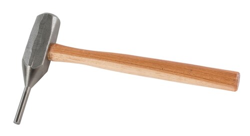

This aught to do it...

Taped the jaws to protect the slide, with a couple layers of duct tape. Got the slide clamped in. Steel punch, 16oz framing hammer. Tap....tap....tap harder....tap a little harder...it moved...tapped some more (right to left)...and out came the front sight. Lined up the TruGlo front, tapped it into place.
Moved to the rear, did the same thing. Right to left, tapped out the stocker, tapped in the TruGlo. Turns out the allen wrench is for a locking screw for the TruGlo rear sight. I left it out until I'd used my (known-zeroed) laser to cowitness proper alignment (slight tap here, slight tap there, and the rear was lined up), and once I had it centered I put the screw in to help hold it.
