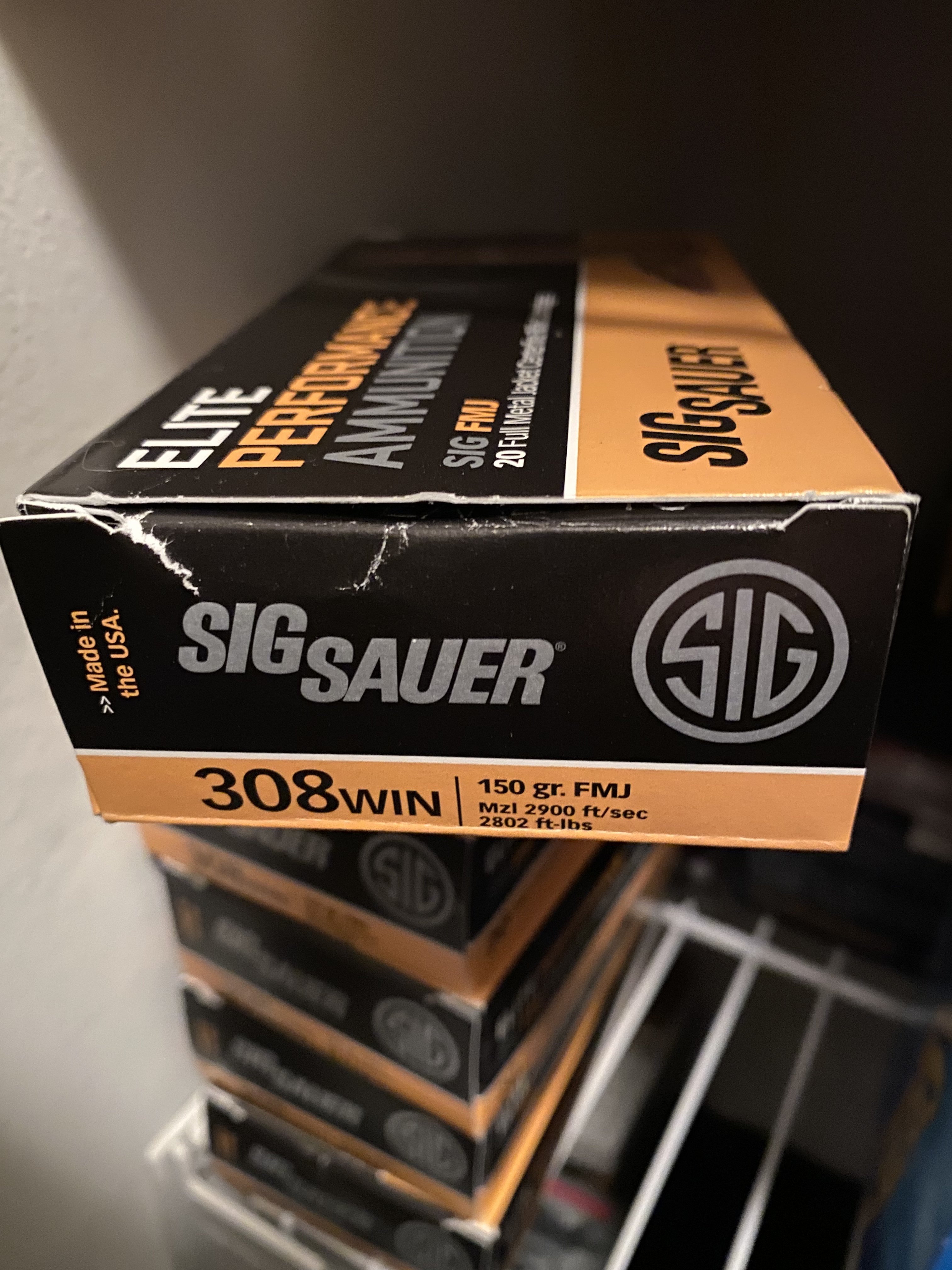

Ok well you have to put some rounds through that puppy before you worry about something, my M1A is the standard and loves to eat….
But you will find that every gun is different and what some function ok with some don’t so don’t buy a lot of one manufacturer’s loads or grain weights until you figure that out.
and as the picture so clearly indicates-stick with full metal jacketed ammo.
