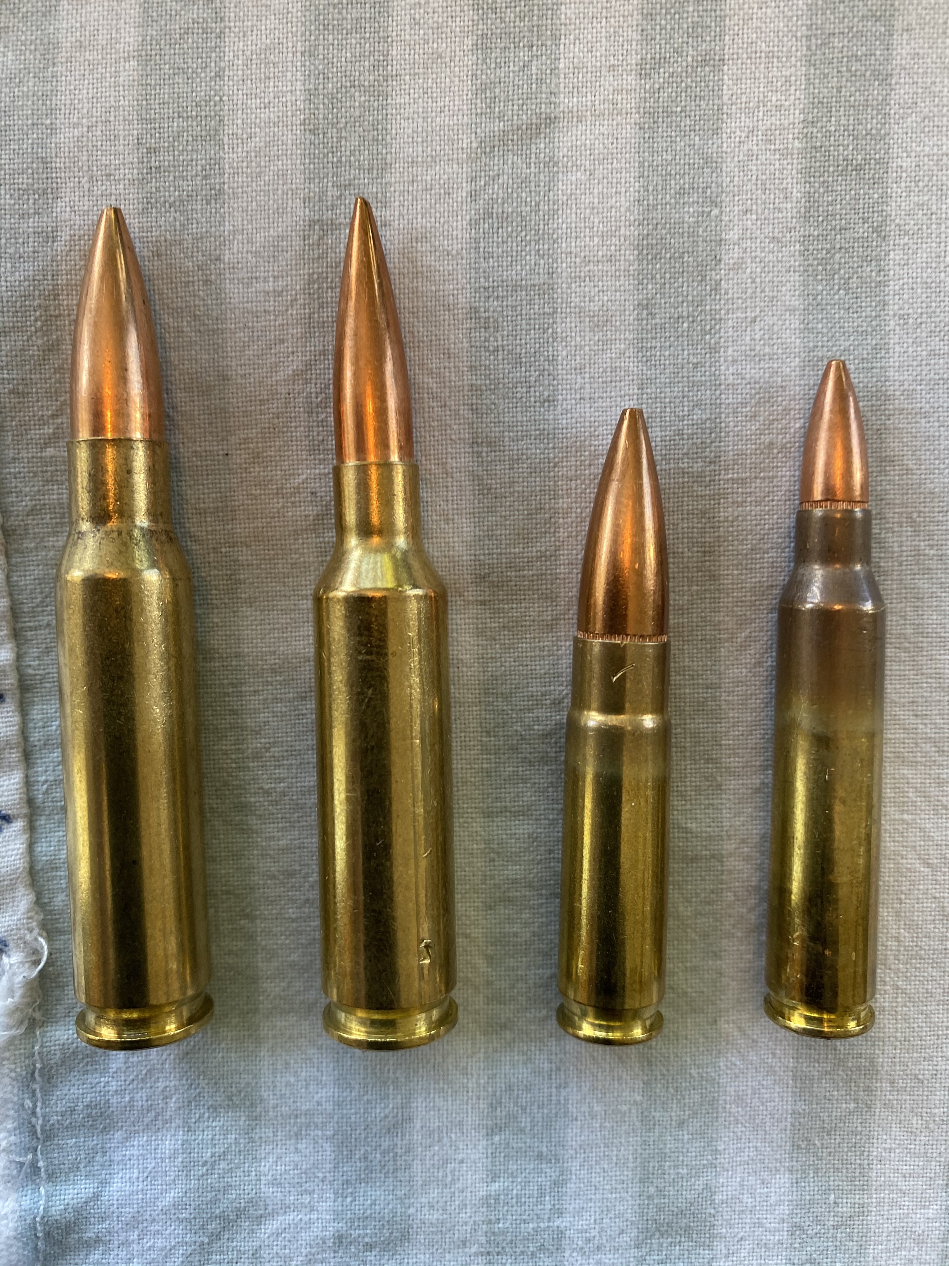

This is a question I’ve been wanting to ask for awhile, is there a difference in brass between manufacturers and or calibers? The reason for this is I’ve noticed that no matter the manufacturer the 5.56 is discolored in the crimp area of the round but I don’t see that in other calibers. To you guys that re-load and I’m sure most of you this may seem like a stupid question.
Below is a picture of 4 different calibers.
Left to right.
.308, 6.5CM, 300BO and 5.56
Ok, the discoloring around the neck is caused by annealing the case neck, this is usually done on once fired military cases, and to answer you question on difference in cases from different manufacturers is yes, some are thicker, some the web area inside case is different, even though you have 2 cases from different manufacturers in the same caliber, there is is difference between them, this is also for handgun cases too.
