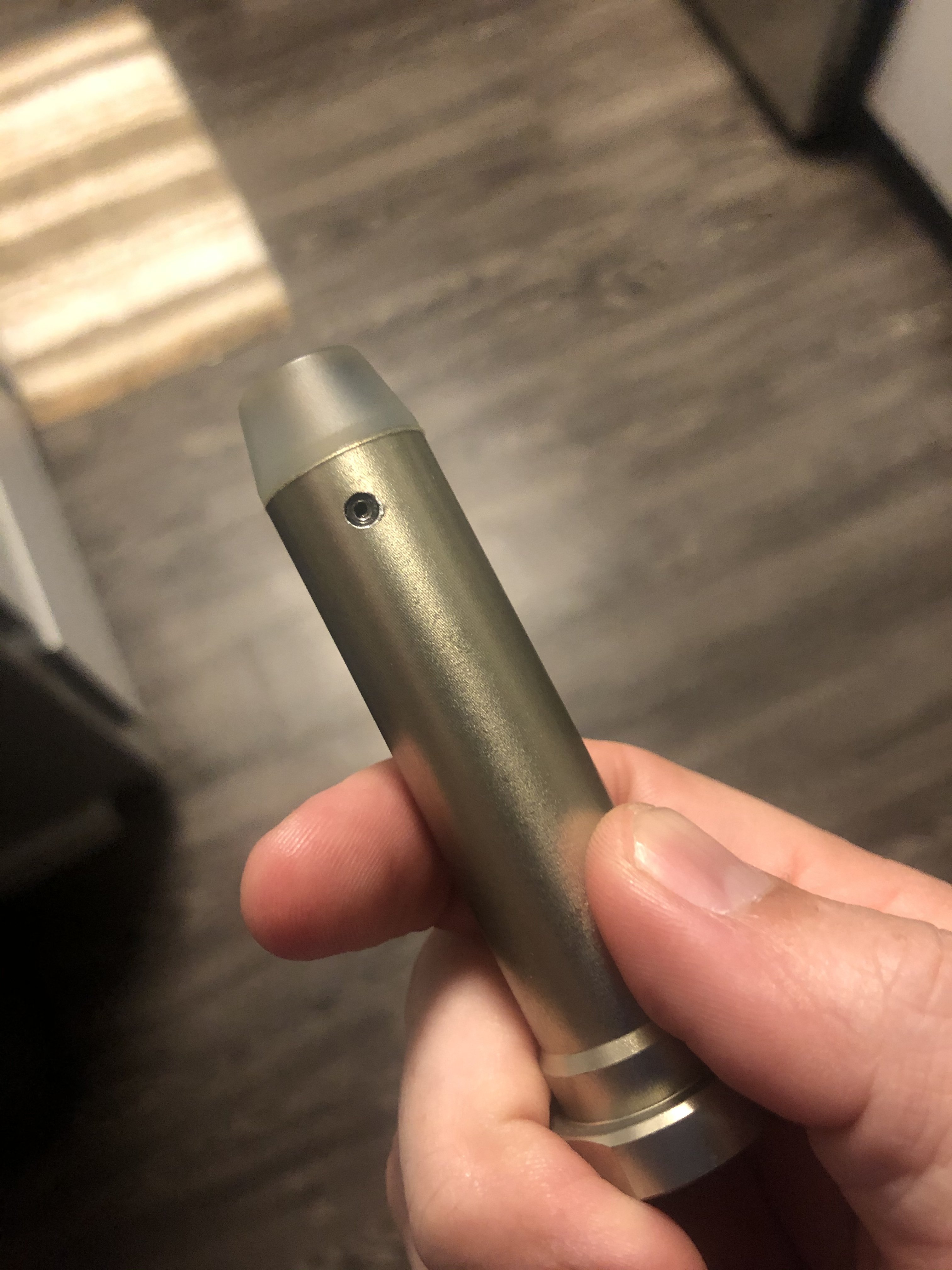

Can u post a picture ?

Are you sure it's roll pin?
Am not familiar with Geissele H2 buffer. On this end of pic, even enlarged , looks almost like hex head set screw, not roll pin. Find another of same style buffer w/o issue to verify fastener used?
Yes, jigs definitely help when dealing with small parts. Padded non flammable jigs are generally best when dealing with heat or open flame. Either way, try heating surrounding area and removing fastener if metal? (Looks like it is.) Or, drill out fastener with bit approximately 1/4 or smaller to possibly half size diameter of fastener, then move bits up progressively until most of fastener is gone. Then, tap out remainder with small chisel or punch. Idea is to eventually slot old fastener from top to bottom on at least two sides and pry out with pick or similar tool pushing out remaining fastener inwards to drop it out fastener hole. Have done w/o slotting fastener many times when careful.
If set screw? Be wary of cutting screw threads. If roll pin? Drill out and use another roll pin. If drilled out too much, use over sized roll pin to refasten. But, either way, it can be done if very careful. Good luck!
TIP: Need good quality drill bits tougher than fastener to work. Drill press helps too.
Yes sir, Geissele instructions call it a roll pin, no hex head on it, more like a small hinge.
I have the manufacturer recommended punch and a gun vise, but it's winning so far.
