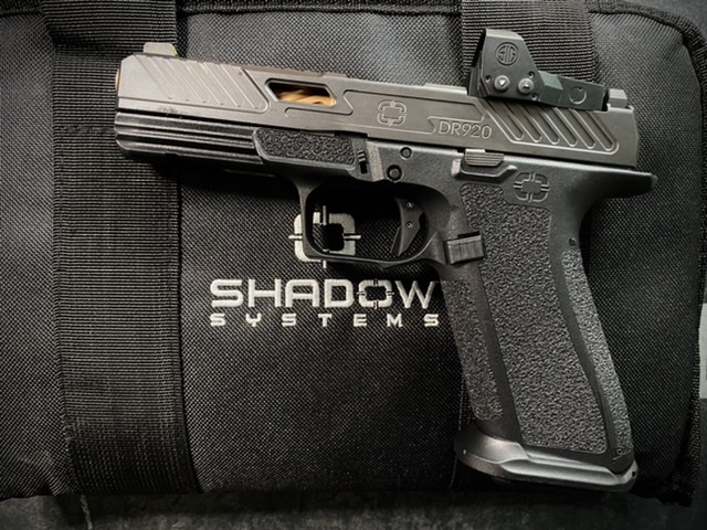

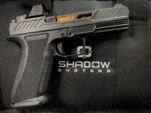

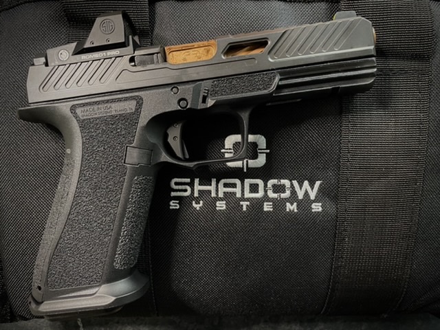

I just bought a Shadow Systems DR920. It comes with a proprietary optic cut that will take almost any red dot and sits low enough that it co-witnesses with the stock sights. I currently have a Sig Romeo1Pro installed on it.

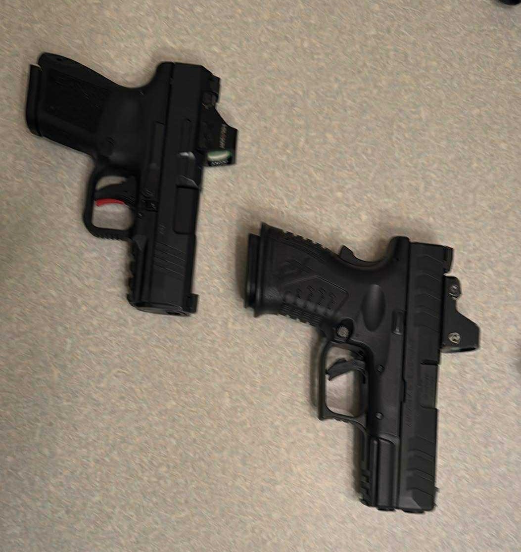

Ok so the next day thinking about it and seeing Simons gun, we need to differentiate on “co-witness“ and what type of co-witness. When I answered I am talking about full co-witness, not A 1/3. So on my XDME it is absolute the red dot matches what the iron sights are seeing. My opinion here……and I know this is controversial but a lower 1/3 is not co witness. If you have two different sight pictures……they are not co witnessed. So like on my Hellcat Pro it is also Absolute with short factory sights with the Wasp RD. Both my XDME and Hellcat I have the red dot like the picture all the way to the right the only difference is the XDME has tall sights. One sight picture and if I move off axis the red dot is still the impact.
