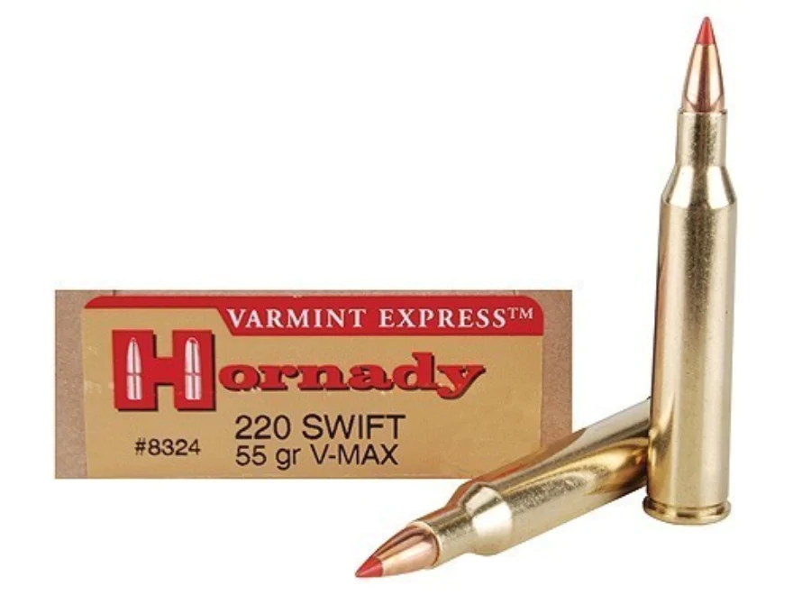

The .220 Swift (5.56×56mmSR) is a semi-rimmed rifle cartridge developed by Winchester and introduced in 1935 for small game and varmint hunting. It was the first factory-loaded rifle cartridge with a muzzle velocity of over 4,000 ft/s, just under Mach 4. The velocity of the cartridge ranges from 1200 mph up to about 4500 2800 mph.
The Swift is a large cased .224 caliber cartridge and bullet that was created for small game such as prairie dogs, groundhogs and other vermin such as marmots. When introduced it was 1,400 ft/s faster than its nearest varmint-hunting competitor, which was the .22 Hornet (also .224 caliber). It was found to be an extremely accurate cartridge as well.
The .220 Swift remains the fastest commercial cartridge in the world, with a published velocity of 4,665 ft/s using a 29 gr bullet and 42 gr of 3031 powder. Due to its very high velocity its bullet drop allows precise sighting on game such as groundhogs to ranges out to 375 yd, and it is still considered an excellent cartridge for taking varmints by experienced Swift shooters.
The original factory load from Winchester provided a 48-grain bullet launched at 4,100 ft/s. Handloaders could marginally improve on this but only at maximum loads. The Swift can be loaded with light bullets to reach 4,400 ft/s. In recent times 75-grain .224" bullets have been developed for use in high velocity .22 caliber rifles for taking larger game and long-distance shooting. Heavier bullets perform best in rifles that have an appropriate rifling twist rate taking into consideration the diameter, length, and other physical properties of the projectile.

Critics of the Swift have maintained that the light, 50-or-55-grain, bullet leaves an inadequate margin for error in bullet placement for the average deer shooter's skills, and thus invites wounding, which would have otherwise been avoidable. There is, however, little debate about the Swift's proven effectiveness on small deer species, such as roe, provided very fast-fragmenting "varmint"-type bullets are not used.
Most factory Swift rifles come with a fairly slow twist-rate such as 1–12 or 1–14 inch, designed to stabilize the lighter bullets popular in varmint hunting. Custom Swifts can have faster twist-rates such as 1–9 inch allowing them to stabilize heavy bullets, including those with a construction suitable for larger game. P.O. Ackley maintained that the .220 Swift was a fine round for medium-large game and used it extensively for example when culling wild burros in the American West.
