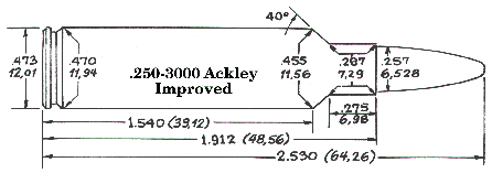

When both are loaded to the same chamber pressure and fired in barrels of the same length, the improved version will be about 100 fps faster than its parent. Velocity will vary slightly depending on how much or how little body taper the parent case has. The original Ackley version had a 40 degree shoulder angle but 30 degree versions are also used.

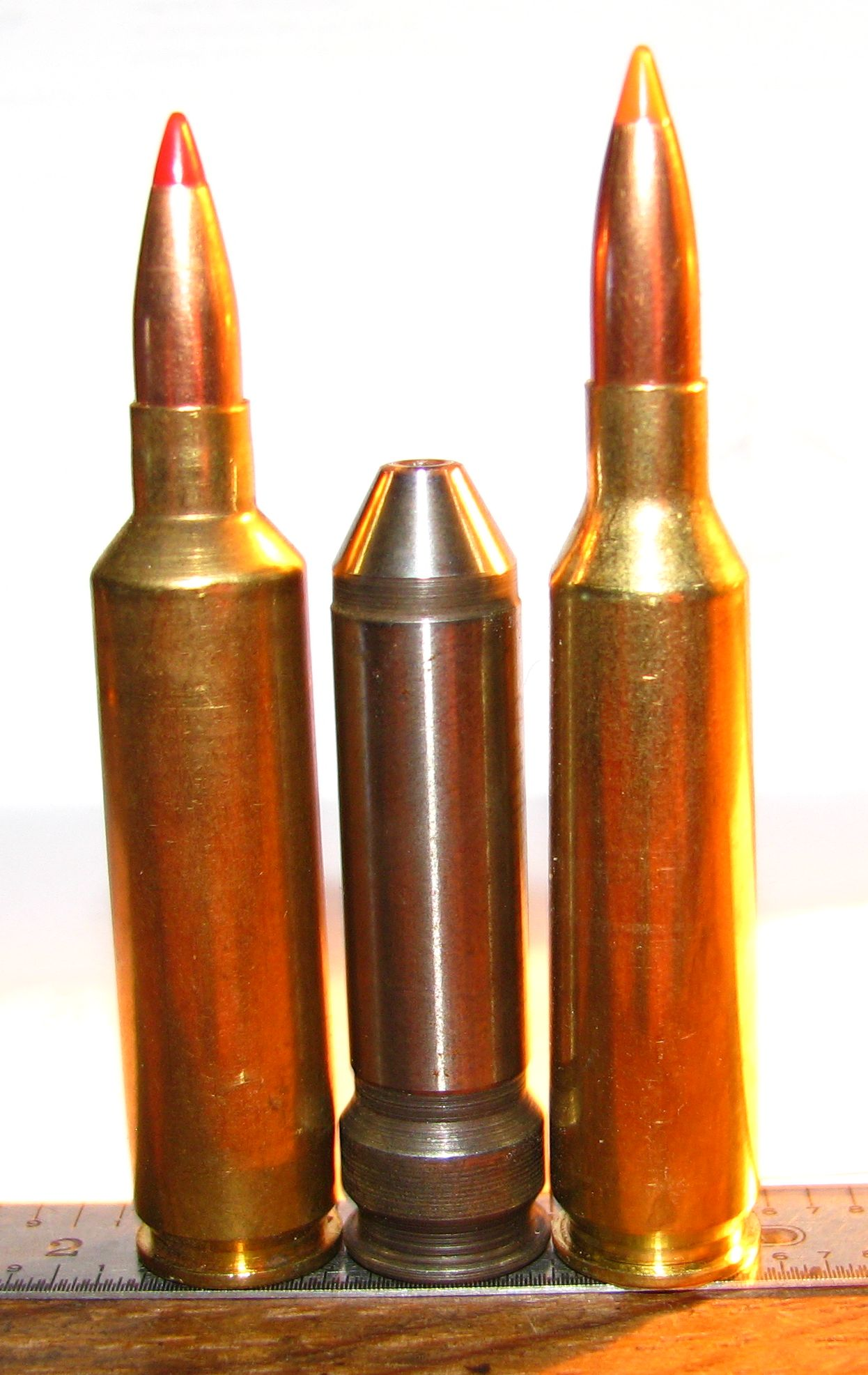

The .250 Ackley Improved case is created by fire-forming a .250 Savage (shown on left in image) in the .250 Ackley Improved-chambered rifle, although custom cases are available from some custom manufacturers.
.250 Savage ammunition and component cases are difficult to find, but readily-available and inexpensive .22-.250 Rem. brass can first be resized through a full-length .250 Savage resizing die. A mid-range .250 Savage handload and fired in the .250 Ackley Improved barrel will fire-form the case, which will then need to be checked for propper lngth and completed in the appropriate .250 Ackley Improved dies.
