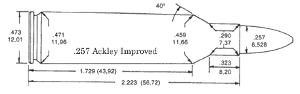

The .257 Roberts Ackley Improved
The .250 Ackley Improved was developed by Parker Otto Ackley, P.O. Ackley, was an American gunsmith, barrel maker, author, columnist, and wildcat cartridge developer, that sparked considerable interest in improved cartridges.
According to P.O. Ackley, the modified 257 Roberts was likely the best improved round compared with the couple dozen or so factory cartridges he’d experimented with.

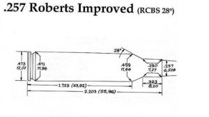

The two most popular "Improved" .257 Roberts cartridges are the Ackley and RCBS versions. They are quite similar except for the shoulder angle, which is 40 degrees for the Ackley version and 28 degrees for the RCBS version.
The Ackley Improved family of wildcat cartridges are designed to be easily made by rechambering existing firearms, and fireforming the ammunition to decrease body taper and increase shoulder angle, resulting in a higher case capacity. P.O. Ackley improved not only standard cartridges, but also other popular wildcats. Measured water capacities of a standard .257 Roberts case and fireformed AI cases, the difference was about 13 percent (60 grains compared to 53 grains of water).
