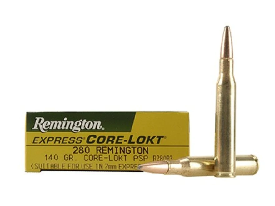

The .280 Remington
The .280 Remington, also known as the 7mm-06 Remington and 7mm Express Remington, was introduced in 1957 for various Remington rifle models.

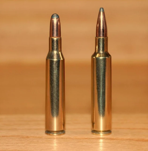

.280 Ackley Improved
One of P.O. Ackley's earliest wildcats was the 7mm-06 Improved, which was made by necking down the .30-06 Springfield case and fire-forming it to have less body taper and a 40-degree shoulder angle.
Soon after the .280 Remington came out, Fred Huntington reformed its case to an improved configuration with minimum body taper, a 35-degree shoulder angle, and called it the .280 RCBS. Since cases for the .280 RCBS could be formed by firing .280 Remington ammo in a rifle chambered for the former, Ackley abandoned the 7mm-06 Improved and started chambering rifles for the .280 RCBS. He then changed the 35-degree shoulder to 40-degrees and the .280 Ackley Improved was born. If barrel length and chamber pressure are equal, the .280 Ackley Improved is about 100 fps faster with all bullet weights than the standard .280 Remington.
In 2007, ammunition manufacturer Nosler registered the .280 Ackley Improved with SAAMI and began providing factory loaded ammunition and rifles for it.
.280 Ackley on the right
