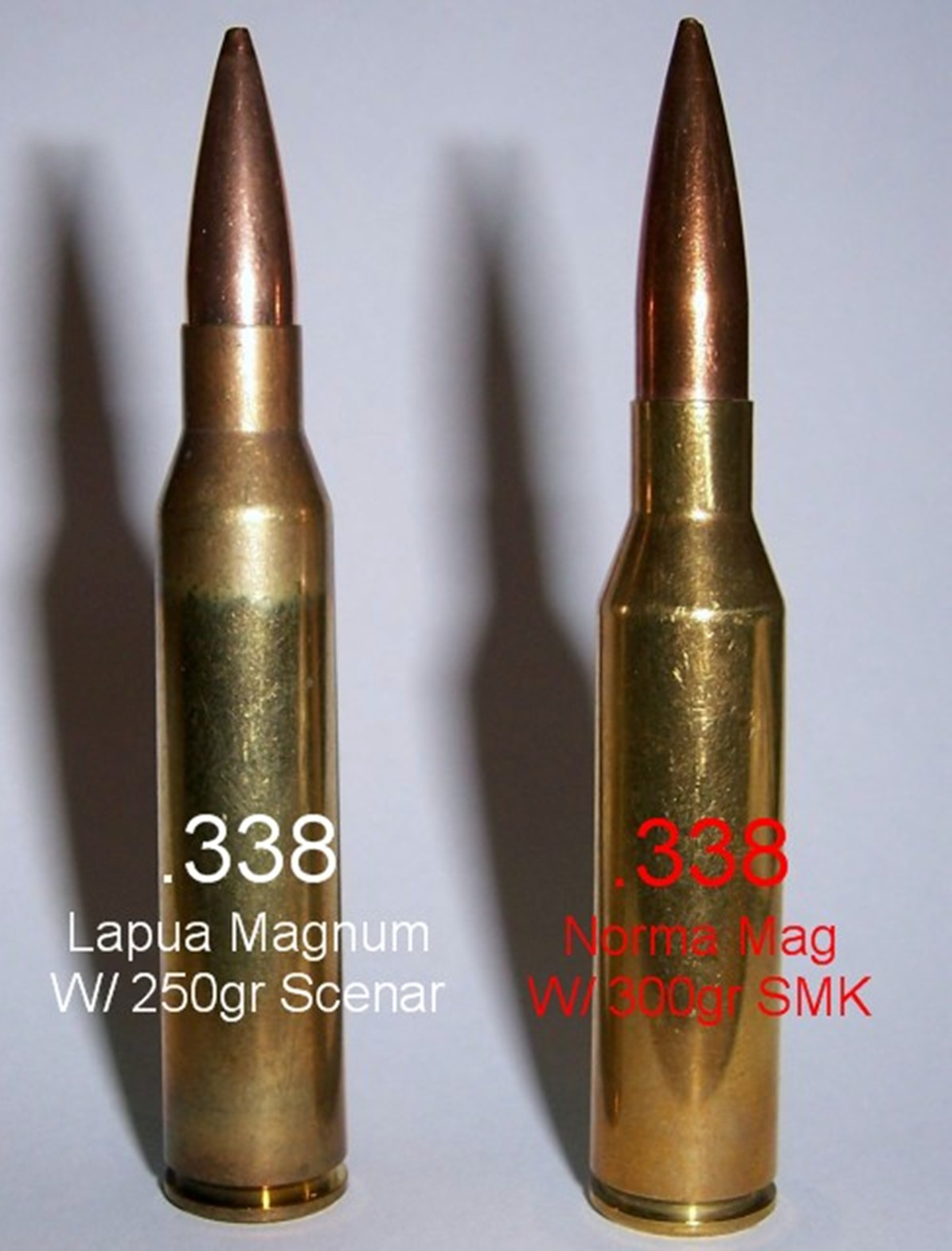

The .338 Norma Magnum prior to C.I.P. certification had a shorter cartridge overall length 3.60 in compared to the cartridge overall length of the .338 Lapua Magnum at 3.681 in. The .338 Norma Magnum loaded with 300 gr .338 caliber Sierra HPBT projectiles will have these projectile less deeply seated compared to the .338 Lapua Magnum when both cartridges are loaded to 3.681 in overall length.
To achieve this the .338 Norma Magnum cartridge utilizes a shorter case 2.492 in with less taper and a slightly sharper shoulder angle with a slightly longer neck, resulting in about 6.5% less case capacity. However, the cartridge overall lengths of the .338 Norma Magnum and .338 Lapua Magnum were, as of 2013, determined at 3.681 in by the C.I.P. rulings for these cartridges.

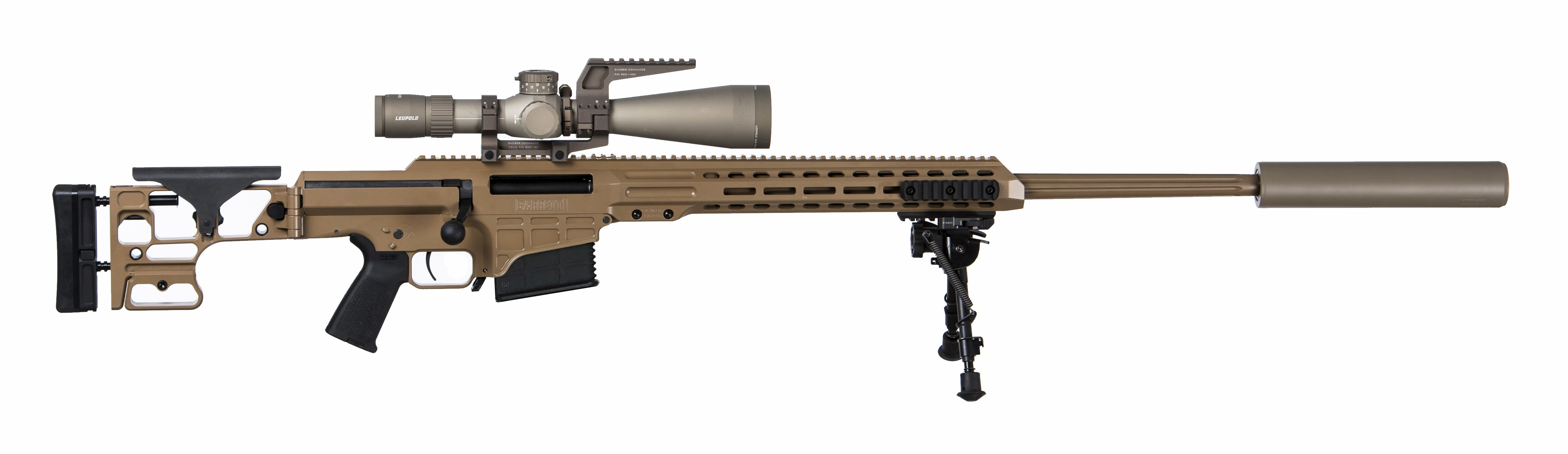

In May 2017 the United States Special Operations Command, in conjunction with the United States Marine Corps issued a sources-sought notice for 5,000 Lightweight Medium Machine Guns (LWMMG) chambered for .338 Norma Magnum polymer-cased ammunition. The aim is to identify a machine gun with a 24 inch long barrel weighing 24 pounds or less, which offers sufficient accuracy out to 2,000 meters to engage area targets and vehicles. In 2019 the U.S. Special Operations Command awarded Barrett Manufacturing a $50,000,000 contract, ordering the Barrett MRAD chambered in .338 Norma Magnum as the Mk 22 Advanced Sniper Rifle (ASR).

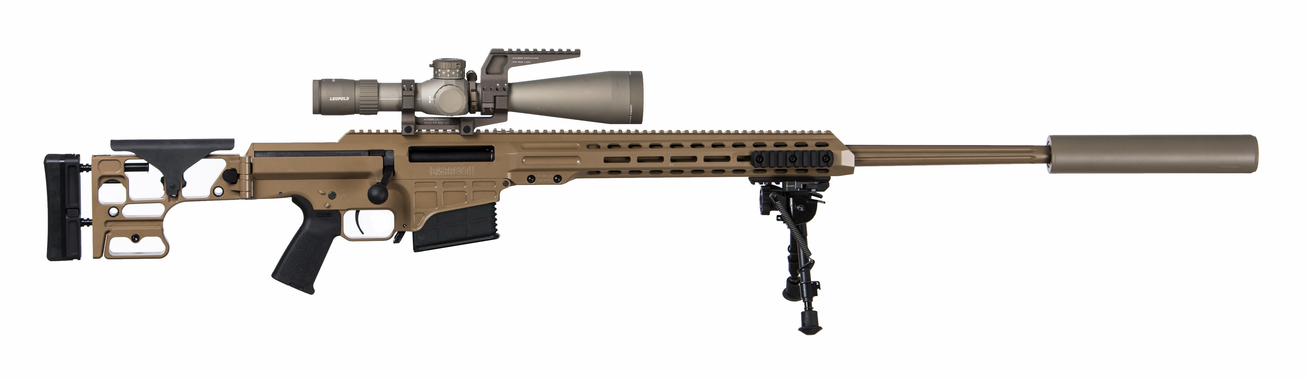

Barrett MRAD

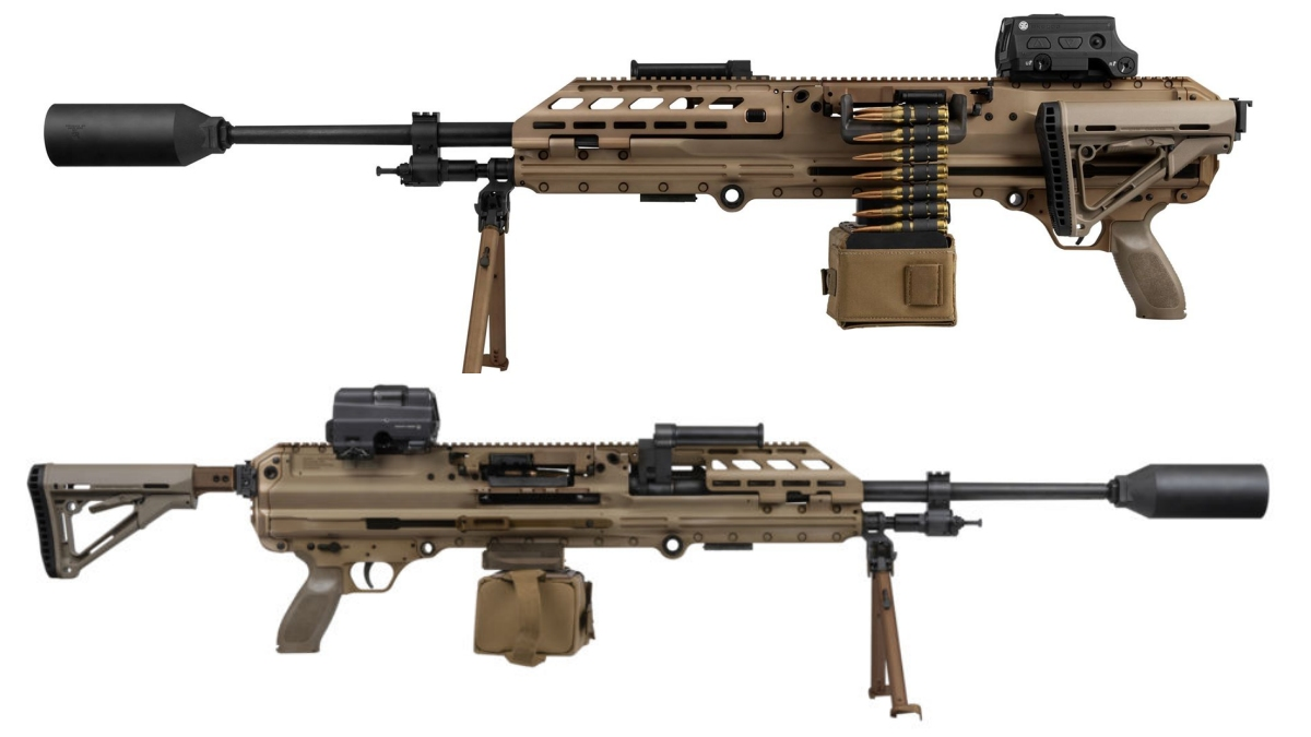

In 2020 the U.S. Special Operations Command awarded Sig Sauer a contract, ordering the MG-338 machine gun chambered in .338 Norma Magnum.
Sig Sauer MG338
Barrett MRAD

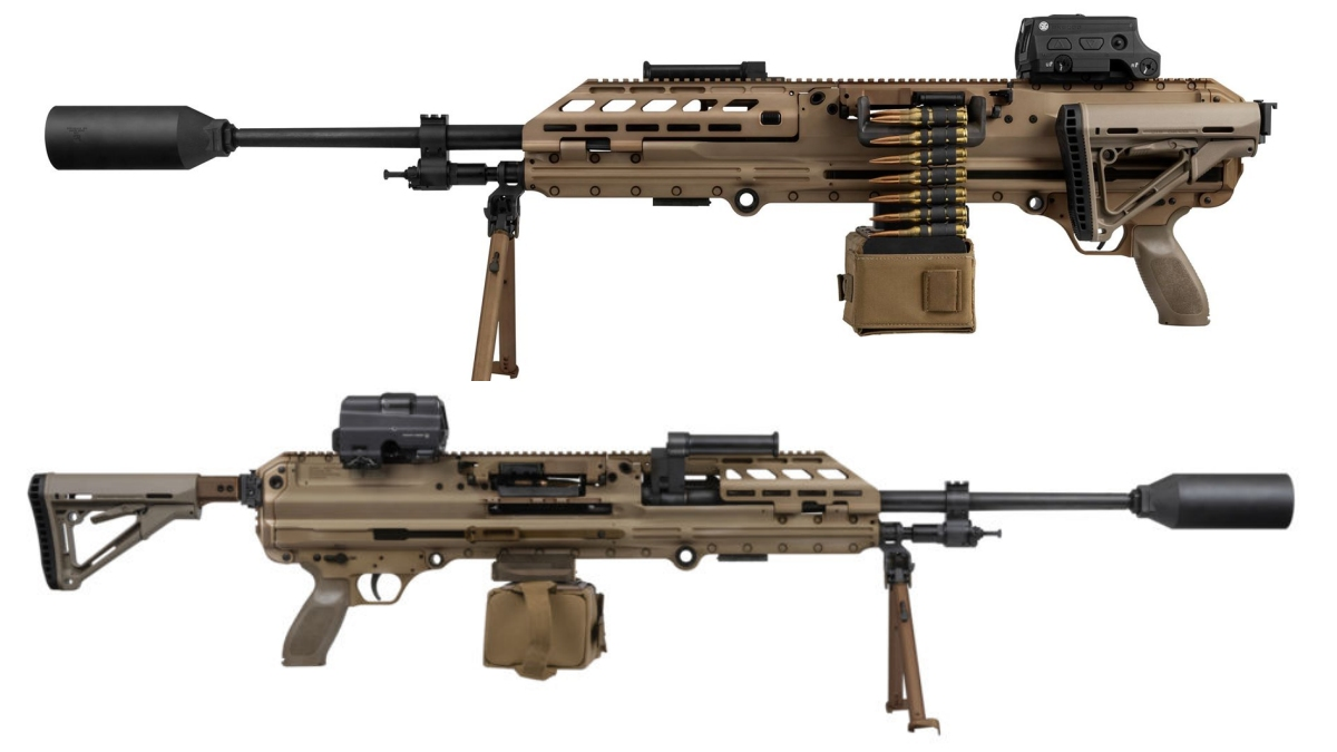

Sig Sauer MG338
