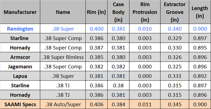

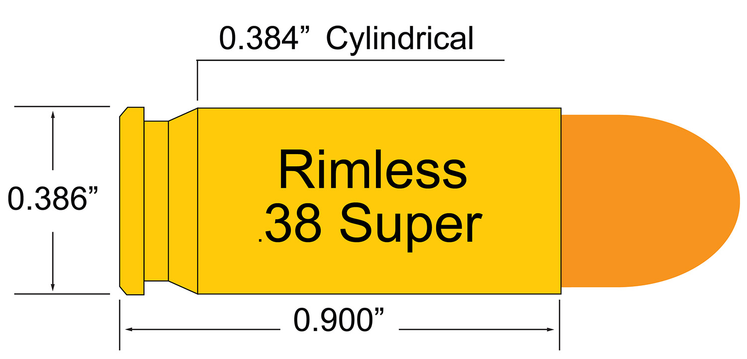

In recent years, cases such as the .38 Super Comp, .38 Super Lapua, .38 Super RL (Armscor), and .38 TJ (.38 Todd Jarrett) became available transforming the .38 Super into an almost truly rimless cartridge. These "rimless" cases are somewhat of a misnomer, due to the case rim not retaining the same diameter as the case wall just forward of the extractor groove. A common example is the .38 Super Comp case, which has a semi-rim extending only .003–.004 inch per side, compared to standard .38 Super which has .007–.009 inch per side.
