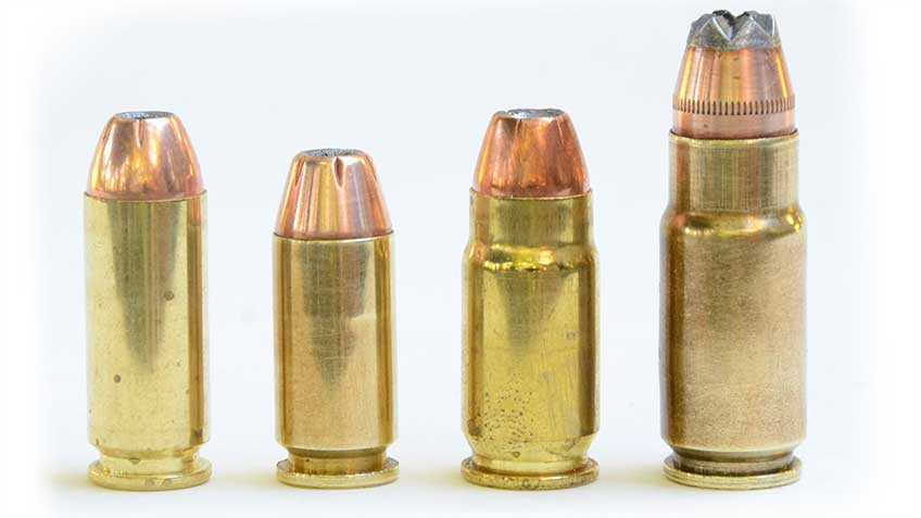

The 10mm Auto (far l.) stands next to (l. to r.) the .40 S&W and the little-used, bottle-necked .40 Super and 10mm Wildey Mag. cartridges

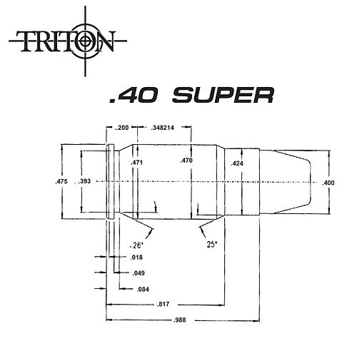

To maximize bullet pull and overall feeding characteristics, the case has a neck length of .175 in. The shoulder angle is an optimum 25 degrees. The neck yields more precise bullet alignment than can be achieved using a cartridge with a shorter neck. This translates to increased accuracy. The pressure limit for factory .40 Super ammunition from Triton was 37,000 PSI, well below the strength limits of the cartridge case.

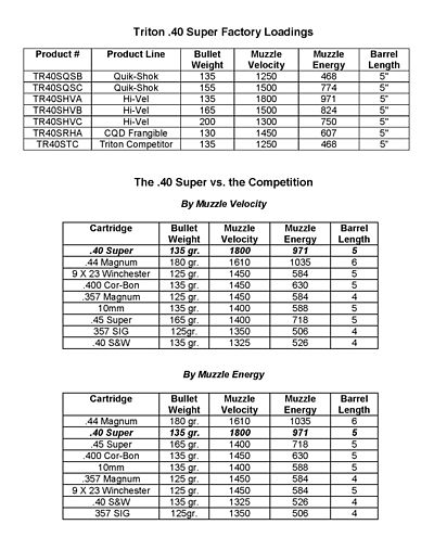

The .40 Super drives a 135-grain bullet to 1,800 feet per second while generating less chamber pressure than the 9x23mm Winchester. With a 200-grain bullet, the .40 Super delivers more foot-pounds of energy at 100 yards than the .45 ACP does at the muzzle.
