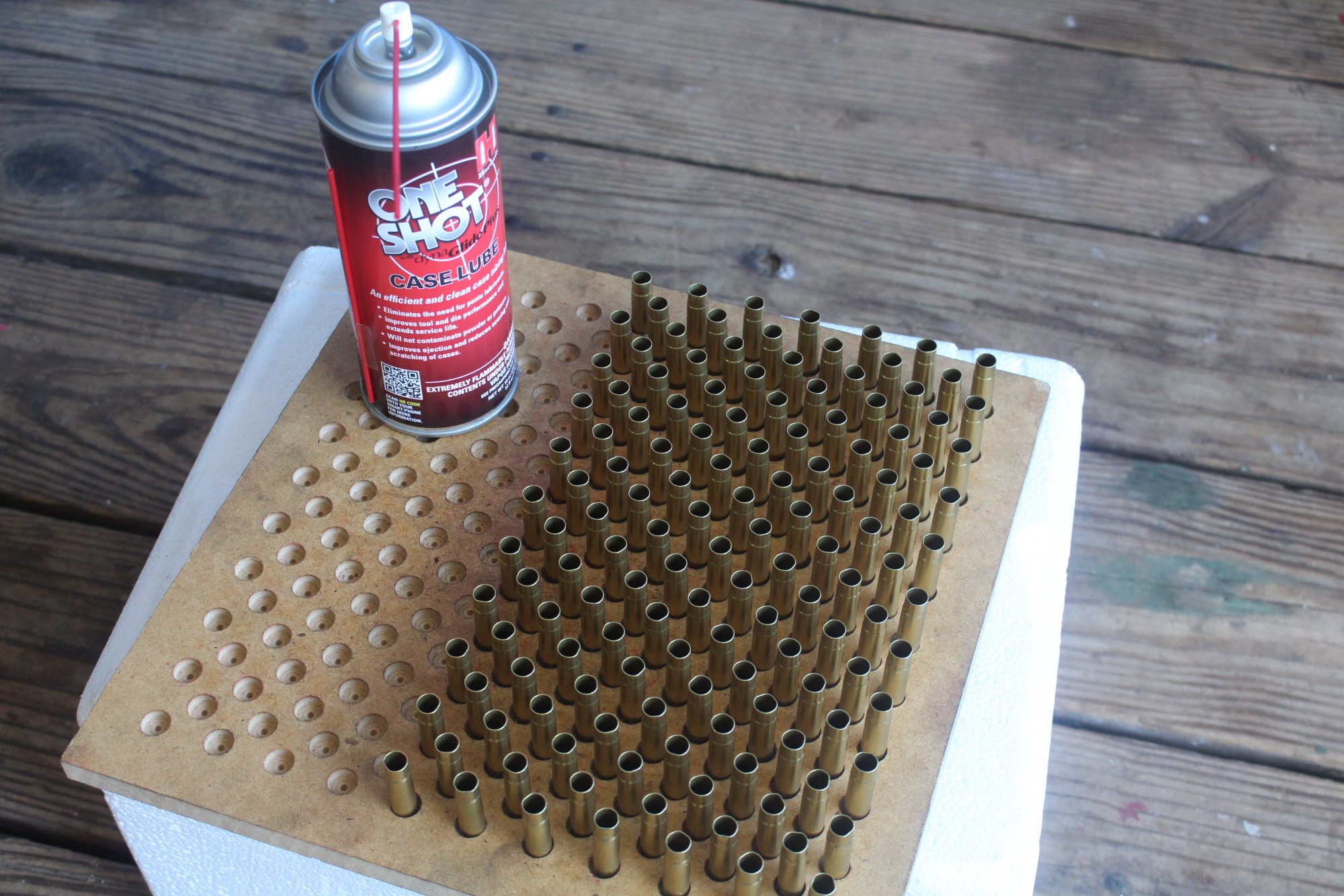

If your sizing die is carbide then you don't need to lube your cases before running them through the sizing step.
I have two cals that I load that I have to lube. My 357 SIG and the 300 Black Out.
I started lubing my SIG's by rolling them on a lube pad. Works ok but is a tad bit tedious.
So I decided to take a lazy way out. I took a piece of wood for a tray and drilled it out to the size of the SIG case.
It's a little less than ¼" deep. Enough to hold the case and keep it from falling over. I alternated each row
so that when I use the One Shot spray it will get them all.
The tray is mounted on a lazy susan swivel so I can spray, give the tray a ¼ turn and spray again.
With three turns I have all sides of the cases lubed.
When spraying I hold the can at a 45 degree angle. That way the inside of the case mouth gets a bit of lube too.
That makes the process of sizing/expanding a little smoother.
For the 300 BO I gave it a try today. As long as I hold the tray steady I don't have a domino mess. I only did a half
tray to take the picture.

What's next "Chinese Checkers"?
