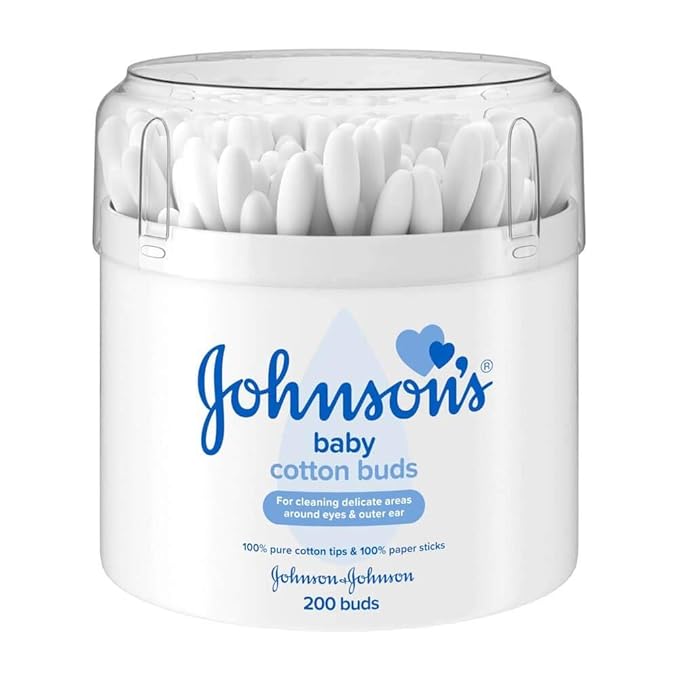

Any eye glass cleaner should be fine and won't harm the coating. You can apply the cleaner with a Q-tip or microfiber cloth.
Just make sure there isn't sand or grit on the optic before rubbing the lens because quartz and other minerals can scratch the glass. A can of compressed air can remove sand and other grit if need.

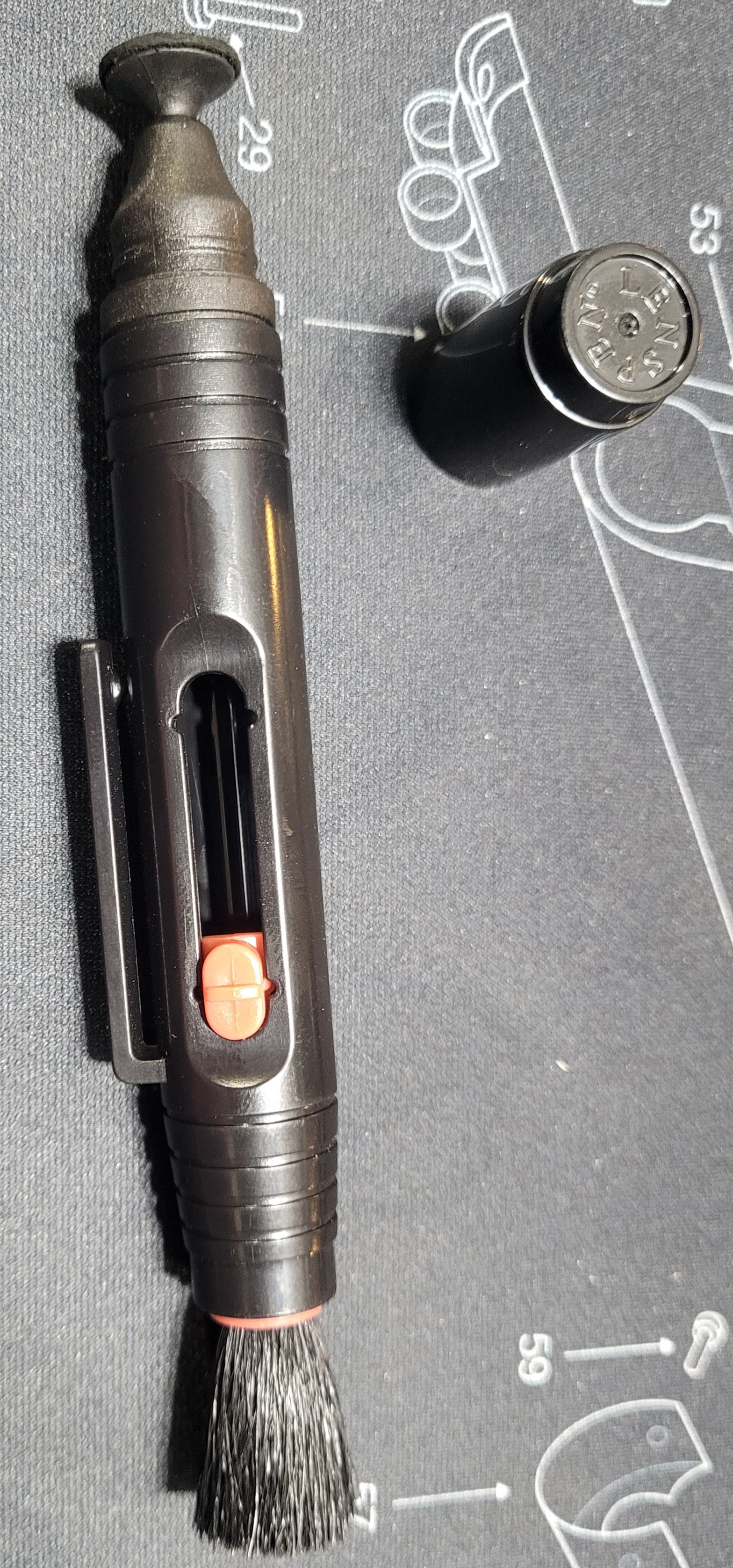

Any type of alcohol, methane, acetone, thinner and/or petroleum products is a NO! Some optics I've purchased came with a retractable brush on 1 end and a suction cup on the other. Those listed products can remove the coatings. Remember the older window tint when using Windex that it would change the color of the tint from black/smoke to purplish. Sprayway (I think the name is correct) was the only(?) 1 that was safe to use? Use a microfiber or a DVD cleaner cloth. Works for me!

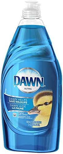

As mentioned above, Dawn dish soap. I make a mix of the soap and water in a small misting sprayer. Give a q-tip a spray and use a circular motion(from outside to inside) then flip and use the dry side. Repeat with a new q-tip until clean. Usually takes me 2-3 q-tips and takes about two minutes to do both sides. Shield Sights recommended this to me and it works better then anything else I have tried. I use the exact products Shield recommends. Make sure to blow off the dust first with an air compressor or canned air. Don't go hard on the lens. Let the surfactant do the work. The q-tip only needs to be slightly moist.
