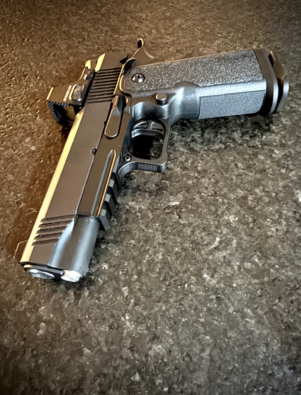

Here’s my before pic. I’ll report back over Christmas.
