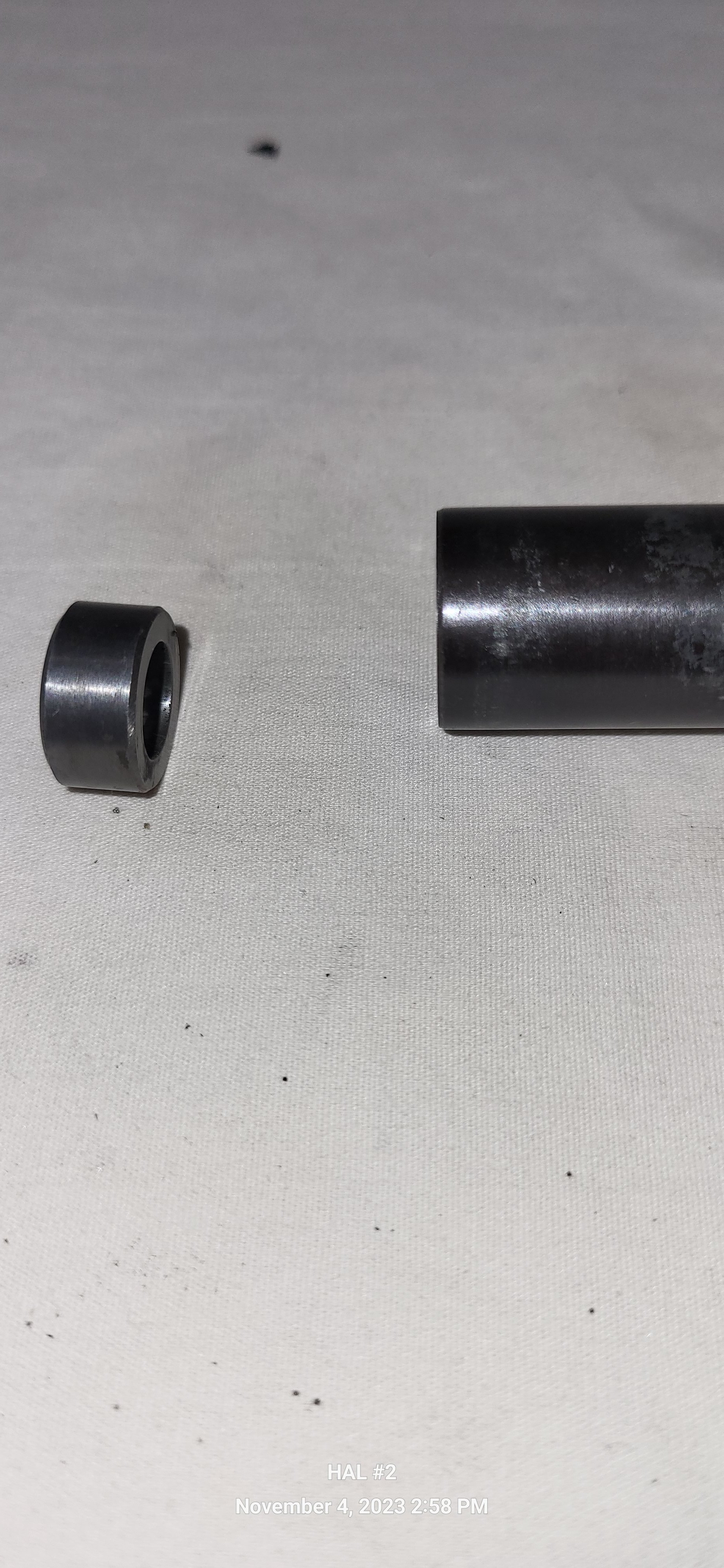

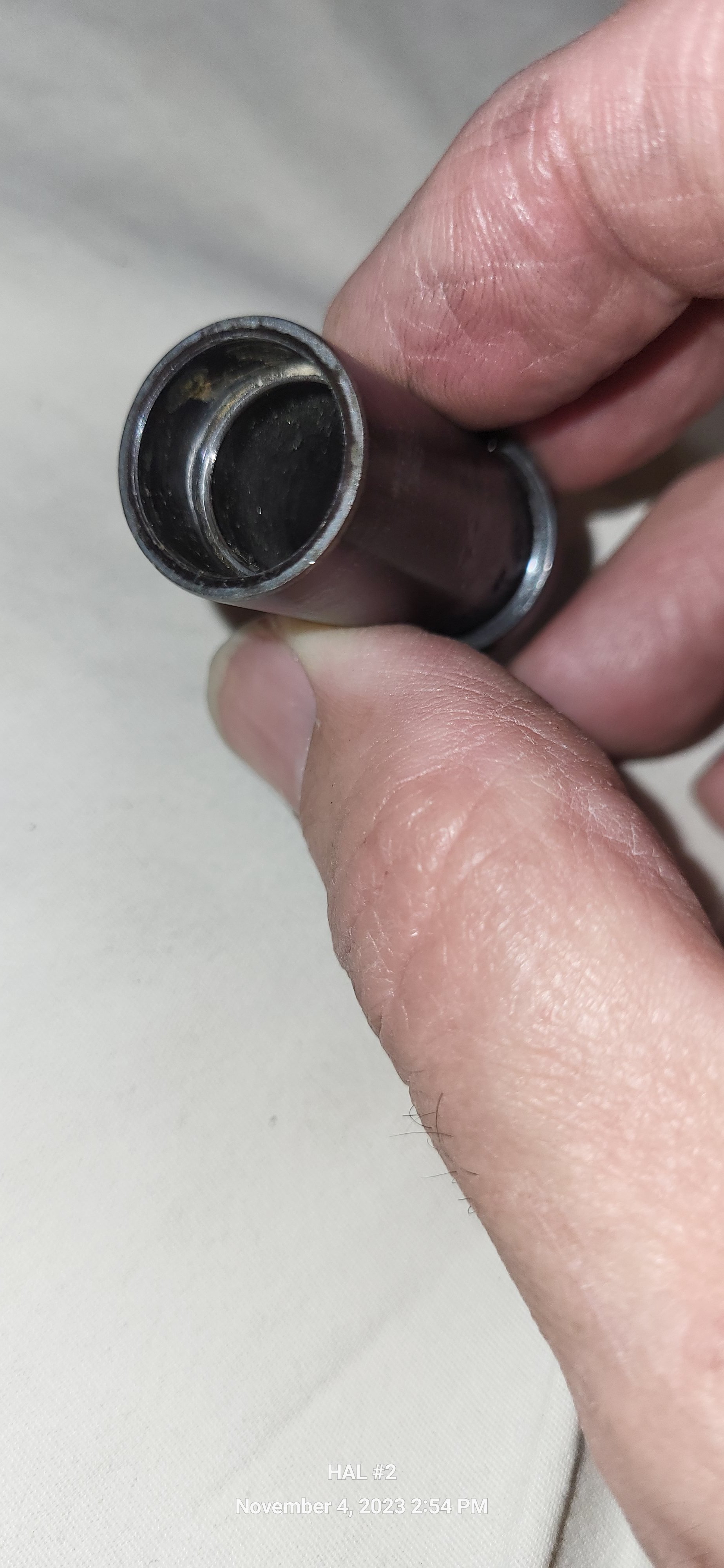

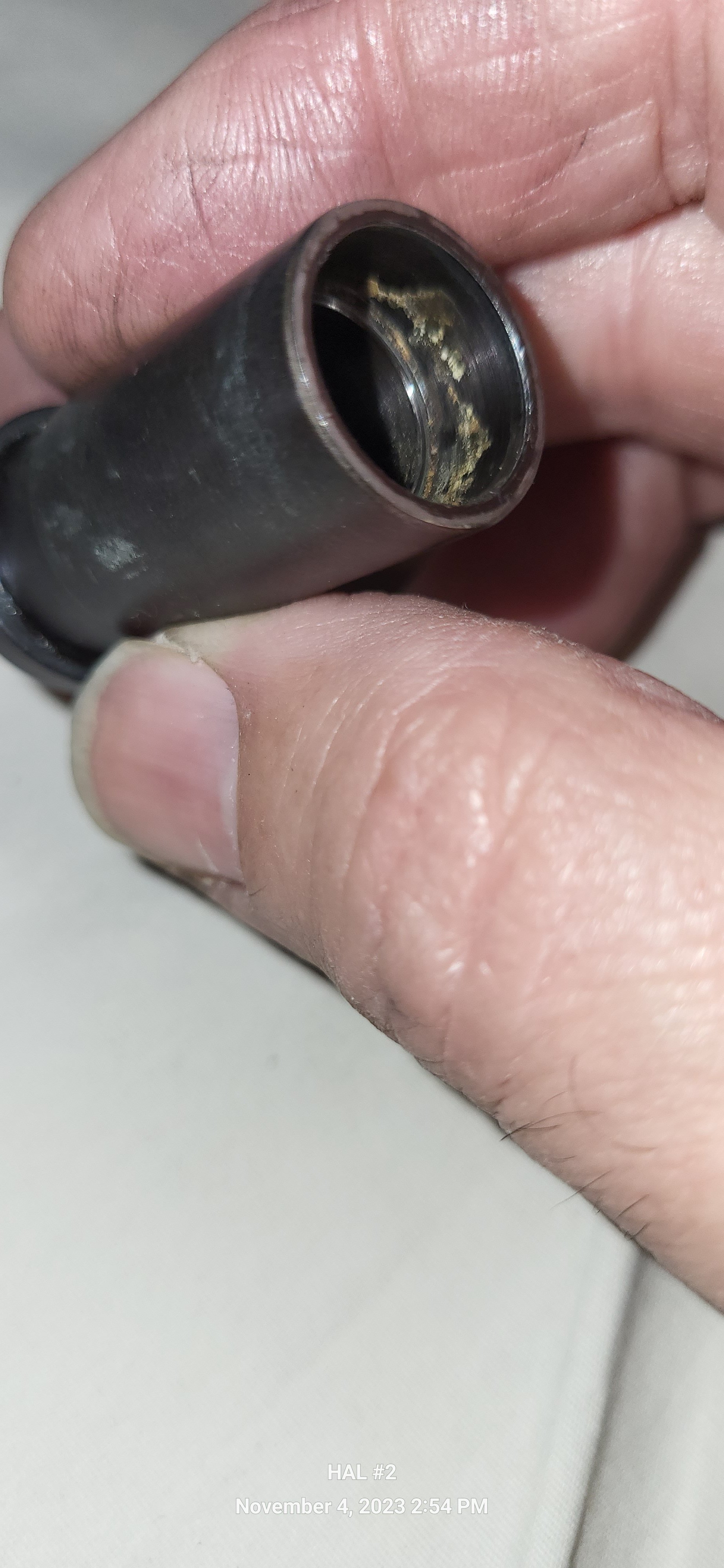

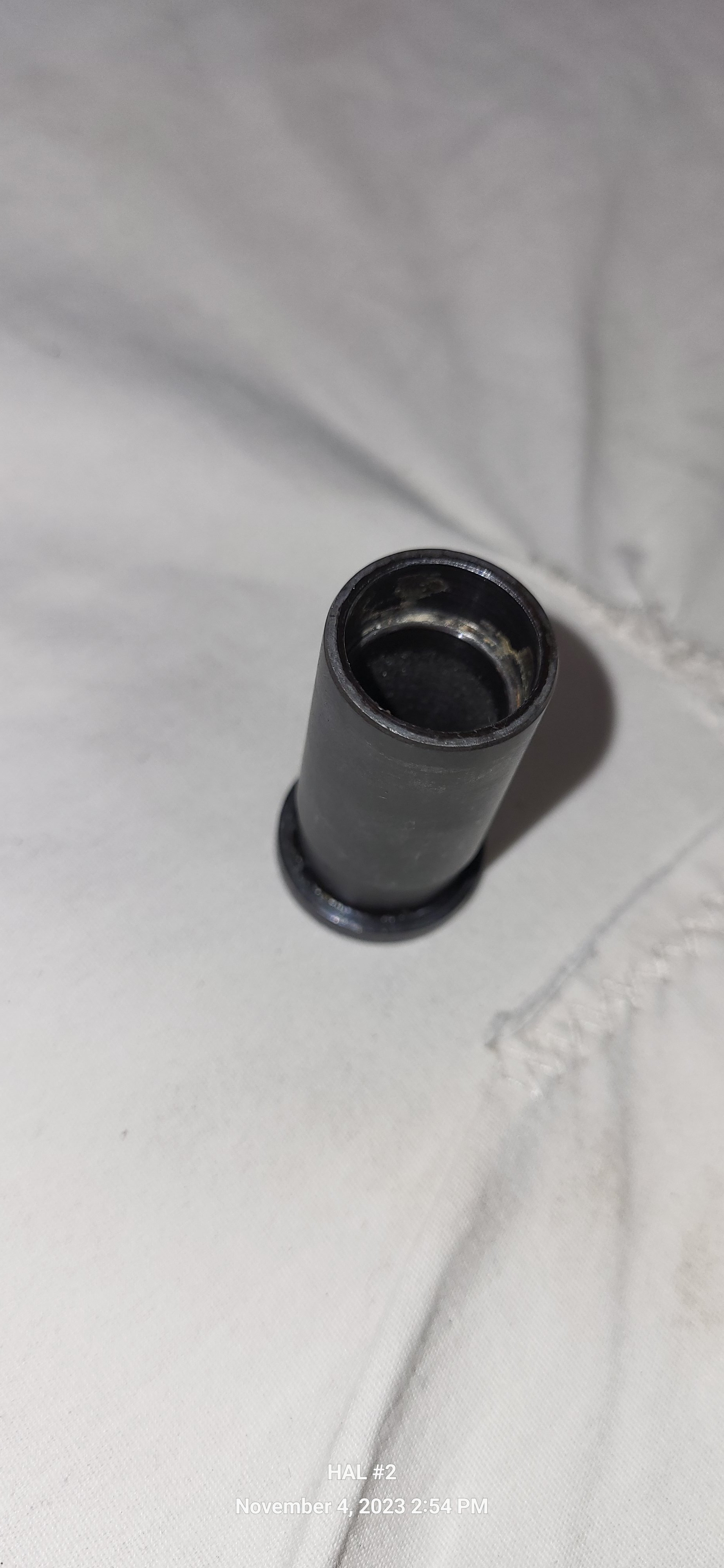

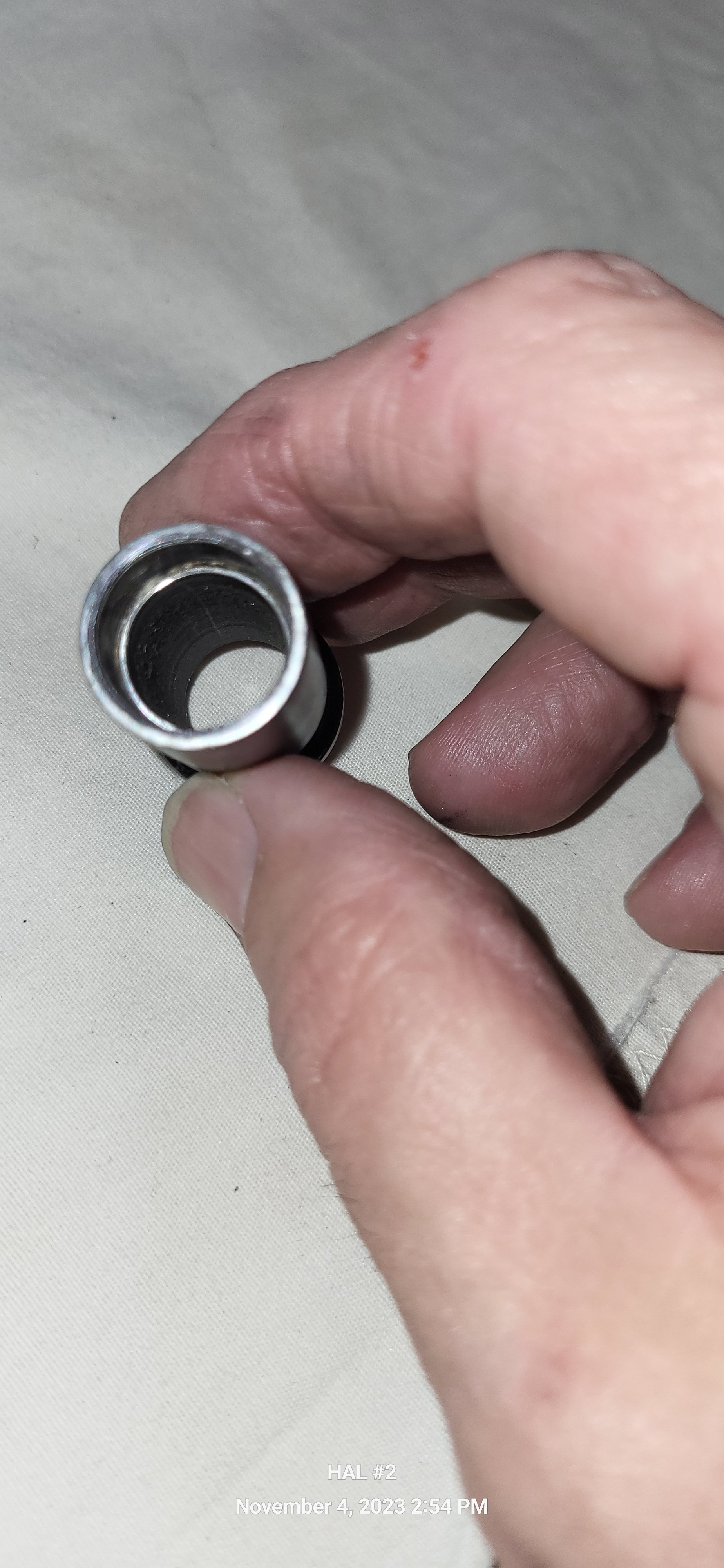

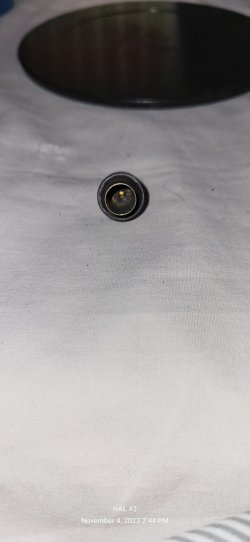

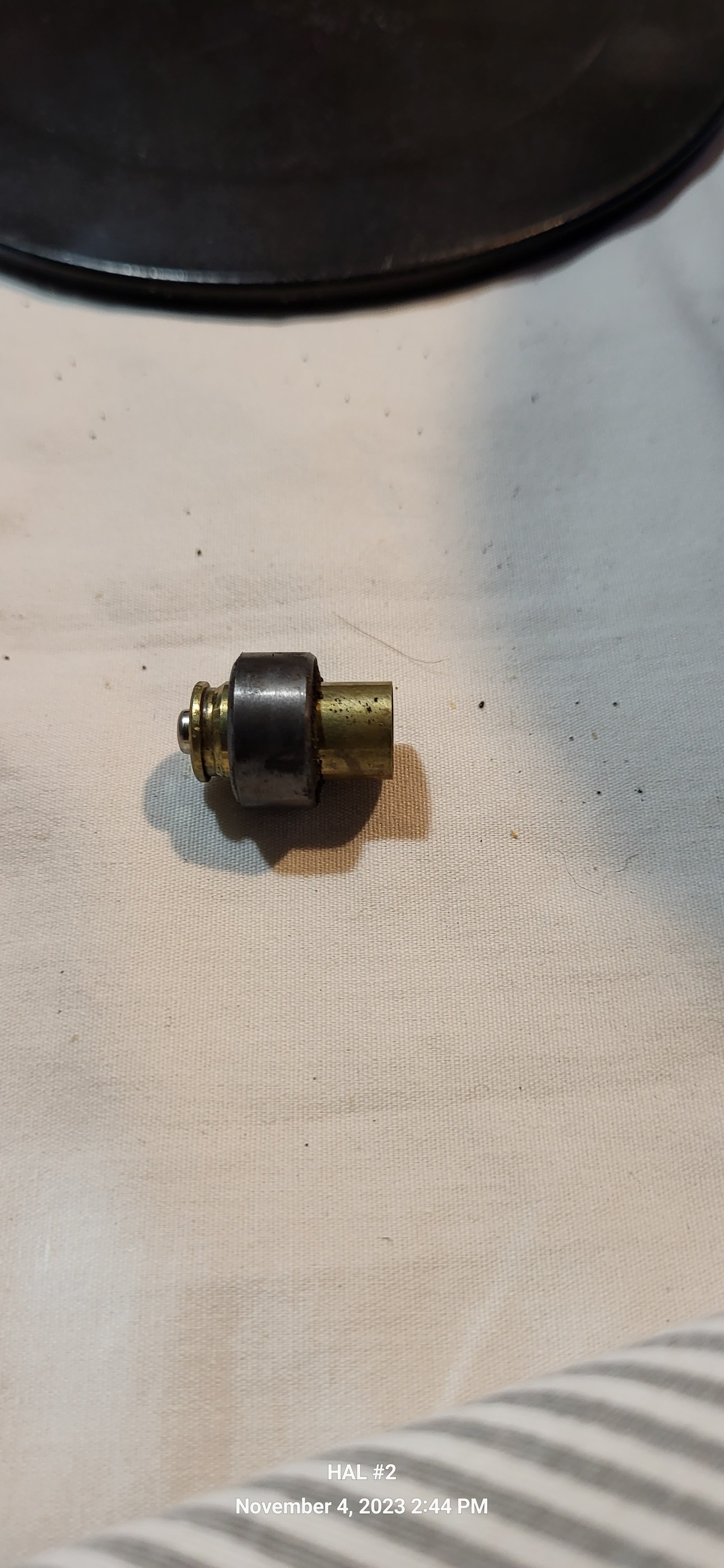

i was just about finished with running 400 9mm through the machine, i think i was at 389 or so and snap, it made a noise and i cycled handle up and the sizing die in stage one had separated and was clinging to a case, which of course was now cycled into the primer stage.
had to manually move the 2 ahead of it and then place them back in to finish the load sequence on these 2 and then try to figure out what the heck happened
of course the part i need is backordered, looks like i can clean it and put some lock tight in to hold the collar back in...monday i will call them and see if that is a suitable fix,

pretty sure the way the taper die is in the sleeve it can be red locktite back in place and get a new one on order

If red Loctite doesn't work, you still have two steps up the ladder that might.
1. Superglue (I prefer the Loctite brand for that, too--ask for it by name), or...
2. J-B Weld.

its a interference fit withing .002 so i am doing exactly as you mentioned, with one exception
red, if it fails, super glue and if that fails, wait on new on
plan to warm up the sleeve and freeze the insert
loctited the sleeve back in so i wait 24 to see if it holds
and will give dillion a ring in am to see about a replacement, which i sense will be productive and postive
dillion asked me to send back the die to be re locktite and crimped,
so i will hold onto it to use as a temp , until my new one arrives
it was funny knowing they hold insert in using exact same procedure i used to fix it .
