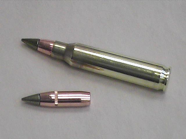

Evolution of the M855A1 Enhanced Performance Round
In post-combat surveys and field reports from Iraq and Afghanistan, most Soldiers have indicated that the M855 round works fine, delivering the desired effects against threat targets. But some Soldiers have reported that the round did not perform consistently, causing concern in the ammunition community.
The Army's solution is the new M855A1 Enhanced Performance Round (EPR).

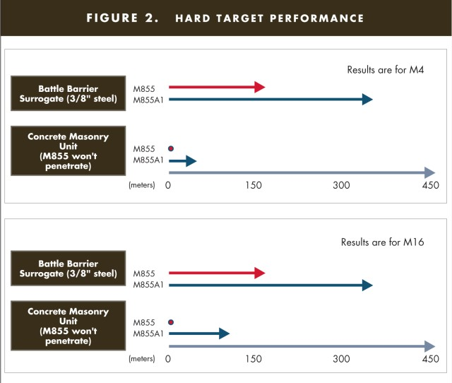

"Also notable is the EPR's excellent performance against softer intermediate barriers such as car doors, windshields, or Kevlar fabric. The thinner metal found on car doors poses no problem. When engaging targets behind windshields with the EPR, ARL has shown an increase in the probability of hitting the occupant, due to both the steel penetrator and the copper slug remaining intact through the glass."
kinda funny why this is stated (above quote from the article) as every fmj (no steel tip) i've shot into a vehicle went thru 1 door and out the other thanks to it being a HIGH VELOCITY round. i've even shot hp's that went completely thru a windshield and out the trunk on a 4 door vehicle. even hp pistol rounds went thru both doors. granted it was from a 44mag doing so.
Skimming through one of the articles I didn’t see this mentioned just typical “it’s improved performance” fluff Military and GOV agencies do. Supposedly the main reason the m855 a1 was adopted was environmental impact the Military is going through as it’s a lead free round

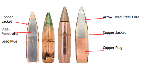

Shown above is a comparison of the M855, M856 Tracer, early M855A1 and the issue M855A1. The difference between the early and issue M855A1 projectile is the plug under the penetrator.
Looking at the cross sections you are able to see that both projectiles are made up of three components. The M855 (left) consists of a copper jacket, steel penetrator core and lead plug. The M855A1 (right) is manufactured from a copper jacket, steel arrow head core with a copper plug. The M855A1 projectile fit the Army requirement for a "green" projectile that does not have any lead.
