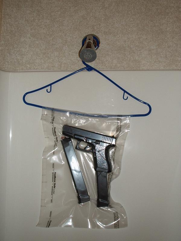

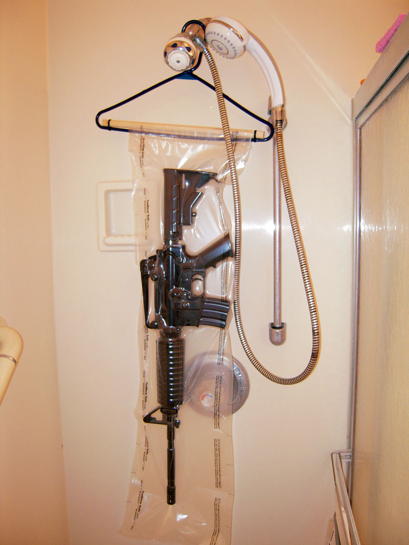

Alternatively, as @Talyn recommended, a sealing barrier should take care of things in a definitive manner (provided that the components are now free of rust and are dry/protected (possibly with desiccant added) when you insert the gun inside. If a bag is used, be sure to account for either your wet/soapy hands and/or surface condensation in your weapon-access plans.
