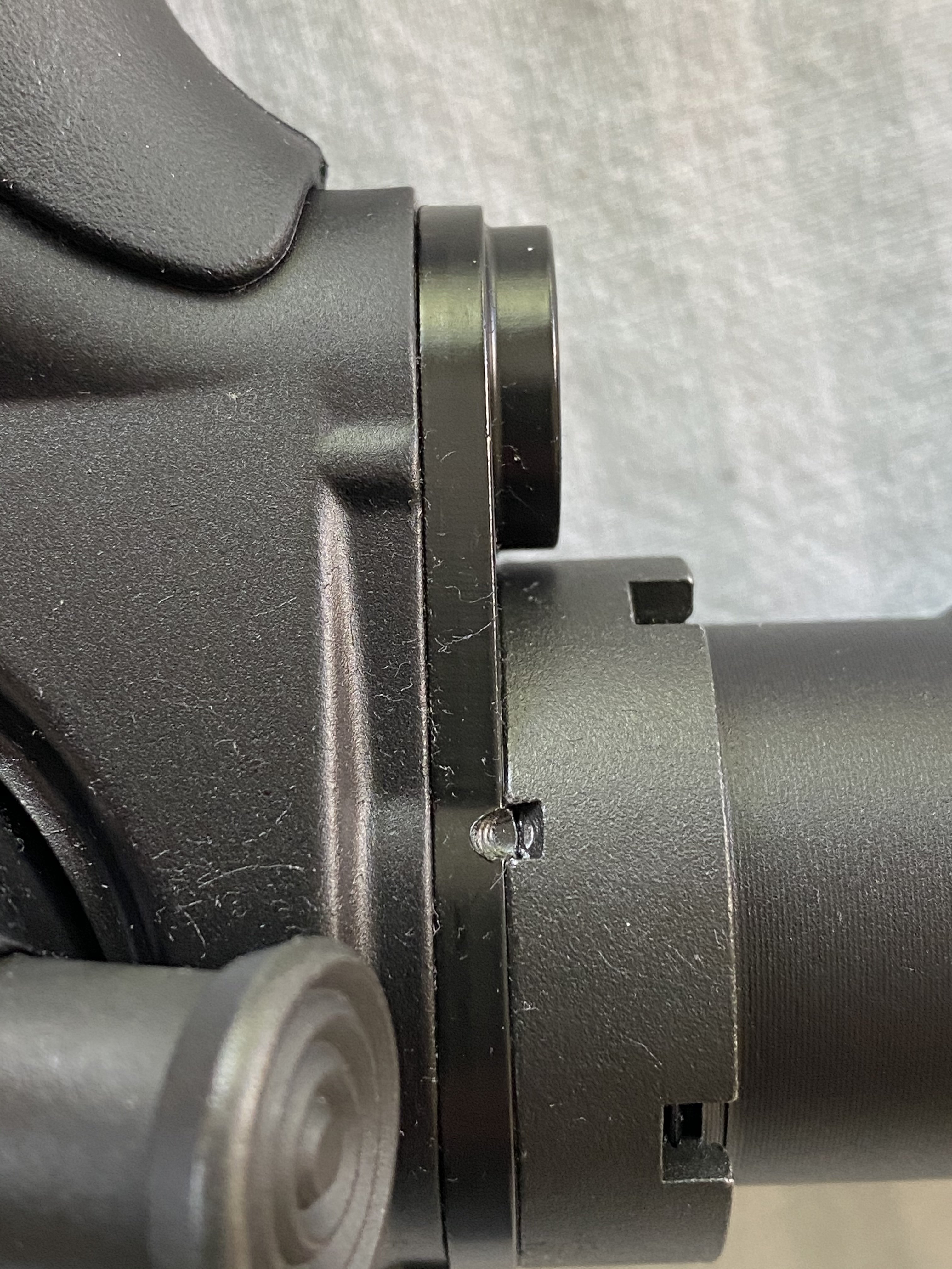

Is the nut staked? That is, is there a dimple that’s locking the nut to the end plate?
Yep, definitely staked. This is a good thing, btw. Keeps the nut from working loose.
I’d wait and get the tool, then...there’s also a few videos that show you how to get the castle nut off. Sometimes you can bust it loose with just the wrench, but sometimes not.
I’m going to search for the wrench locally first if not found I’ll order it from Brownells.
It does looked staked but the metal punched over does not look very thick.
