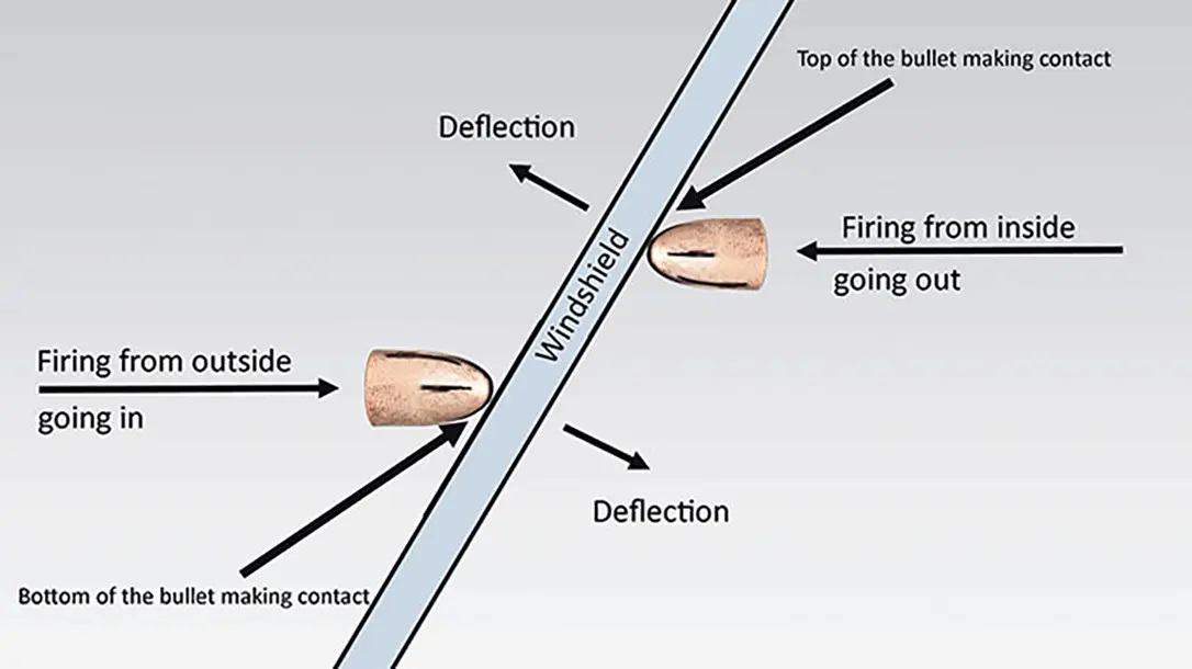

Shooting Through Glass – Aim Lower Shooting Inside to Out
The laws of physics dictate that any sufficient contact with a bullet in flight will change that bullet’s trajectory. This is the case with glass. Many factors go into the effects of glass penetration on a bullet, but a few are simple. The angle of the glass in relation to the shooter is the biggest factor in determining the impact of the round on the target
