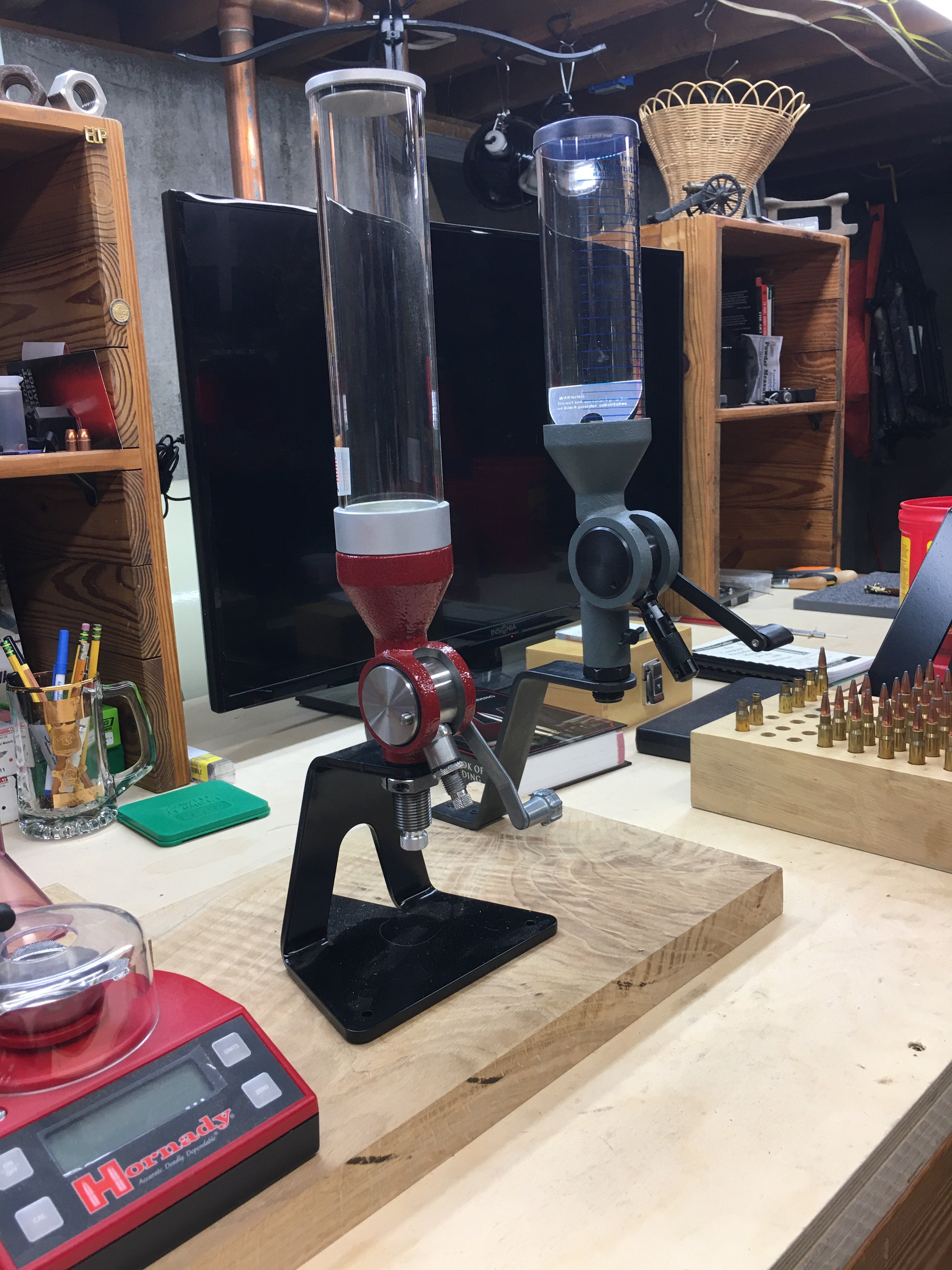

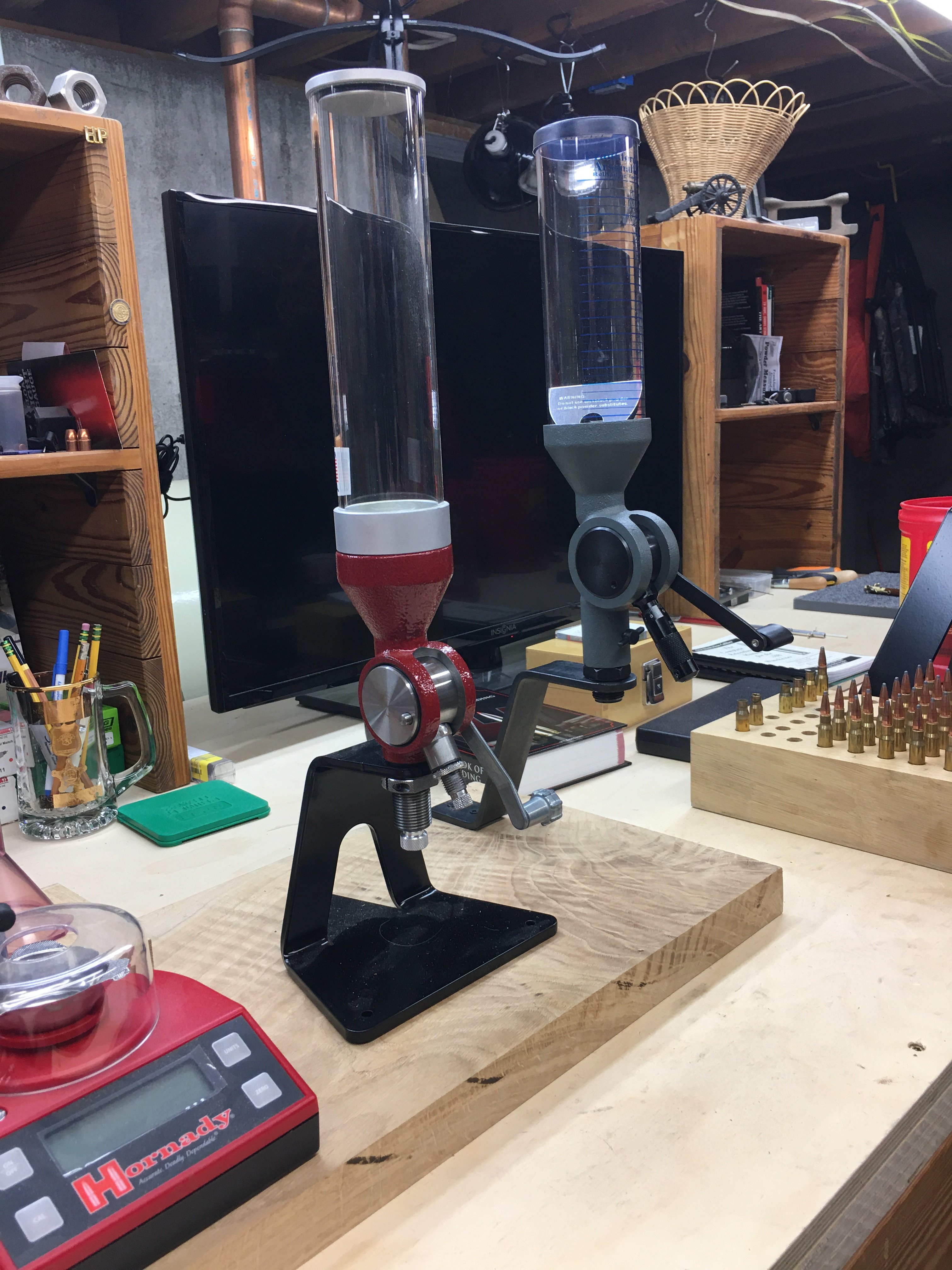

I’m new to M1A. Been loading for my Ruger 308 scout. Been very happy with Varget. Till now my bench was dedicated to the Ruger. Now I have a set of dies that will be exclusive the M1A Scout Squad. I also have two powder measures, one for Varget and other for H4895.
The fun continues
The fun continues View attachment 14066
Hopefully your basement is dry and static free?
