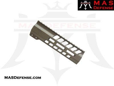

This suggestion may not have turned out to be bad! :) Just looked again for the 300 BLK and found this. I will certainly make it easier to change out. I’m sure the mounting system will be the same since they are both from MAS Defense. At least I would hope so.

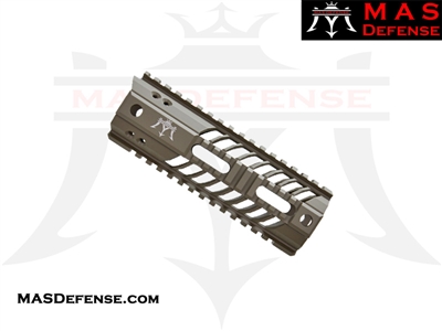

Here’s the one I have on there now. It just feels too fat to me. Looking for something a little more streamlined and thin and I think the one above may just fit the bill.
