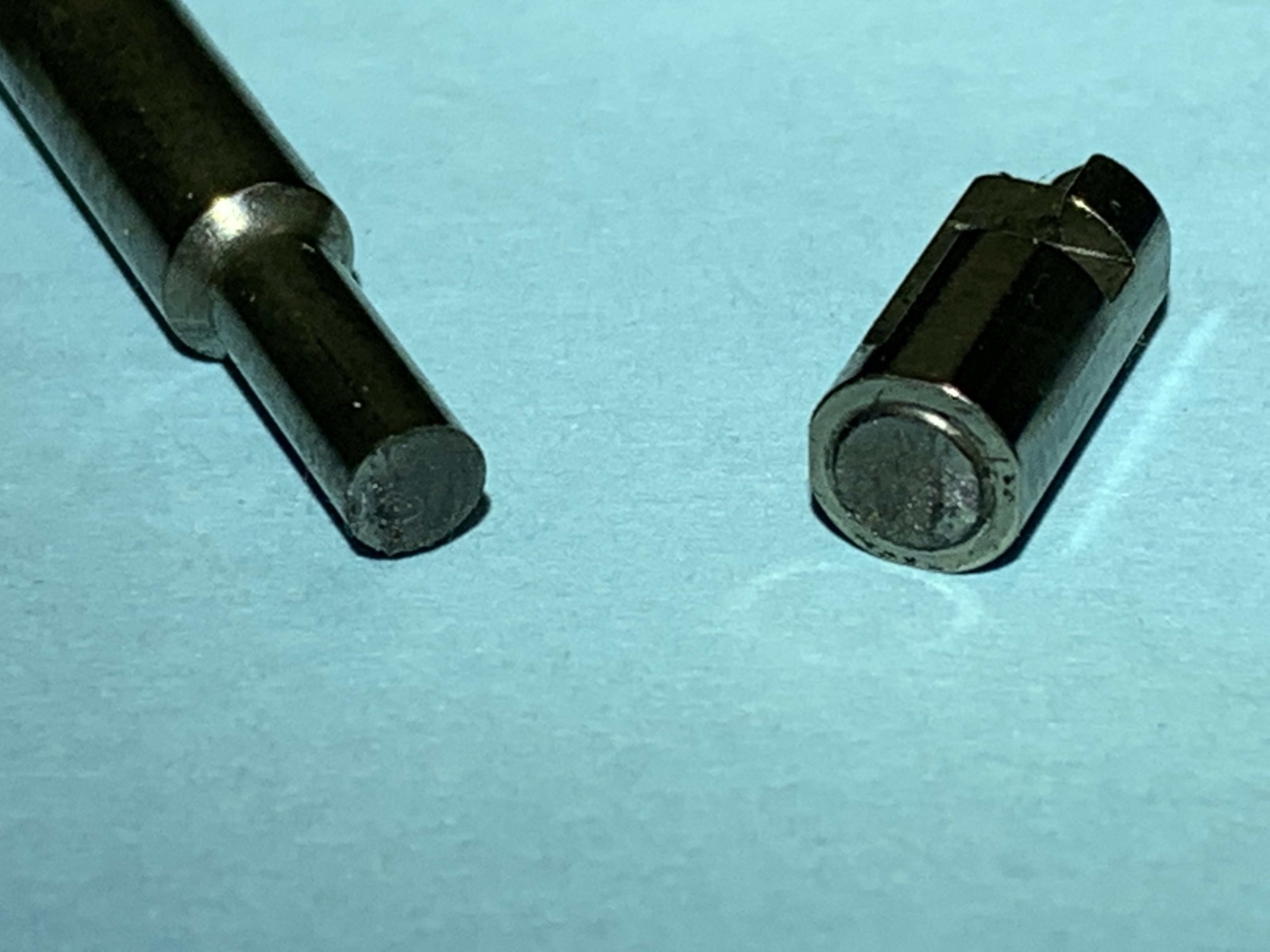

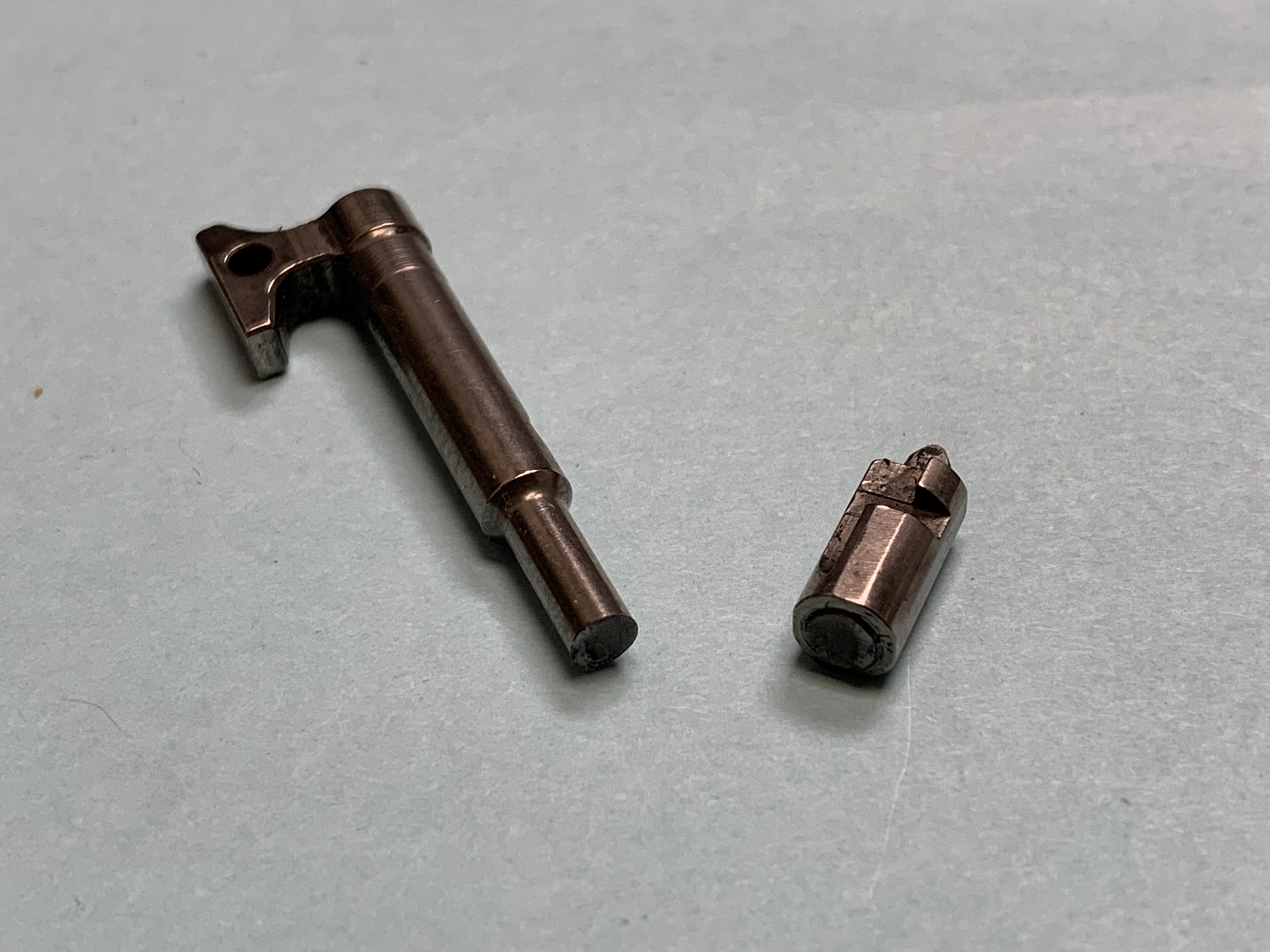

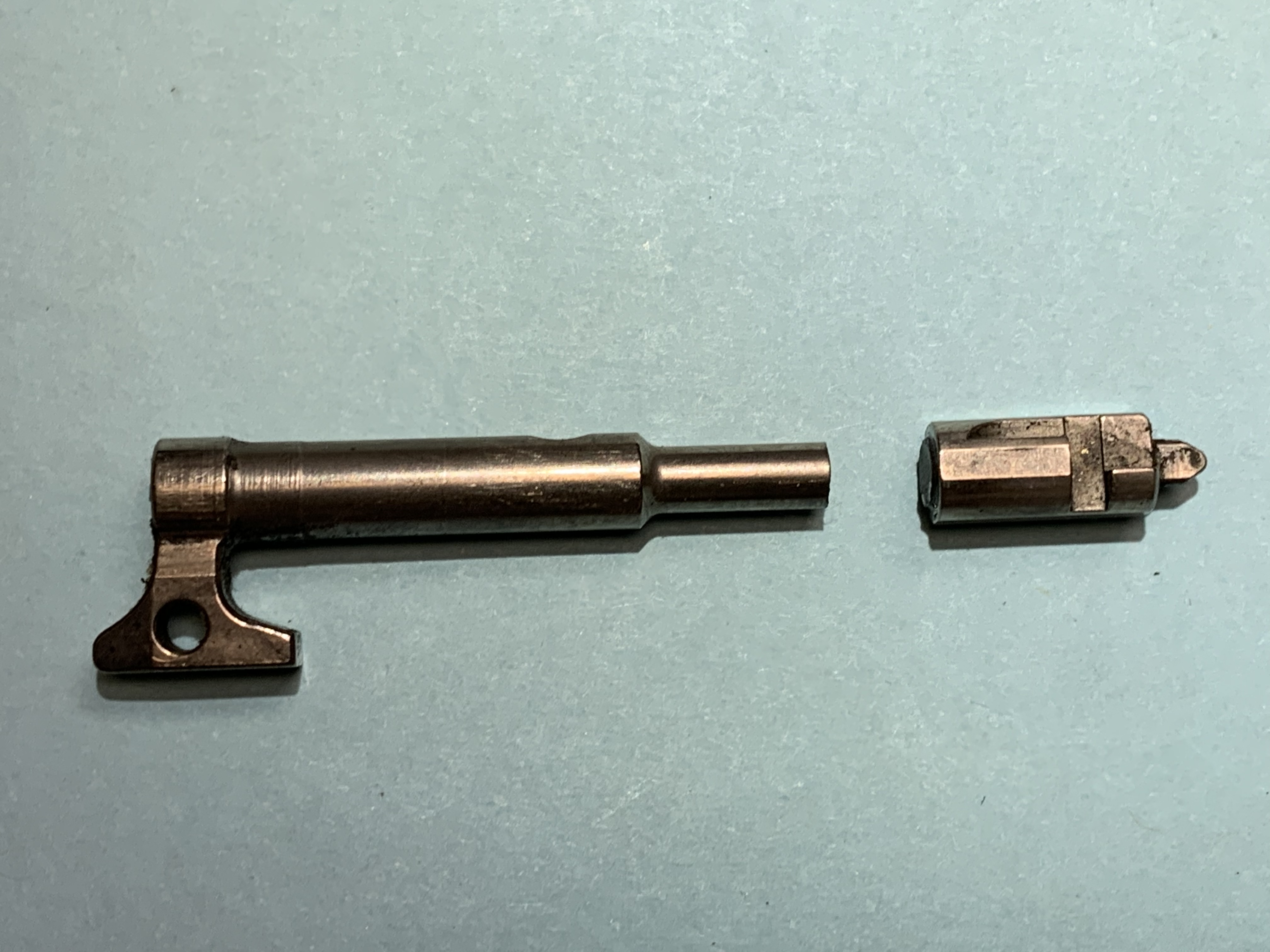

I just had a striker break on me while using an ELMS laser training cartridge. When I reached out to SA about it, they didn’t offer to replace the striker under warranty, but were willing to send me one if I paid for it. Apparently, they don’t warrant striker failures if you admit to using a laser trainer. I purchased a 17-4 LSPI replacement instead, figuring that would be more durable than the Ni-plated M.I.M. original.
No, the whole gun is warranted, period, did you call them? That’s really no difference then using snap caps if you ask me…..weird….if this is true, makes me wonder about how good there warranty is actually.

No, you don’t need snap caps to disassemble the gun and I didn’t say you did, he was using a laser training aid and the striker broke, he stated Springfield wouldn’t warrant it since he used the laser training aid, I said the laser is the same as using a snap cap, and the striker should be warranted, no Joe, you did nothing wrong
