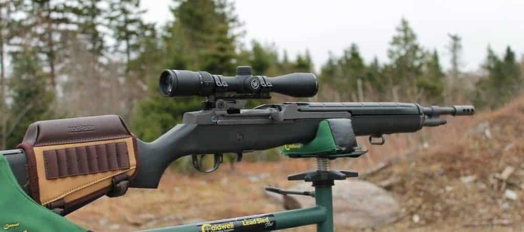

I use the LSP from m14ebr.us

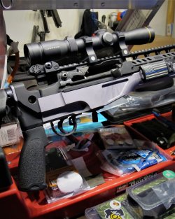

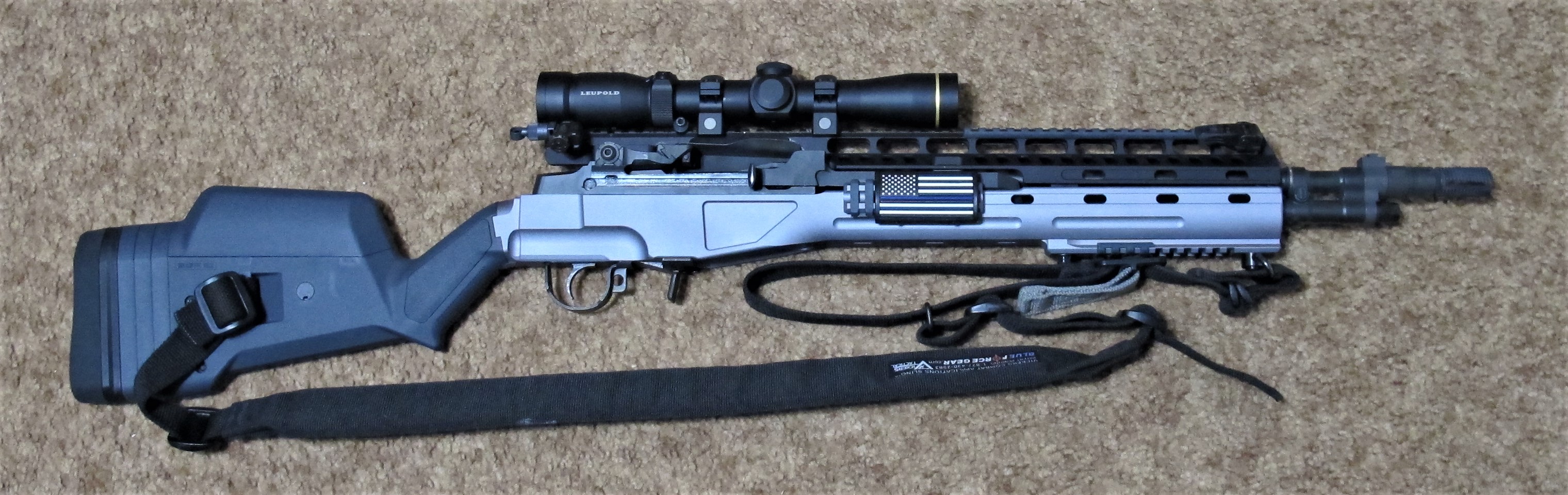

I mostly use Blackfeather RS chassis, and it works with all standard wood & synthetic stocks.
