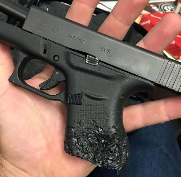

Just don’t ever use brake clean on a polymer gun

When I was working at my sheriffs dept, a deputy decided to use brake clean on his S&W polymer pistol, frame got somewhat sticky and kind of melting like, needless to say, ruined that pistol

Yea, brake clean for cars, not the break free CLP, also the original Gunscrubber will eat polymer, that’s why Birchewood Casey made a synthetic safe cleaner

Brake Clean is a solvent that is generally used as a parts cleaner and degreaser. I use it to clean steel before bluing. He definitely wasn't referring to Break Free.
