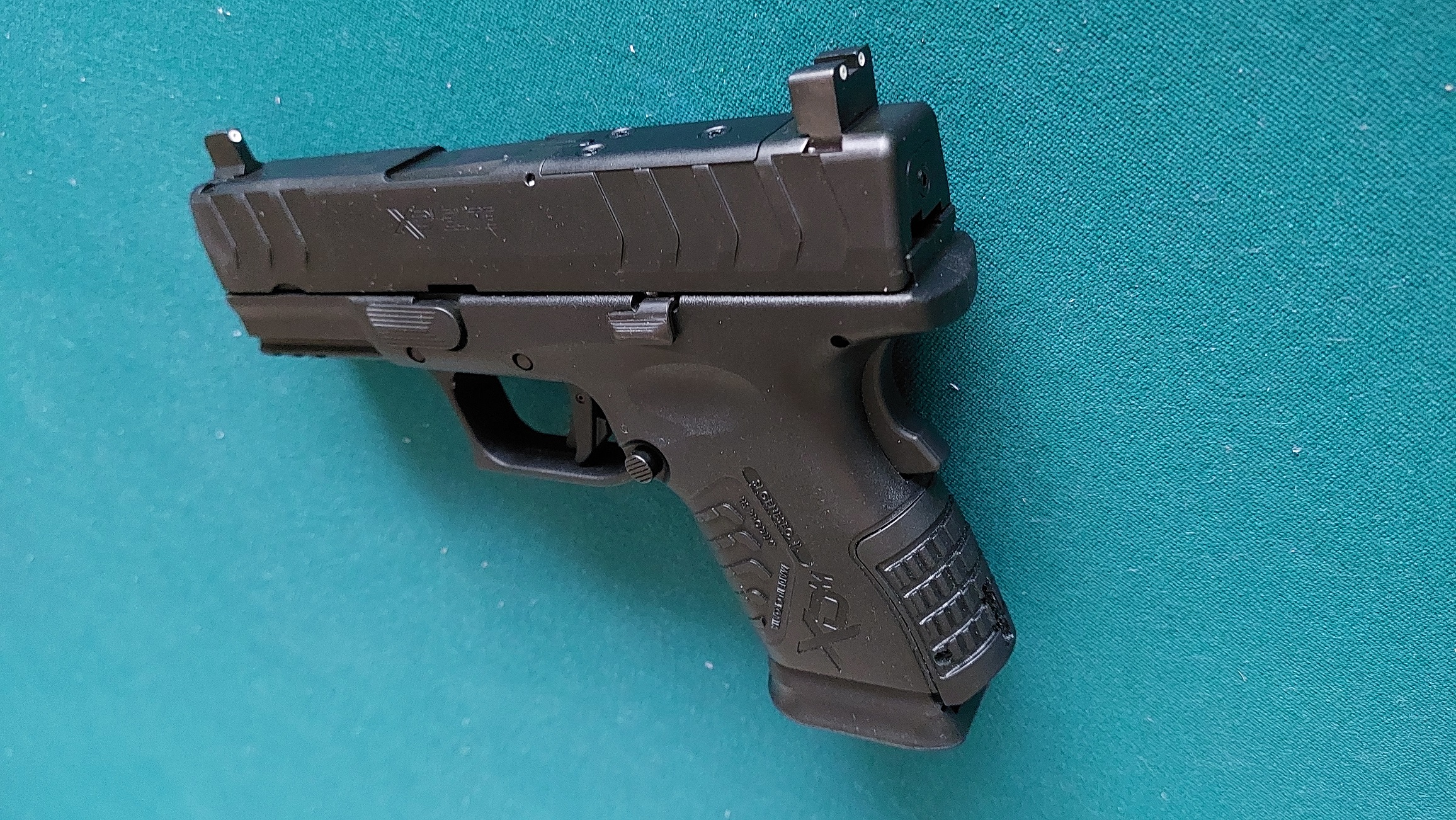

I just installed Trijicon tritium suppressor height sights on my SA XDm elite 10mm compact.
My gunsmith did not have any issues to install.
I was thinking about Night Fusion sights but I know nothing about them or anyone else who knows anything else about them. They look nice and should fit but I do not know anything about the quality of their tritium sights?
I was thinking about Night Fusion sights but I know nothing about them or anyone else who knows anything else about them. They look nice and should fit but I do not know anything about the quality of their tritium sights?View attachment 38609
