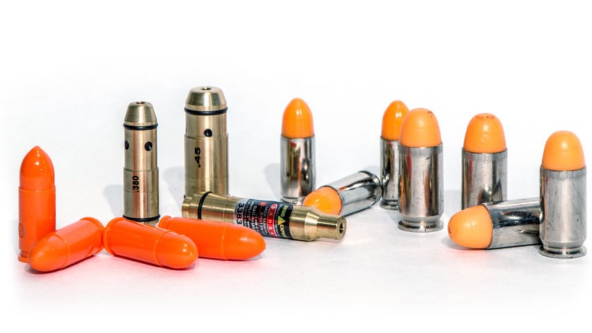

I don't have a Hellcat so take this with a grain of salt. I went back and forth with Springfield on dry firing an XDe. All over the internet, there are folks saying you can't harm a modern centerfire by dry firing. The person I was emailing back and forth went to engineering to ask them. They basically said what you have surmised: If you are planning to do a lot (no definition for a lot) of dry firing, you should use snap caps. I like to err on the side of caution, so I ordered snap caps and use them anytime I am dry firing. My question now is how long can you use an individual snap cap (I like A Zoom) before it is "worn out," and how can you tell when you should order new ones? By the way, they are not very expensive.
I don't repeatedly dryfire ANY centerfire handgun without a snap cap. Despite being more robust than a rimfire - they ALL have issues if you do it enough. It's the ultimate in cheap insurance - I don't know why you'd insist on doing it without one.
For context - I dryfire every day for 20-40 minutes. This regimin in the past broke parts on CZ firing pin block models in about a week. They're "Safe to dryfire" according to the manufacturer. A few times here and there aren't going to break the gun - but if you use dryfire as a form of practice - you will break your gun with enough volume.
If you get honest about a gun - it's got a bunch of springs - the springs fatigue with use - whether in livefire or dryfire. Using a snap cap reduces the travel of the firing pin - likely staving off some of the wear on the spring it'd have otherwise.
Now - more than ever - I modify dryfire to minimize the wear on the firing pin - keeping a dead trigger on an XDME or keeping the trigger cocked - but only prepping the trigger to fire in dryfire and not going all the way with the press. On DASA guns I will pull through the one double action pull then simulate single action. On SAO guns - the hammer falls once and then you just simulate trigger presses on a dead trigger.

I think this is your answer ...... anything mechanical is subject to breaking at some point in time from over use, mistreatment, poor maintenance, improper use, and many other reasons. I think you hit it on the head along with Anni when you posted this from the text of the owners/users manual: "NOTE: Extensive dry firing can accelerate component wear/stress. Use snap caps if dry firing on a regular basis." I think "Extensive" is the key word and wouldn't think the times you have to dry fire to disassemble the firearm would generally cause a problem, otherwise the design would have been different.
Those who might sit around and play with the gun and continually dry fire are the ones most likely to have an issue. But that's not a fault with the gun, it's simply a case of over use and/or abuse. Get some 'snap caps' and use them if you're going to practice with any amount of dry firing, but if you're just disassembling it for routine cleaning, I don't think there's anything to worry about. Enjoy your gun! (y)(y)(y)
