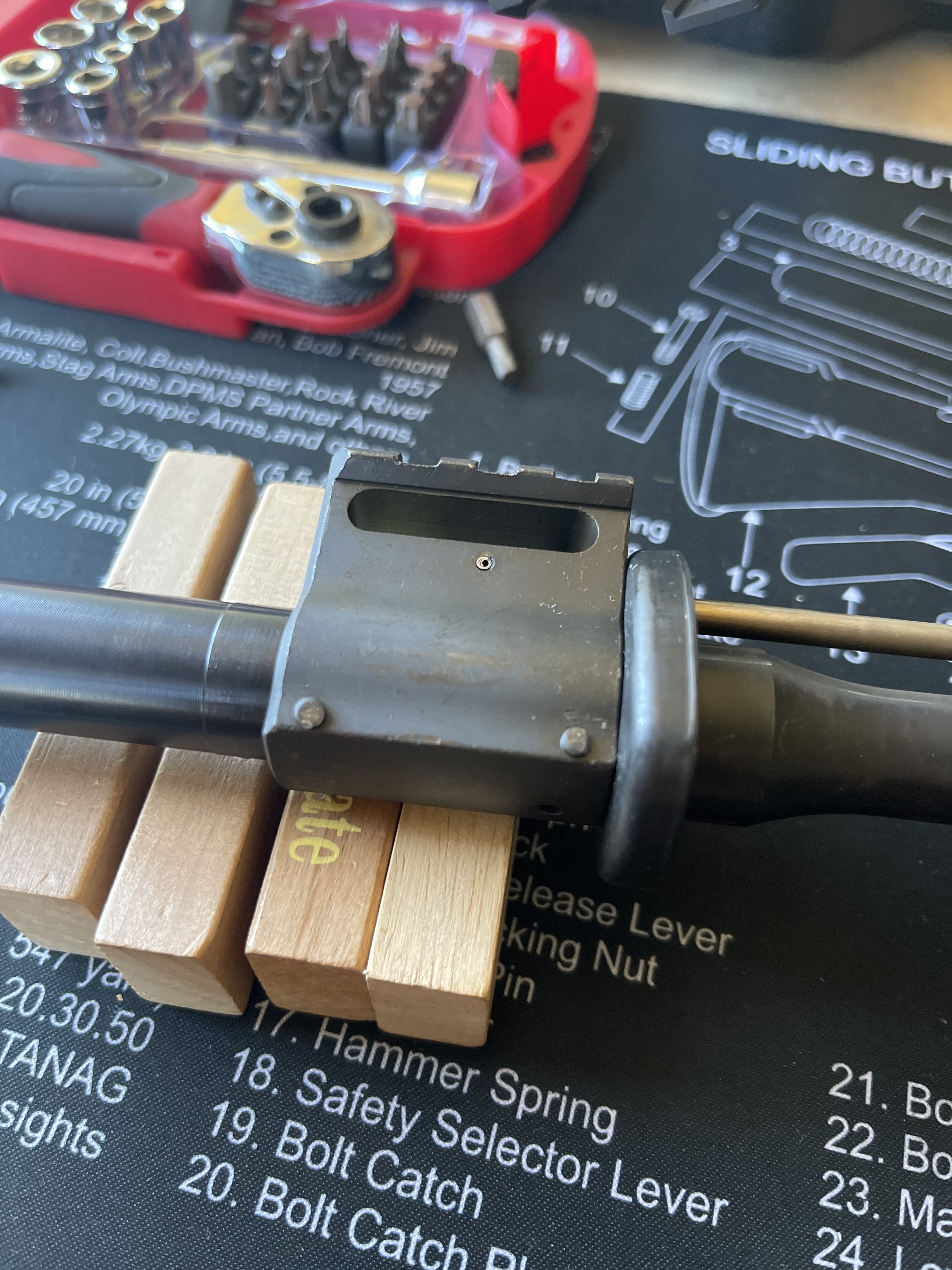

Thought I could easily upgrade my hand guard but have not been able to remove the pins in the gas block. Anyone have any success with this and if so, how did you do it? I’ve watched a bunch of vids on YouTube but haven’t had any luck.

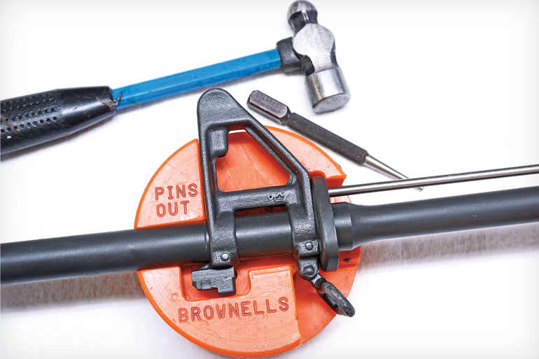

-Need a great set of armorers punches
- AR15 block preferred but not necessary
- rubber mallet to “nudge” the A sight off after all the pins out

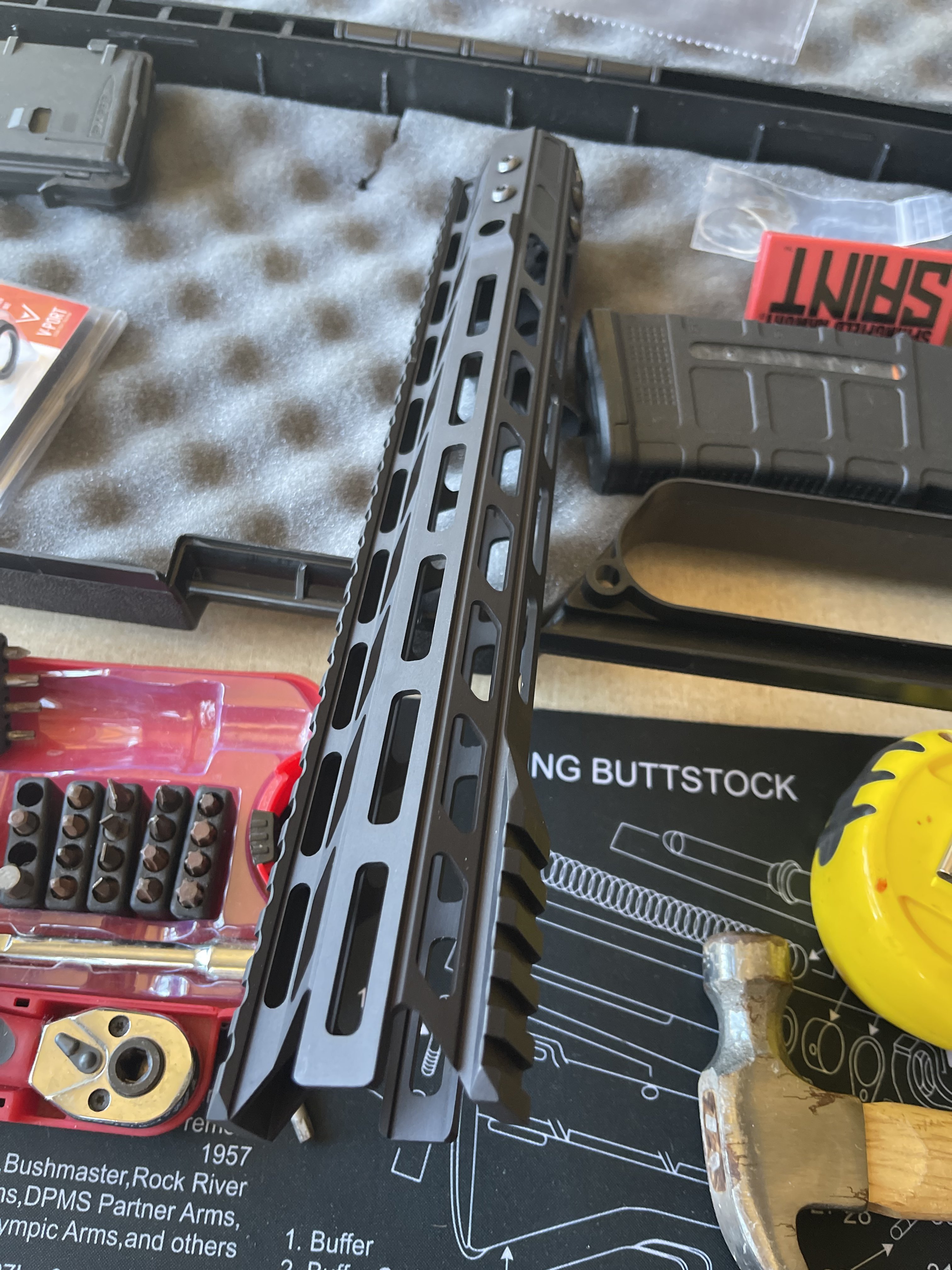

Thank you. Wanted to swap stock hand guard out for a free float and didnt know I’d need to also swap the existing fixed gas block for a low profile gas block.
Sorry for the confusion.

Are they tapered pins ? Check and see if they are smaller on one side.
They are tapered and are removed like any milspec pins. Left to right, easiest to remember that the pins eject out of the gas block the same direction as your spent brass ejects.
You need the proper tools and techniques, things like a ball peen hammer, oversized punch. A very stable bench, with a block or holder. When you just lay the barrel on some wood like the op did. When you hit the pins, nothing is keeping the barrel from moving minimizing the transfer of force into the pins. The more the barrel can move it acts like a spring and dampens your work. You can also do what the pros do and your a press to push them out and be done with it.
