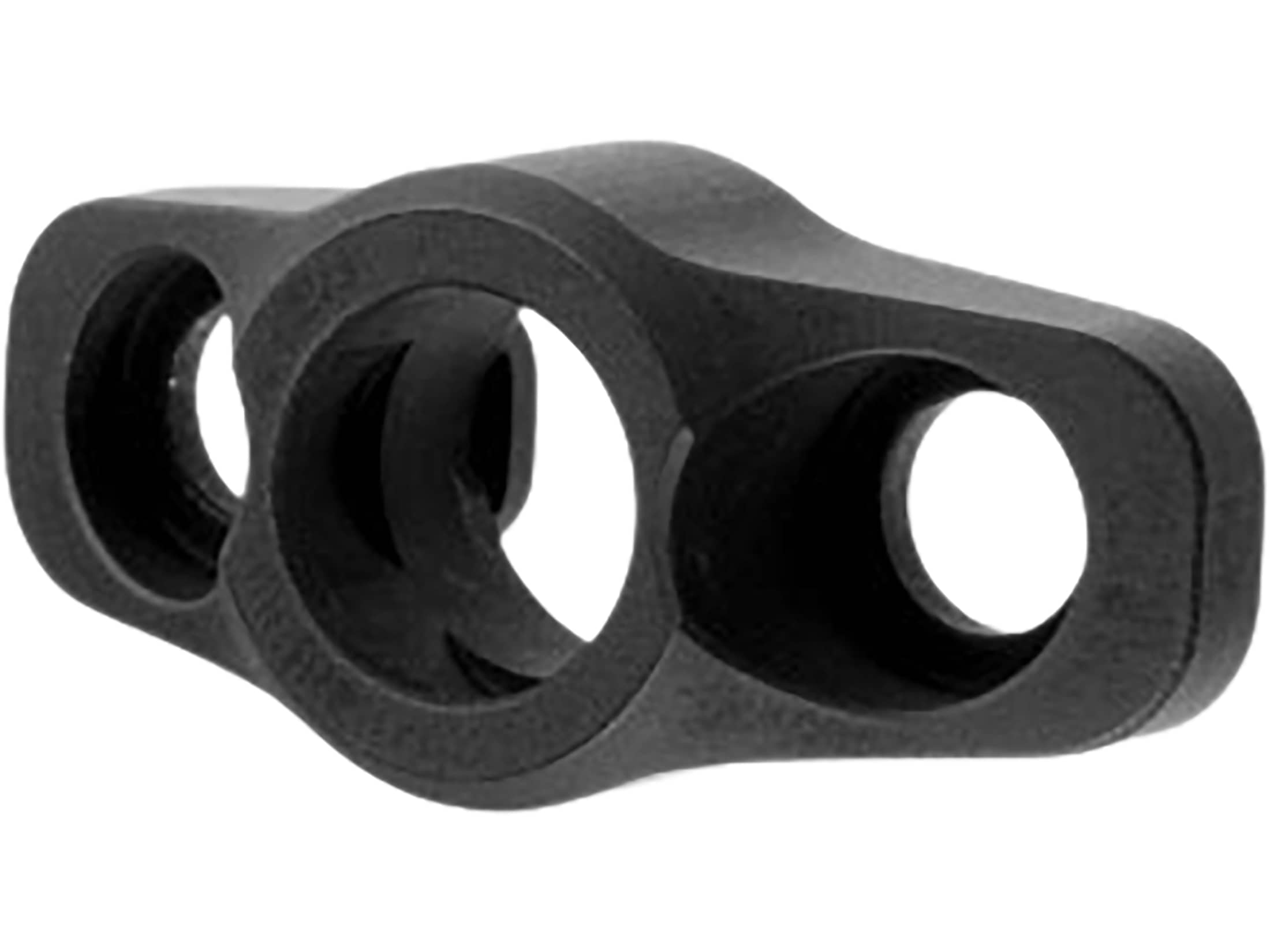

I bought a Magpul Sling when I bought the Rifle; but the Saint doesn't allow me to by default put the sling on it except at the front of the barrel; and it gets heavy after walking for miles.
You can buy an MLOK sling adapter to mount it closer to the receiver.

The square locks keep rotating as I get them closer to the point where I need them to stay still or it screws it all up; I've tried to install pictanny rails and I'm about just short of paying a gunsmith to install the rails for me; which to be honest will be quite embarassing since I want to built my next rifle.
Ehh don't be embarrassed these things take experience to get them right which comes with repetition and time.
Here's an easy way for you to try.
Have the square locks extended an equal distance up on the screw then give them a quarter turn after you push the mount into the handguard. Once they are turned pull down on the mount and keep the pulling pressure while taking turns going back and forth between the screws equally alternating tightening one twist at a time.
