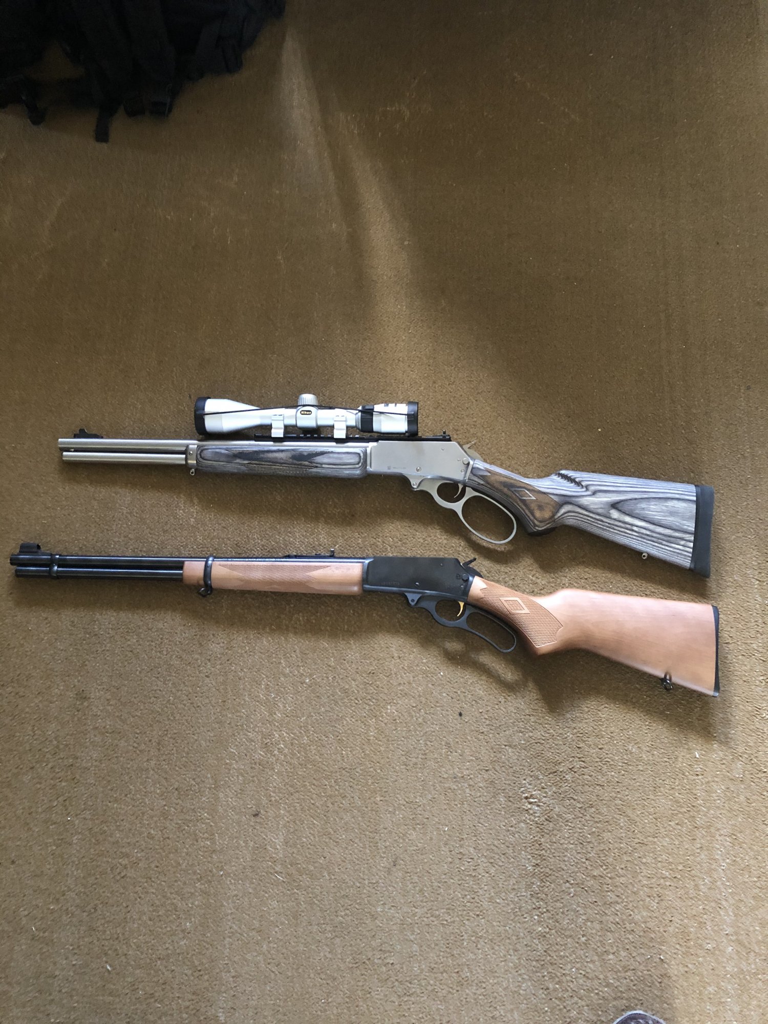

Two beautiful rifles.
I love the look of Black Laminate Pistol Grip Stock. Do you know what year that was made?
Well Keystone19250, according to research done on the internet, My serial Number starts with MR, indicating it's a Remington Marlin (who started producing Marlins in 2010). The code on the left hand side of barrel near the receiver is KM. K=May, M=2018. Hence, as far as I know, the rifle's production date was May 2018. I found this information from a Marlin forum from a poster's response to finding Marlin production dates for those made by Remington. I include his post below (I deleted photo attachments since they required login to forum to display):

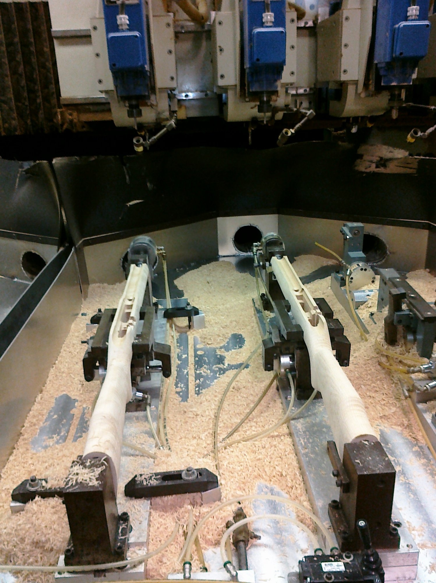

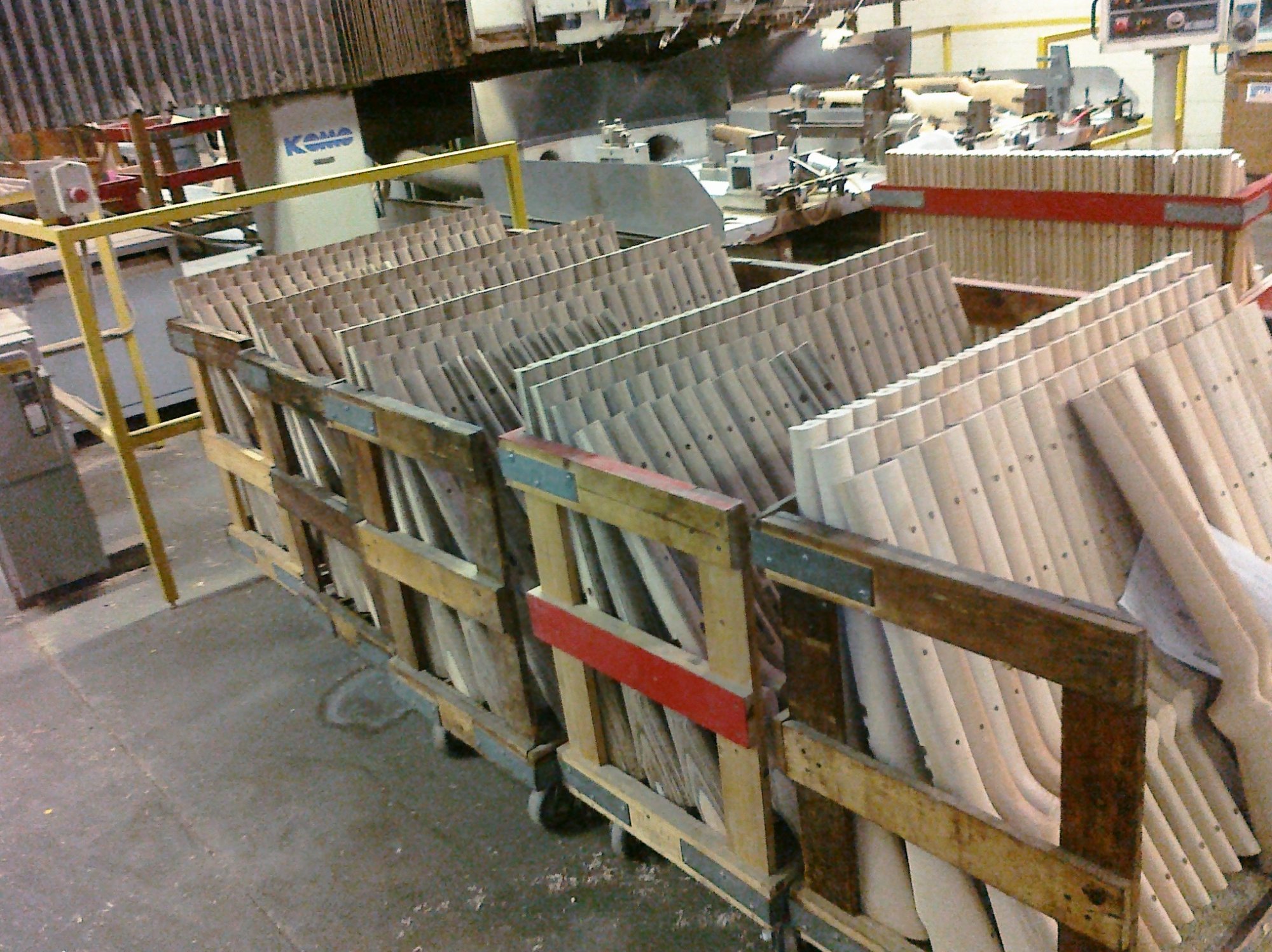

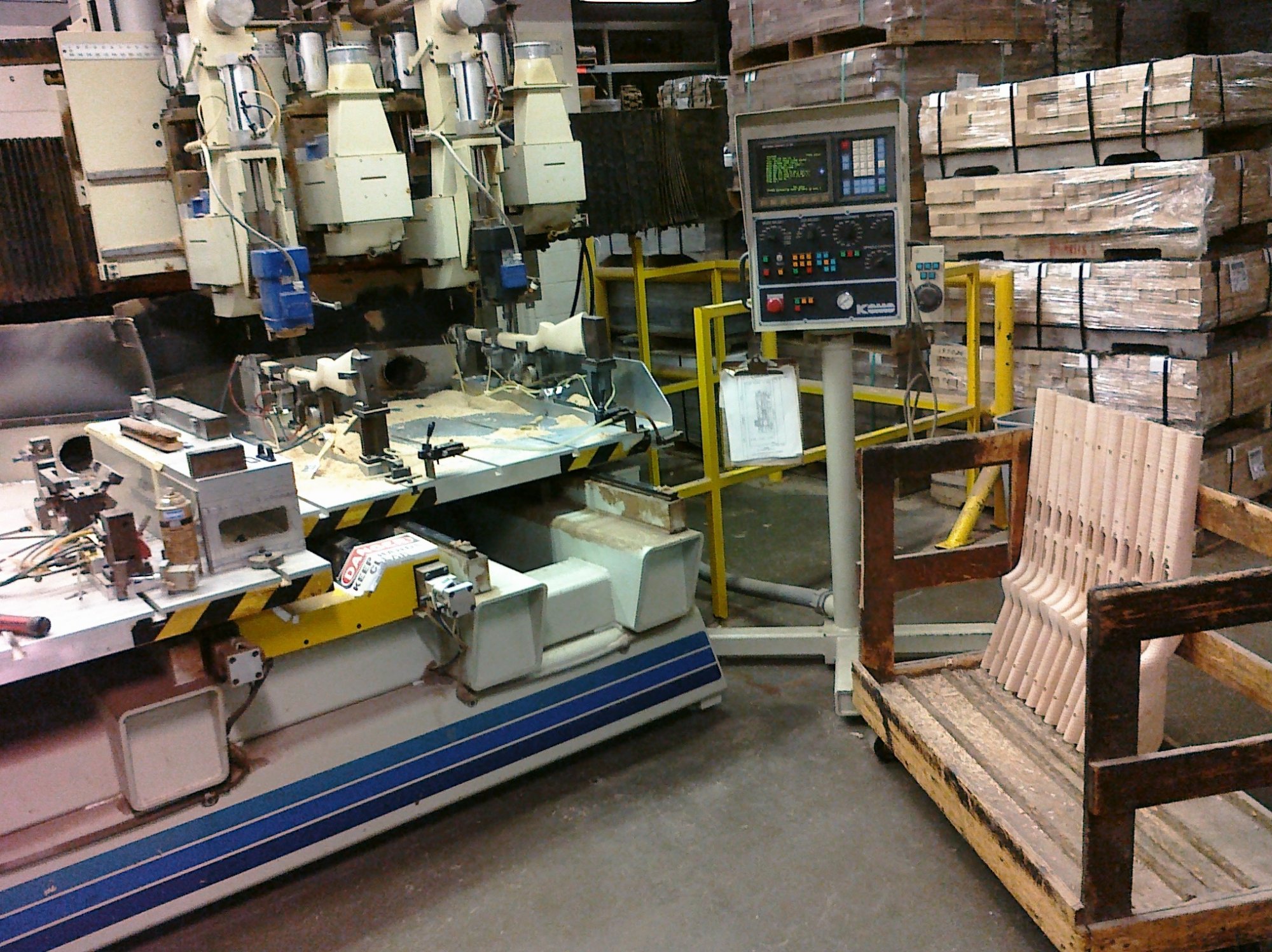

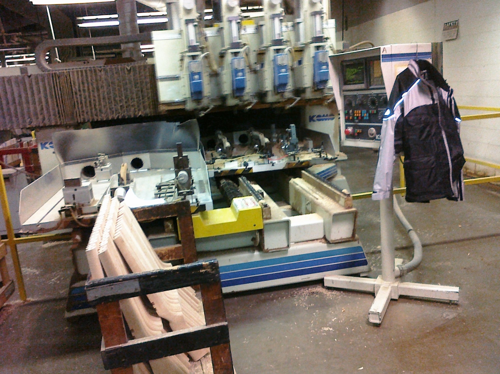

Thank you BET7 I’ve posted before my feelings on Remington however I’m sure the lever action rifle you have is terrific since wether it was made by Marlin or Remington it is based on the Marlin design. The reason I asked the question was while I worked for Marlin from 1995 to 2010 it was during that time when Marlin started making gun stocks using laminated wood. I believe if memory serves me around 2003. It started with the lever guns then eventually we started getting blanks for the model 60 semi 22’s and then our bolt action guns. I was running the CNC machining CTR’s machining the action cuts into the wood blanks and was instrumental in helping engineering develop tooling to cut laminate wood which is much different the solid wood blanks. The picture below shows stocks in line for machining the action. There is one “Truck” of solid wood birch blanks, two of black laminate and two of brown laminate. The other pictures are of the machining CTR’s I ran.

Thank you BET7 I’ve posted before my feelings on Remington however I’m sure the lever action rifle you have is terrific since wether it was made by Marlin or Remington it is based on the Marlin design. The reason I asked the question was while I worked for Marlin from 1995 to 2010 it was during that time when Marlin started making gun stocks using laminated wood. I believe if memory serves me around 2003. It started with the lever guns then eventually we started getting blanks for the model 60 semi 22’s and then our bolt action guns. I was running the CNC machining CTR’s machining the action cuts into the wood blanks and was instrumental in helping engineering develop tooling to cut laminate wood which is much different the solid wood blanks. The picture below shows stocks in line for machining the action. There is one “Truck” of solid wood birch blanks, two of black laminate and two of brown laminate. The other pictures are of the machining CTR’s I ran. View attachment 4310View attachment 4311View attachment 4312View attachment 4313
Nice pictures of the factory, I really like seeing how firearms are manufactured, thanks for sharing.
