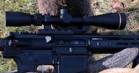

I put a 3 to 9 Leupold scope on my Saint about 4 years ago. I only use it about 3 weeks out of the year to hunt deer.
