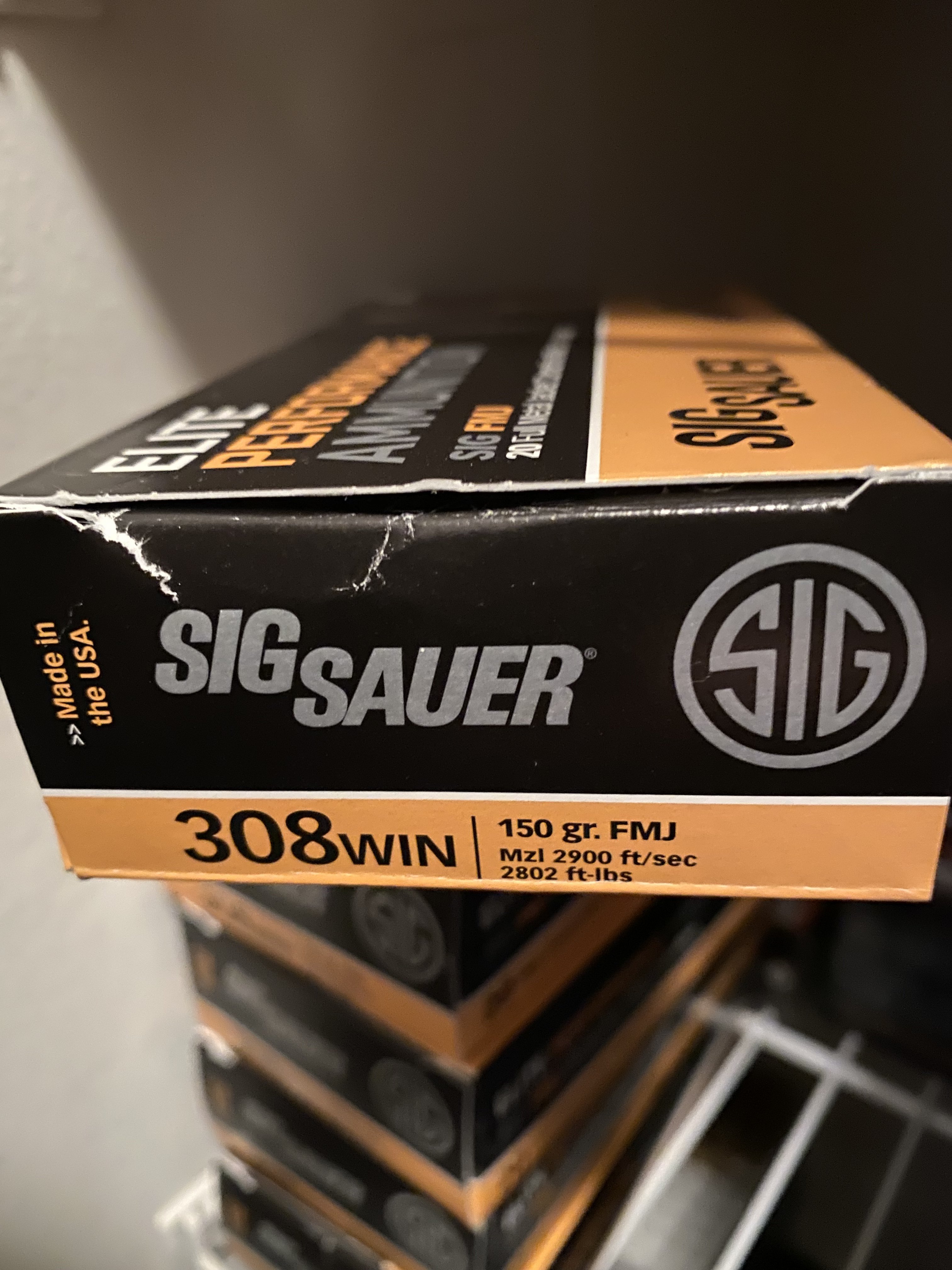

My M1A likes Sig Sauer.
Shoots lights out no issues
