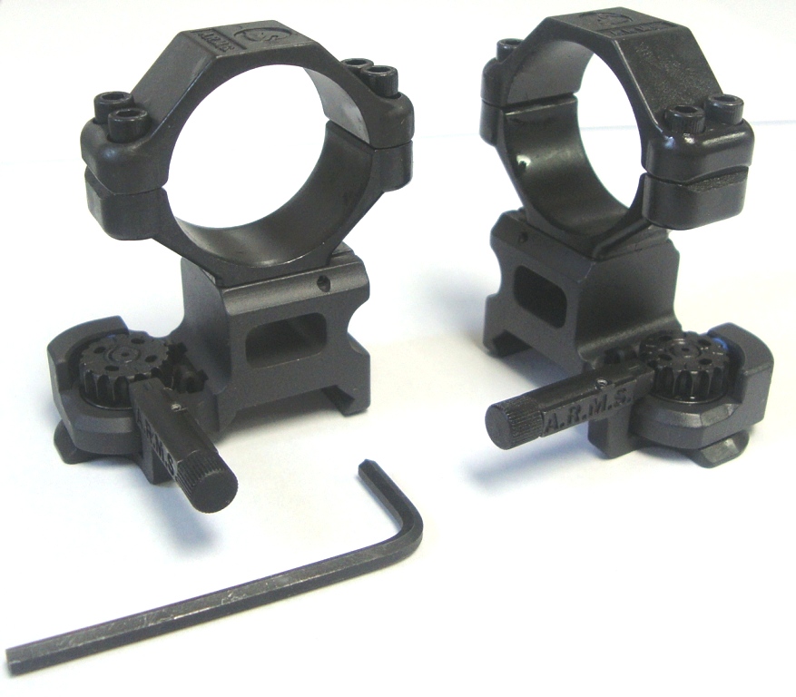

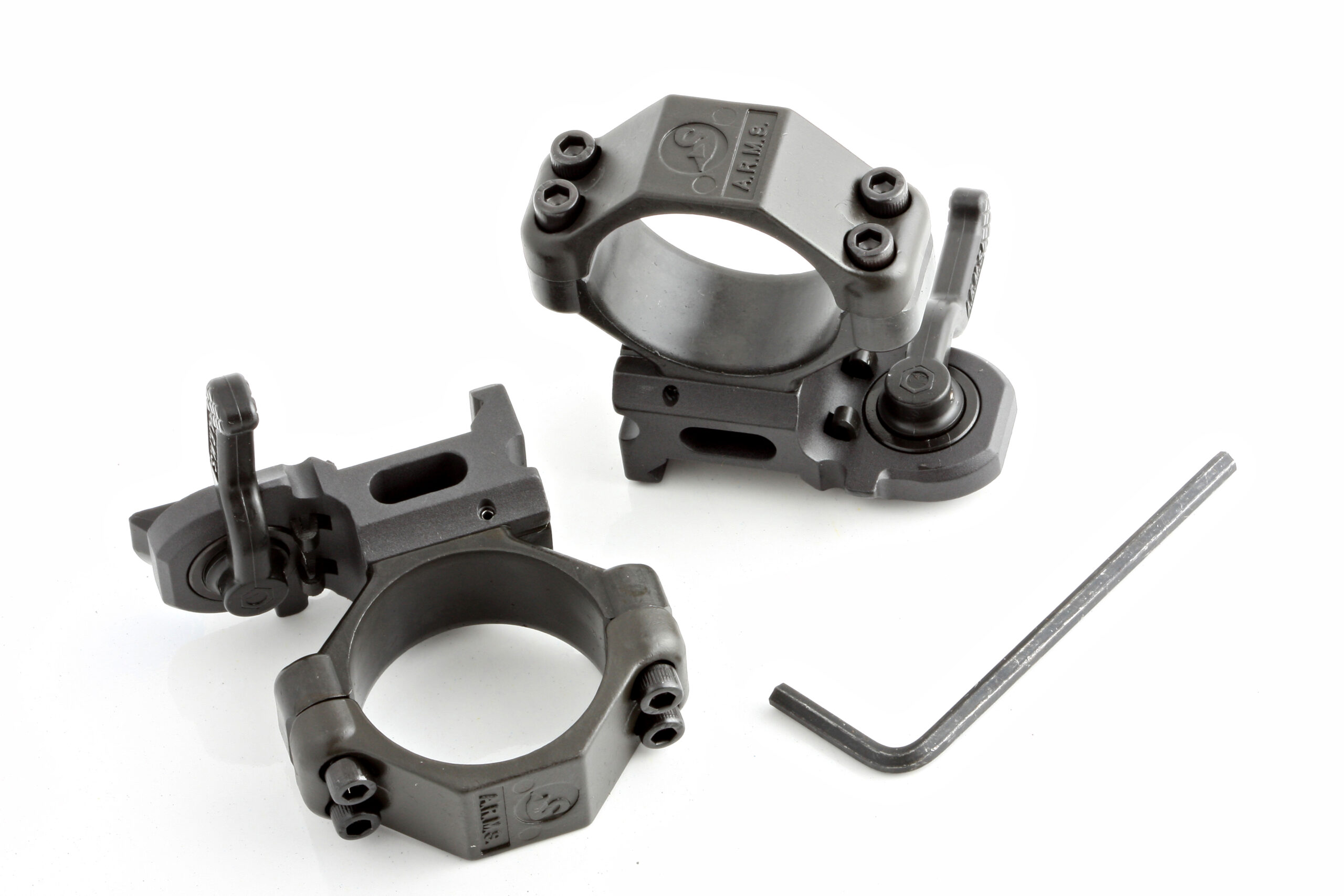

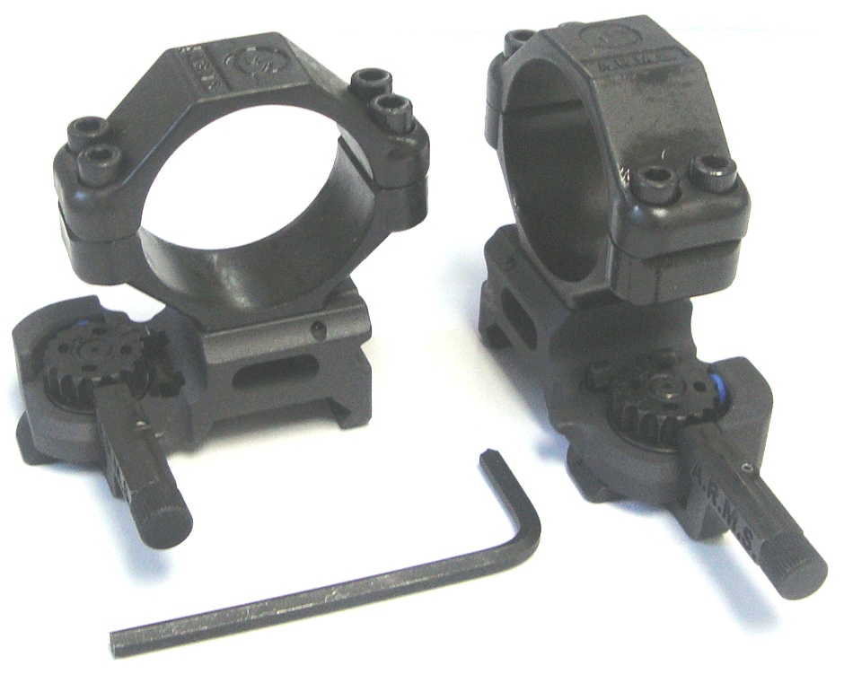

For a scope with that size of objective the ARMS #22 QD rings are offerred in varied heights.
With an ARMS #18 mount call ARMS and ask them which height of their rings would work best. The taller rings have a tunnel bult into the ring support, and the ARMS #18 also has a tunnel along the rail section.
If you want to take the scope off then the ARMS rings (very secure) have a lever that allows you to take the set-up off easily.

The ARMS #22 rings have a lever that cams against the bottom of the rail. Just like the ADM or LaRue mounts do. With a Leupold QD ring on one side of the angled bottom there's a rotating lever that tightens against the rail.

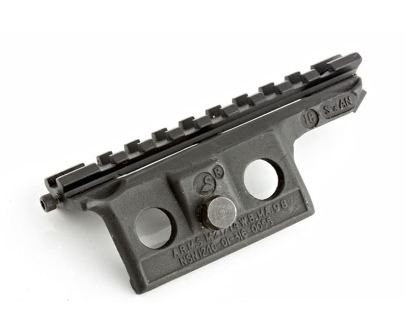

You can see in this pic how the M1A stripper clip ( stripped clip piece removed) dovetail is used buy the ARMS #18. The Sadlack mounts use the same. There's a set screw that angles down into the dovetail to provide extra locking.
You can also see the front set screw that makes contact with the front of the receiver bridge.
This pic doesn't show the side screw installed.

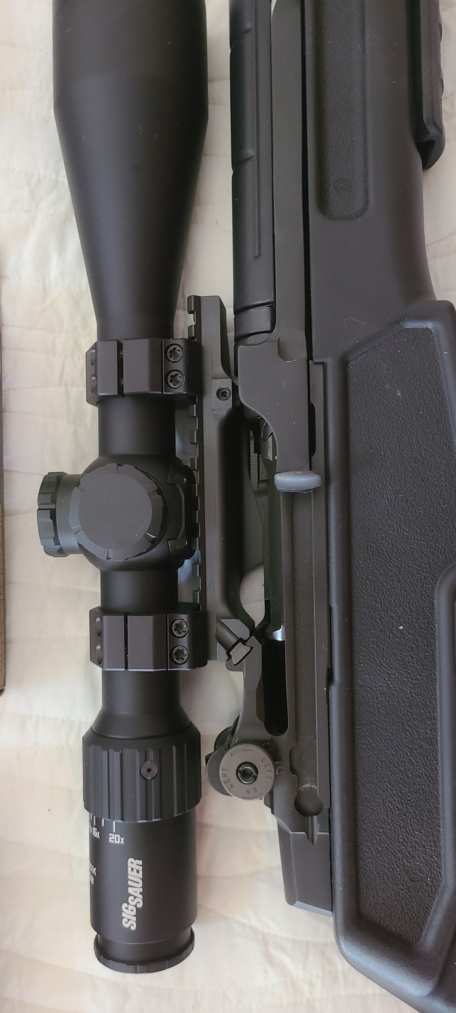

I typically run an ARMS18 mount because it looks like it belongs and does mount an optic as low as it gets. With a 50mm objective, i'm thinking medium height rings and you may need to finesse your variable ring fore/aft to clear the rear peep sight. It'll be close but works out well.
Here's a 4-12x50 on a carbon fiber stock...
